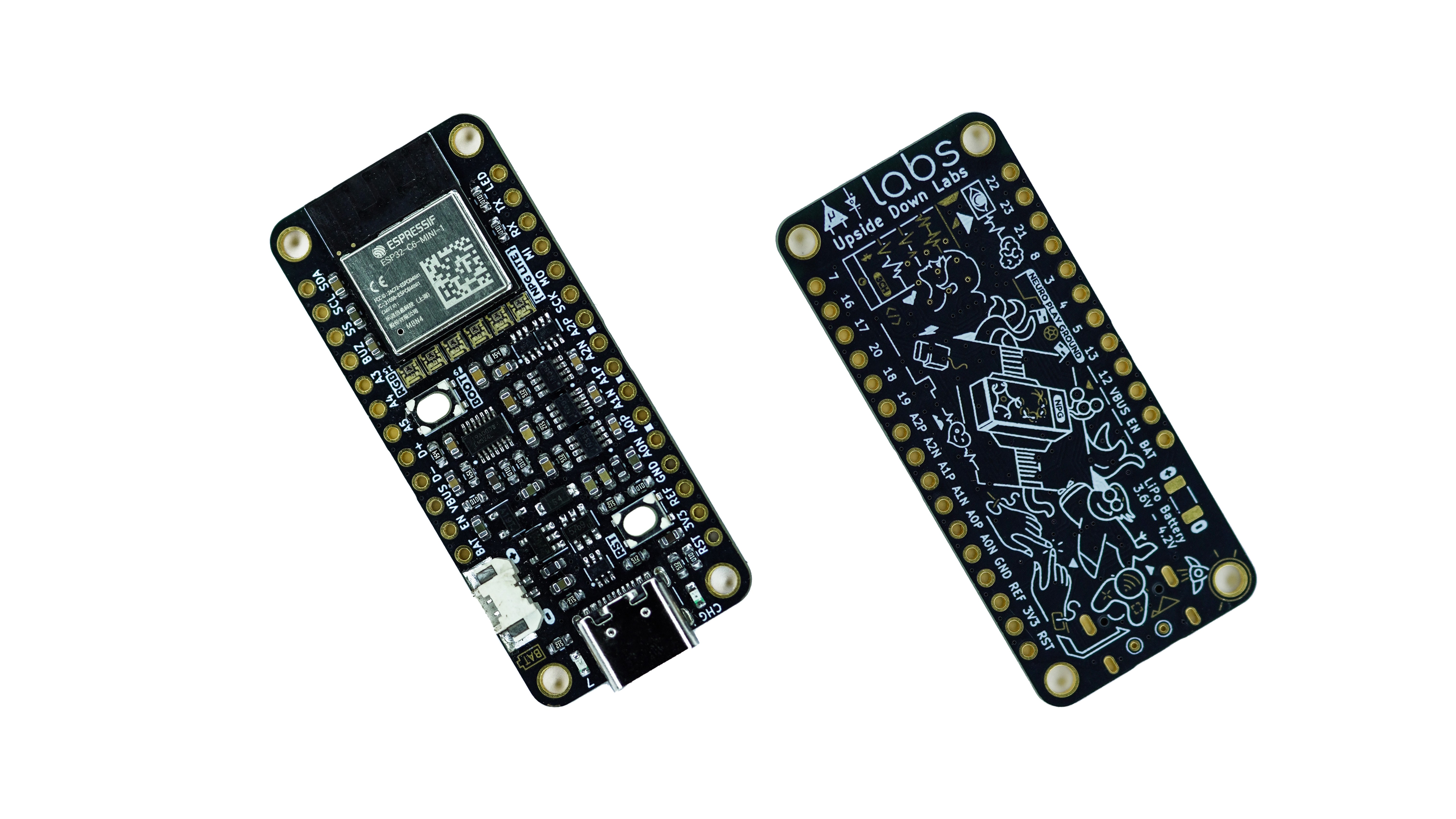

Bio-signal channels3 to 6 channel BioAmp (ECG, EMG, EOG, EEG)
MicrocontrollerESP32-C6 (RISC-V) with 8 MB flash
ADC Resolution12 Bit
Wireless I/OWi-Fi 6, Bluetooth LE 5, Thread, Zigbee
USB & ProgrammingUSB-C for power, charging & programming; UART, JTAG
LEDs6 addressable RGB LEDs, User LED, Charging indicator LED
ButtonsReset button + User/Boot buttons
Power OptionsUSB-C or LiPo battery
Power Regulation600 mA LDO with LiPo battery charging onboard
Battery ConnectorPicoBlade LiPo
Form FactorStandard Adafruit Feather (GPIO, Power, RX/TX pins)
ProtectionOn-board patient & USB ESD protection
Compatible hardwareNPG Playmates & FeatherWing boards

Board Layout & Pinout Diagram

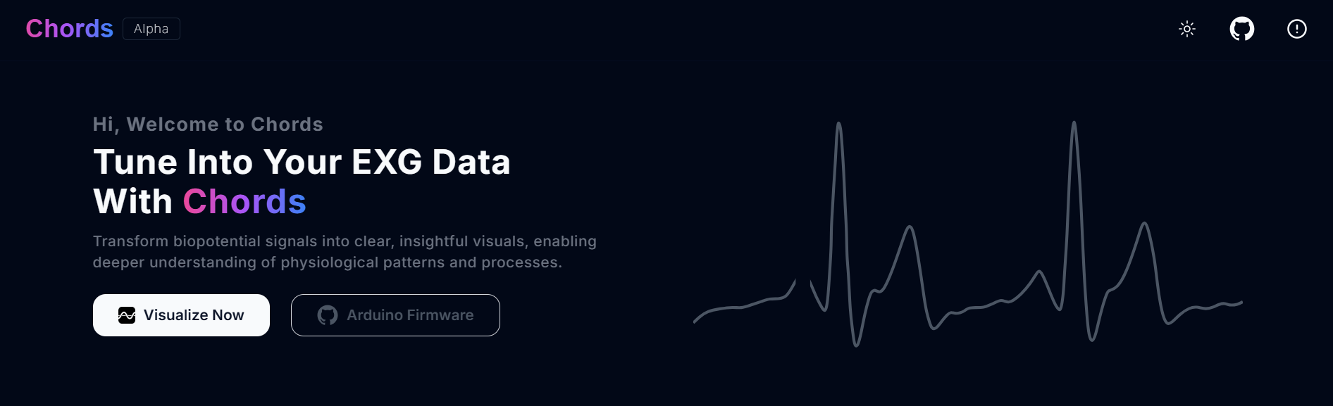

Chords Web

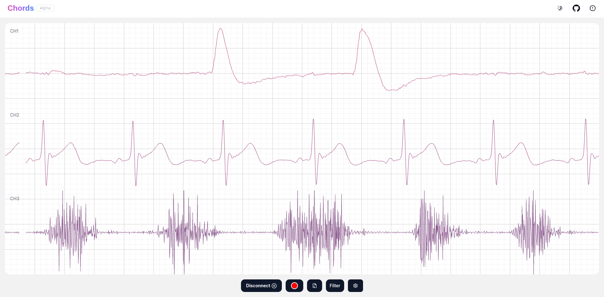

  • Visit Chords Web for real-time biopotential signal visualization (EEG, EMG, ECG, EOG), featuring advanced plotting, filtering, snapshotting and CSV recording.
Chords Web Landing Page
