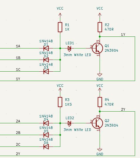

Here are two of the 3-input NAND gates:
There are 3 input diodes, the low-cost and 4nS fast 1N4148.
These are arranged in common anode with the anodes pulled to VCC with a 1K resistor. This is the classic "wired AND", all three inputs need to be at logic 1, or floating, for the common anode node to be high.
The white LED presents a "voltage hurdle" of approximately 2.5V, which needs to be overcome before the transistor will saturate in the on condition.
So the diodes provide the AND function and the transistor inverts this to create NAND.
Additional inputs can be created just by adding more diodes .
I found a 1K input pull-up resistor to work well, but I experimented with 1K to 10K.
I did not get a good response at 10K. The lower gate has a 1K5 pull-up shown, but the boards I assembled settled with a 1K pull-up.
Similarly the collector load resistor, I found 470R to be good. I purchased resistors to try 620R, 750R and 1K.
I didn't manage to duplicate Mats Engstrom's 10K/1K version. (More investigation required).
The NPN transistor can be either a 2N3904 or BC547C. These have a complementary pin-out, CBE versus EBC. So the BC547s should be inserted "backwards" into the pcb. There are also 2 variants of the lead spacing, either 1.27mm or 2.54mm. The pcb accepts both variants.
