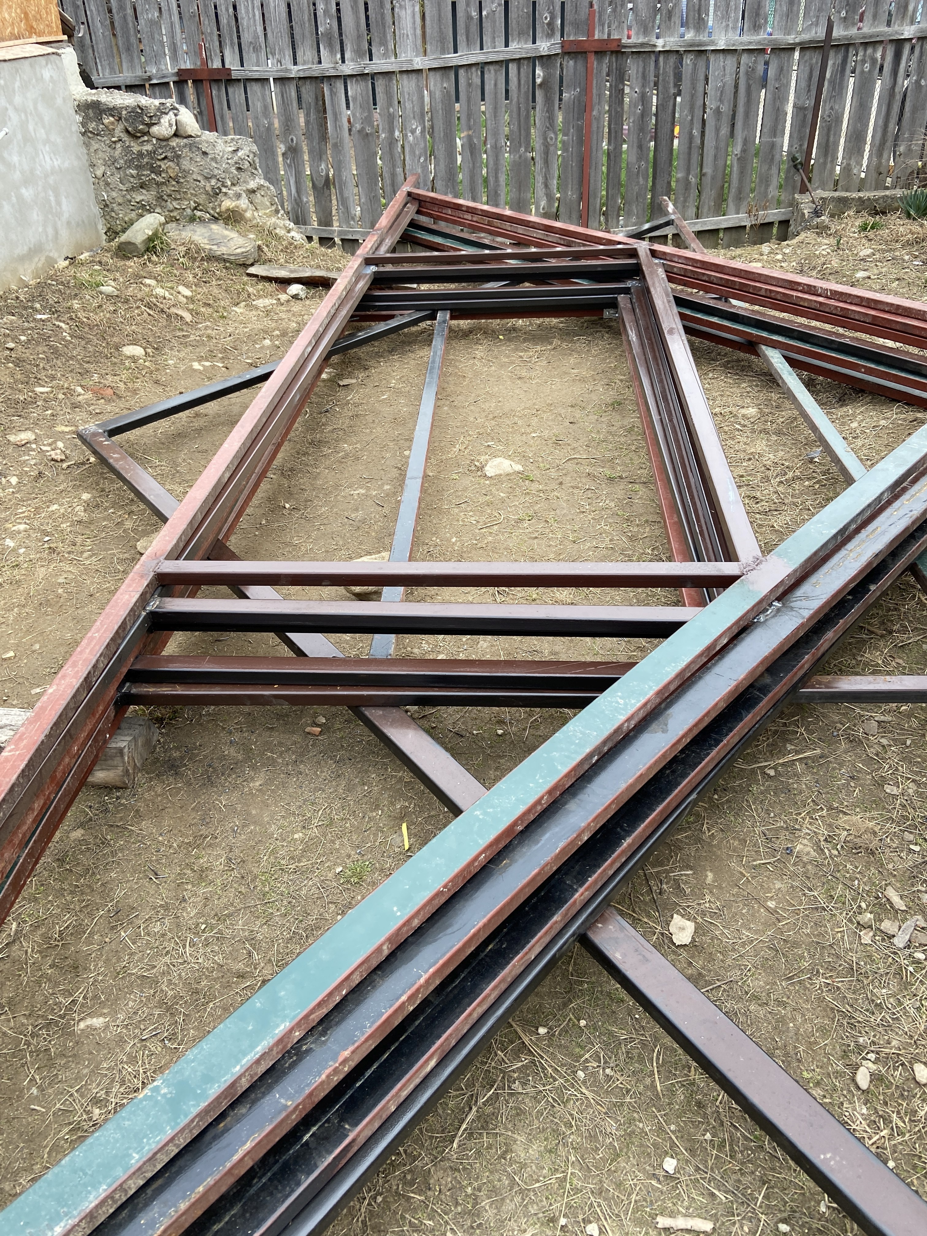

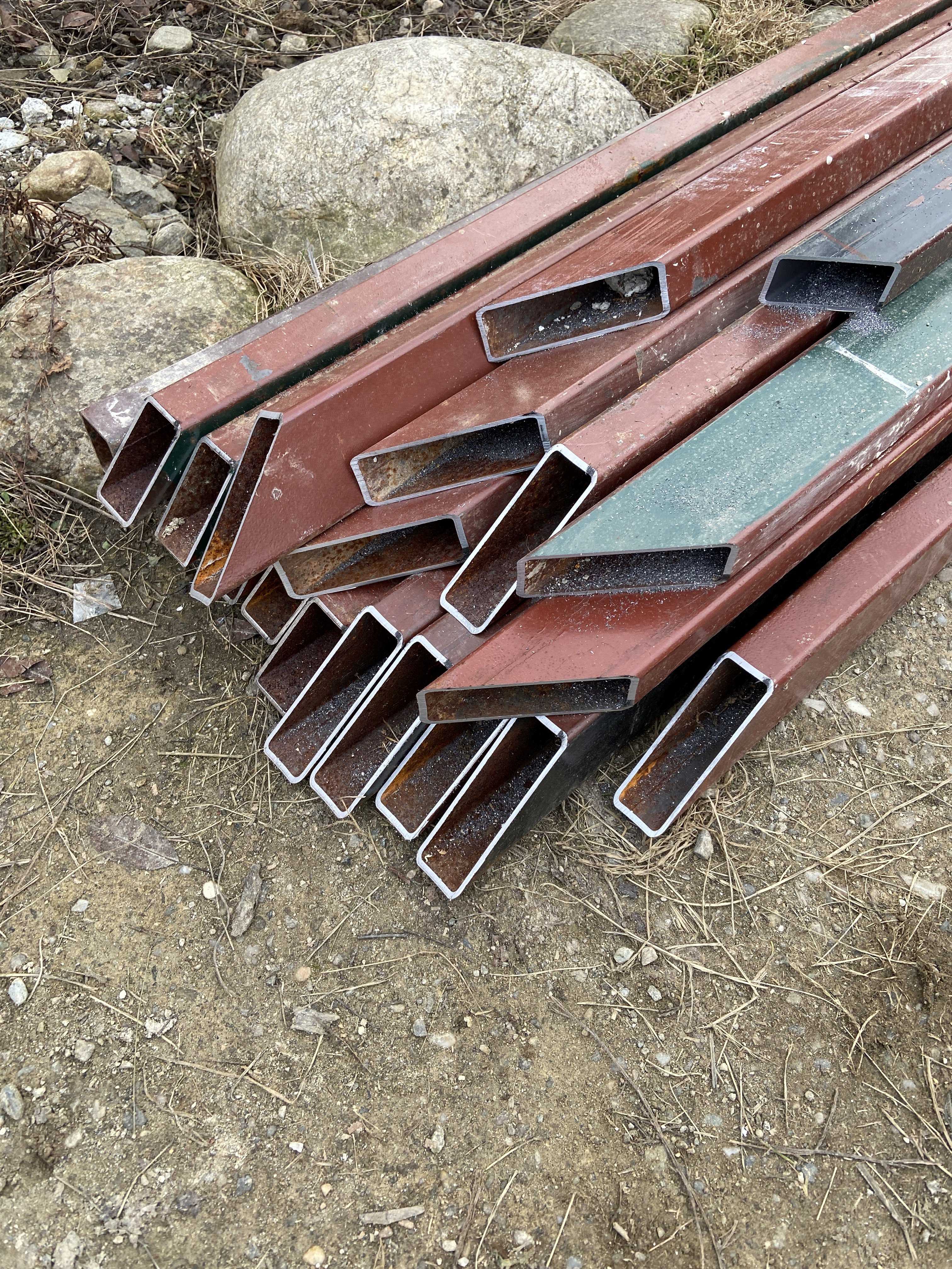

I made the roof structure of iron. I tried to avoid wood as much as possible. Trees have a much more important function than being used in construction: to produce clean air! I did use wood for the laces under the tiles, for the support of the plant gutters, and on the front side (OSB).
Initially, I intended to build everything in Lego style, without welding, only by mechanical fastening. The beams, rafters, etc. should have been connected only by screws. I built 2 trusses in this way, but then I gave up because the iron at that length (7m) was deforming and the components were no longer joining properly.
The trusses (queen type) are built from an 80x40x3 profile, but with a 60x40x3 base and interior elements. One truss weighs approximately 100 kg. I used 13 supports along the entire length of the house.
