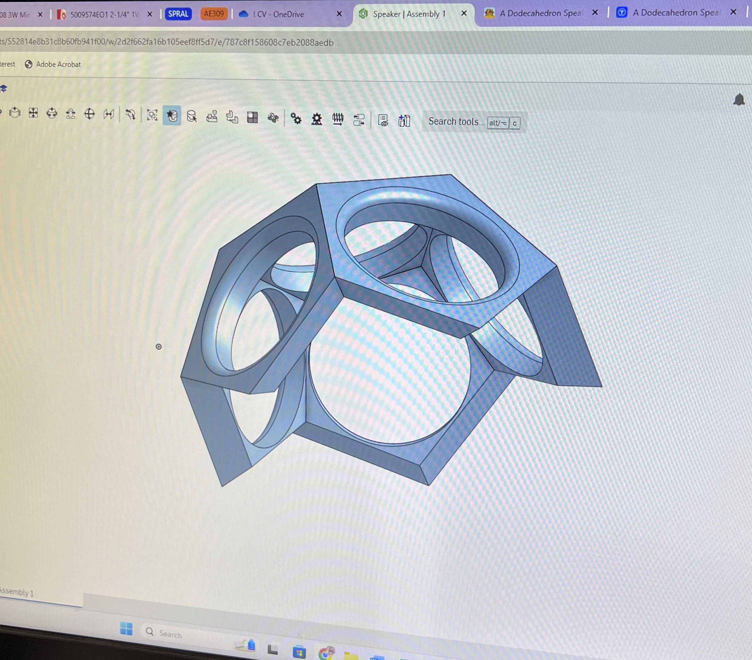

I wanted to make sure that all the students, including those with ZERO experience with CAD, learned the basic tools so that they can continue using CAD to prototype things for other projects as well. Thus, instead of giving vague design conditions, I had built a CAD model that I know works, and walked through it step by step. The PowerPoint presentation can be found in Files, along with the .STL model of both the single and 6-sided faces of the speaker. i also let the students choose to make design choices if they're comfortable with CAD. i did have one of the students who participated tell me that he was able to use OnShape for his research thanks to my workshop, so goal achieved! For those who want to add a bit more of a challenge, you can vaguely give design considerations, and have a competition to see who can design the most efficient, smooth, pretty etc. functioning speaker casing.

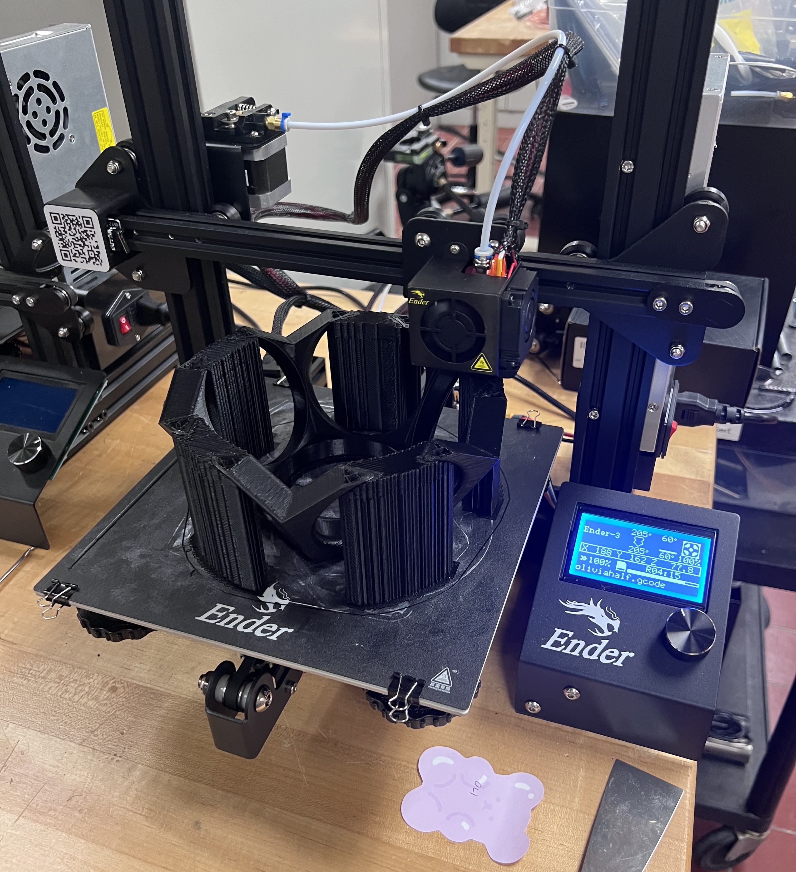

Then, I was in 3D-printing jail. I decided to print all of the faces for all participants, as we had limited resources. I have over 5 years of working with 3D Printers while serving as the MakerSpace TA and the STEM Outreach TA at the Cooper Union, where I got my bachelor's and master's in mechanical engineering, so i felt comfortable printing all the parts. Again, this part can be modified so that student learn the basics and good practices of 3D printing!

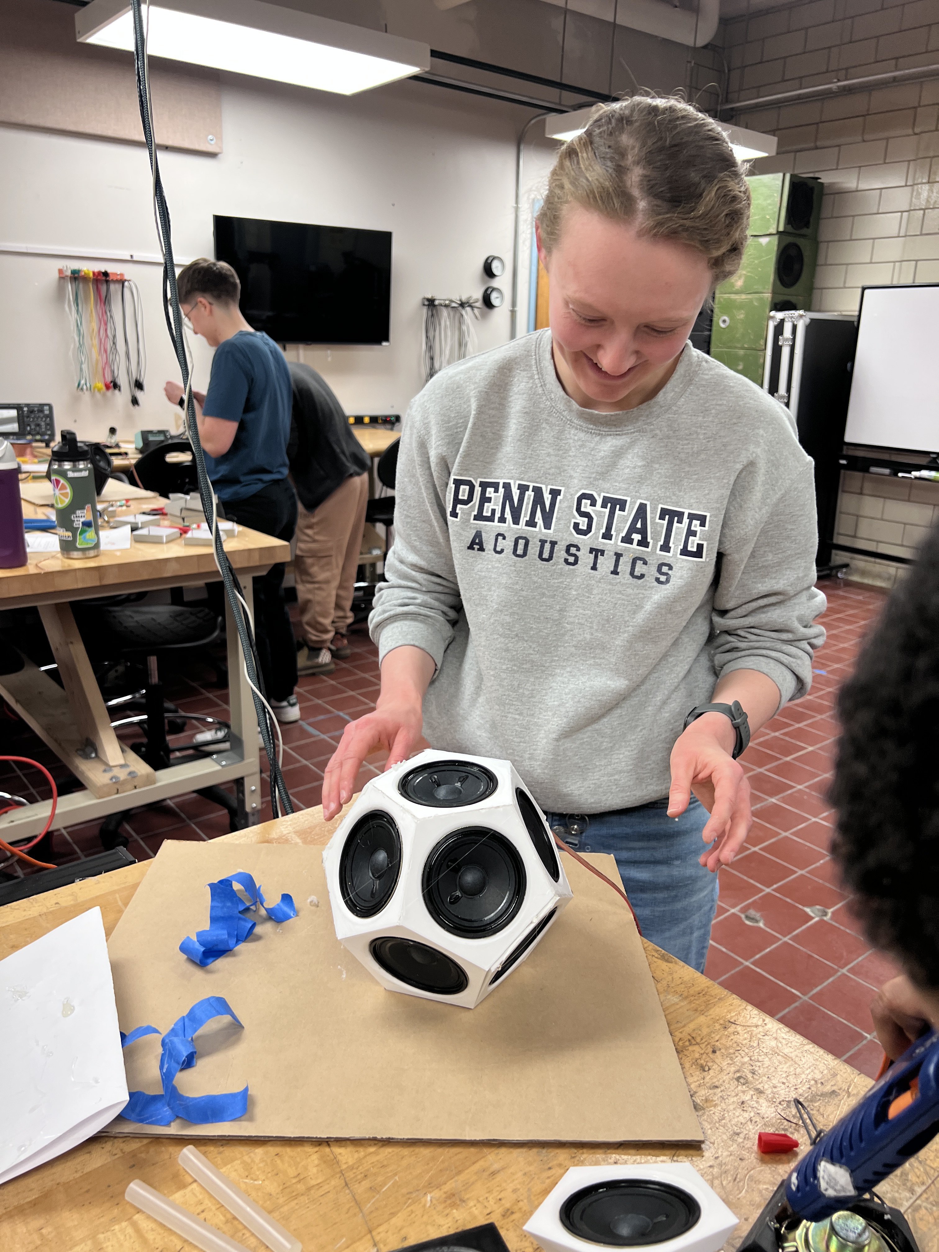

We had 15 students participate, again with varying background knowledge and skills. Everyone was able to either take a fully functioning dodec speakers home, or took almost-finished dodec speakers home!
happy happy faces of dodec speaker owners

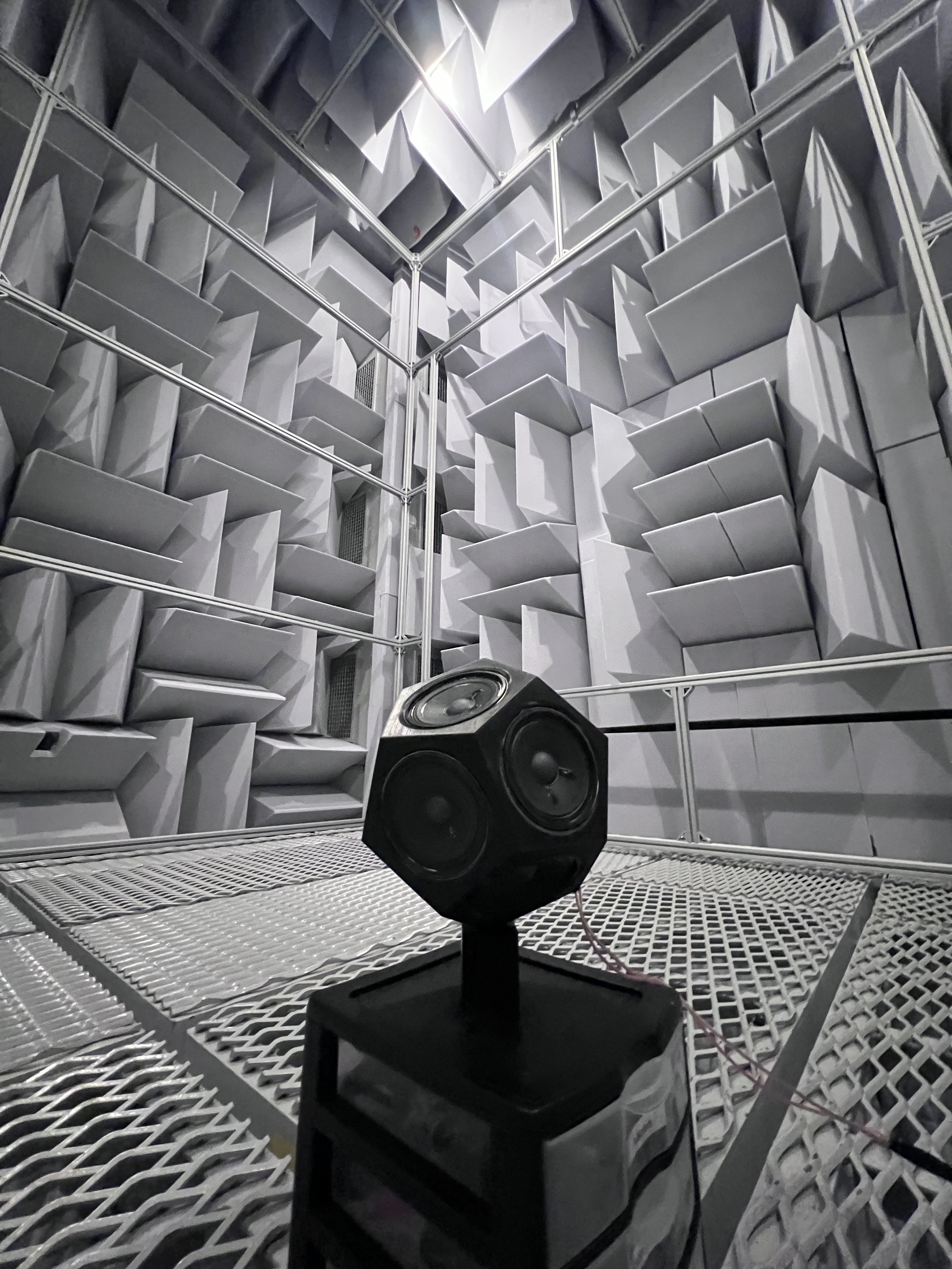

I took my dodec and played logarithmic sine sweeps in the anechoic chamber and the reverberation chamber. You can find videos of these below. What's cool about this project is that again you don't have to stop at just the build, but expand the workshop so that students learn how to take measurements, to process their data with signal processing, and to analyze the speaker's performance and compare how they behave in the anechoic chamber and the reverberation chamber!

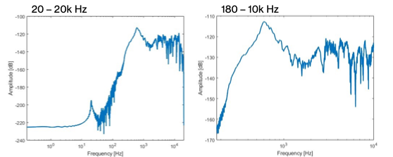

Frequency response functions of the dodec speaker measured in the anechoic chamber with laptop microphones. Not bad !!! pretty flat and nice for the target frequencies.

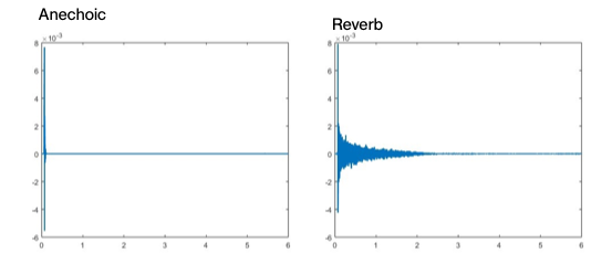

Comparison between the anechoic and reverberant chamber, through impulse response measurements! Again, with laptop microphones - not bad!
