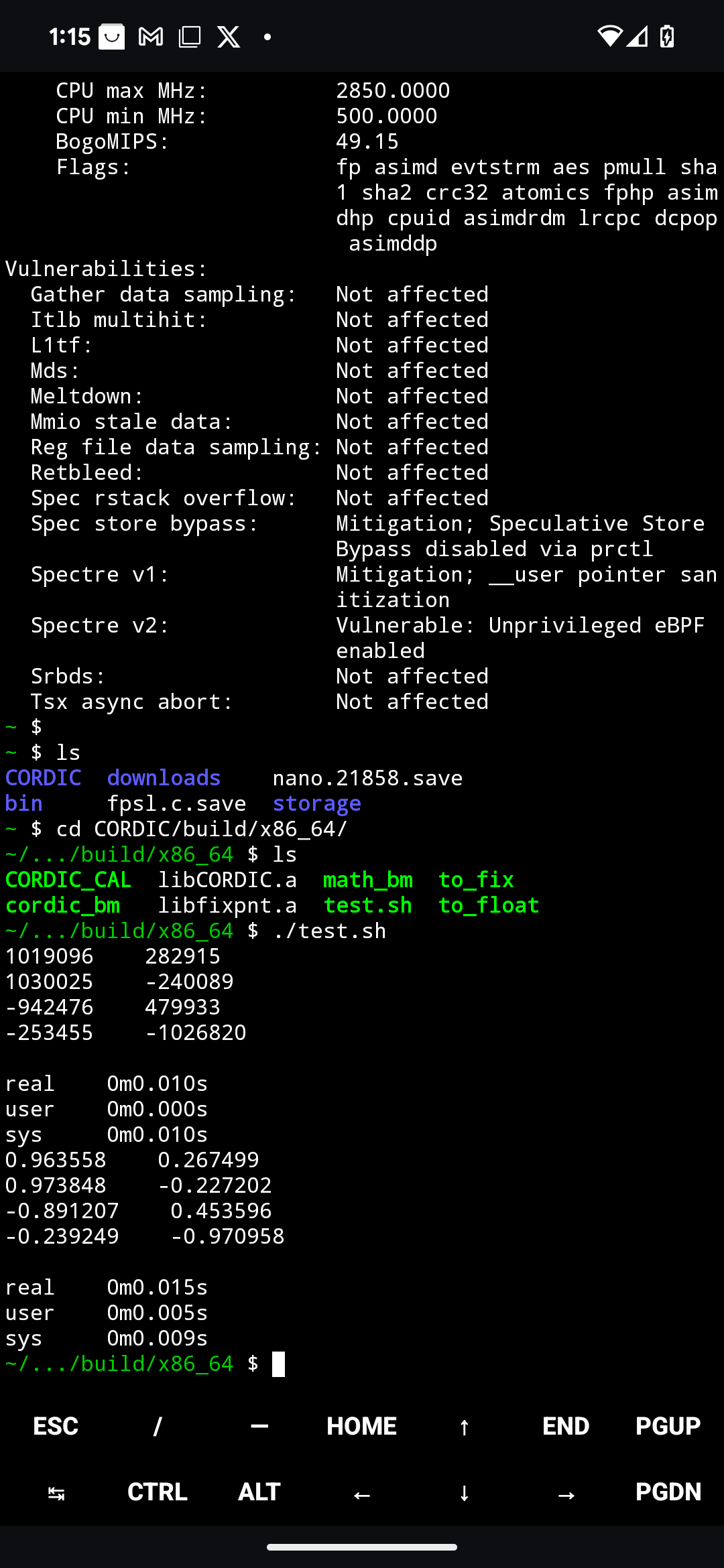

  • STILL PRETTY GOOD ARM CORTEX A78
    EARL T09/30/2025 at 17:21 0 comments
    There is the results from my phone and the output from lscpu Slower but still neck and neck I'm going to work on log /exp and acos when I get a chance I'm in the middle of moving right now.
