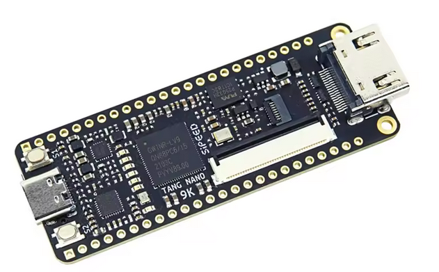

I’ll use a Tang Nano 9K (GW1N-9) FPGA to wire up the RNS logic.
It will work alongside an ESP32-S3 that handles I/O and orchestration.
Why this setup? Because it's cheap, well-documented, and popular in the maker community. And because I know almost nothing about FPGA for now, so I’m learning as I go. The goal is to implement an RNS-based FIR filter on this combo.
