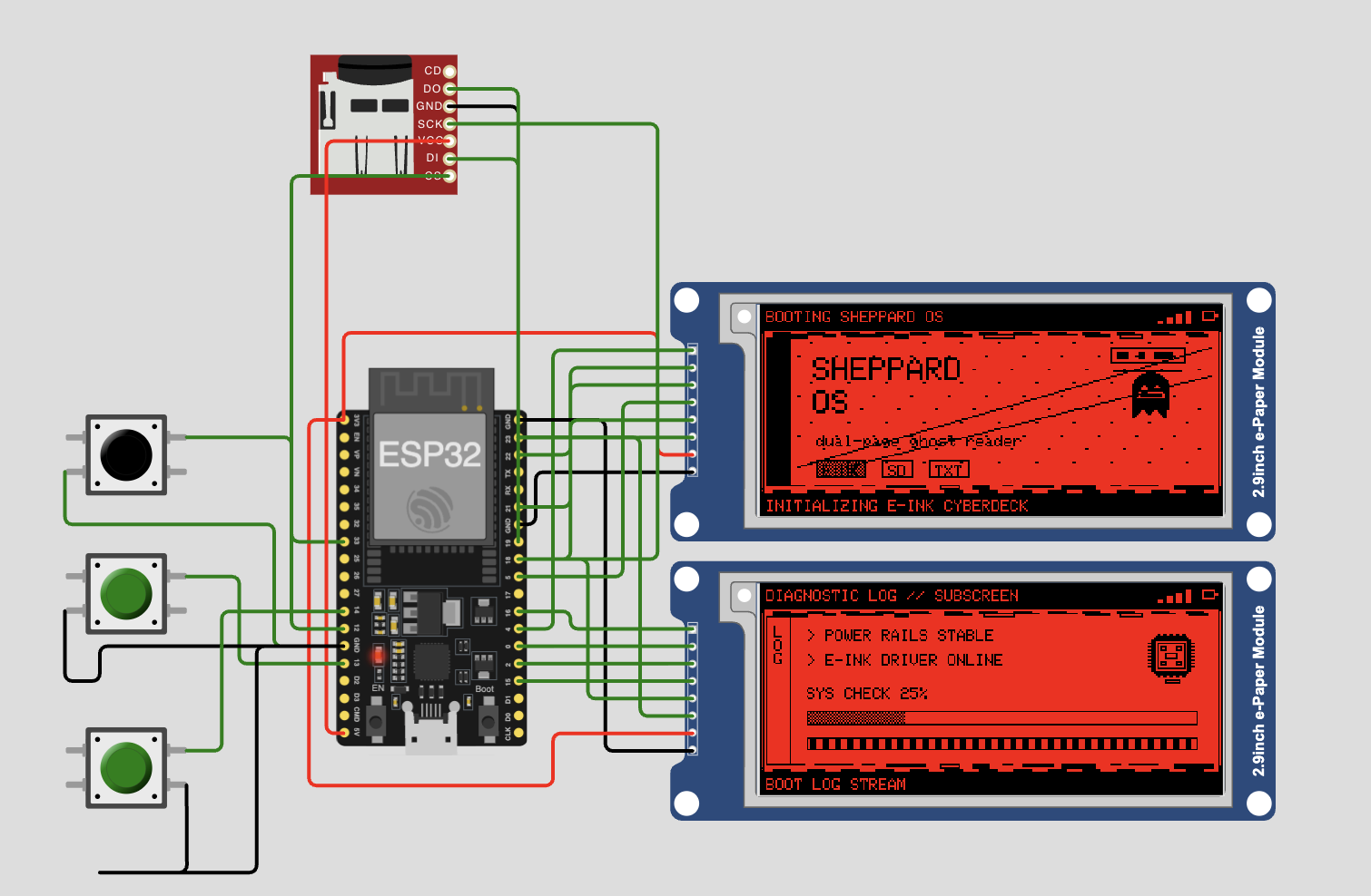

    Before committing to the custom round PCBs, the entire UI was built and tested in simulation first — two virtual e-paper displays, button navigation, page-turn logic, and even a fake boot sequence, all running on a simulated ESP32. This let the software architecture get worked out before any board space or fabrication cost was on the line.
    From there, the project moved to a breadboard prototype: a standard ESP32 dev board wired to two physical e-paper displays, used purely to validate that the real hardware could do what the simulation promised.
    ## Key challenge: driving two e-paper displays from one ESP32
    Both displays share the same SPI bus, which meant getting independent chip-select (CS) lines right for each panel was critical — without careful CS management, the two displays would contend for the bus and fail to update reliably. Getting the timing and wiring dialed in took a fair amount of trial and error, but once solved, it unlocked reliable independent updates on both screens simultaneously.
    With that working, the rest of the UI — file index, home screen, page rendering — came together quickly on the breadboard setup.
    ## Milestone: first real hardware boot
    Seeing "SHELL:READER" actually render on physical e-ink for the first time — after weeks of only seeing it in simulation — confirmed the core software and multi-display driving approach both work as designed.

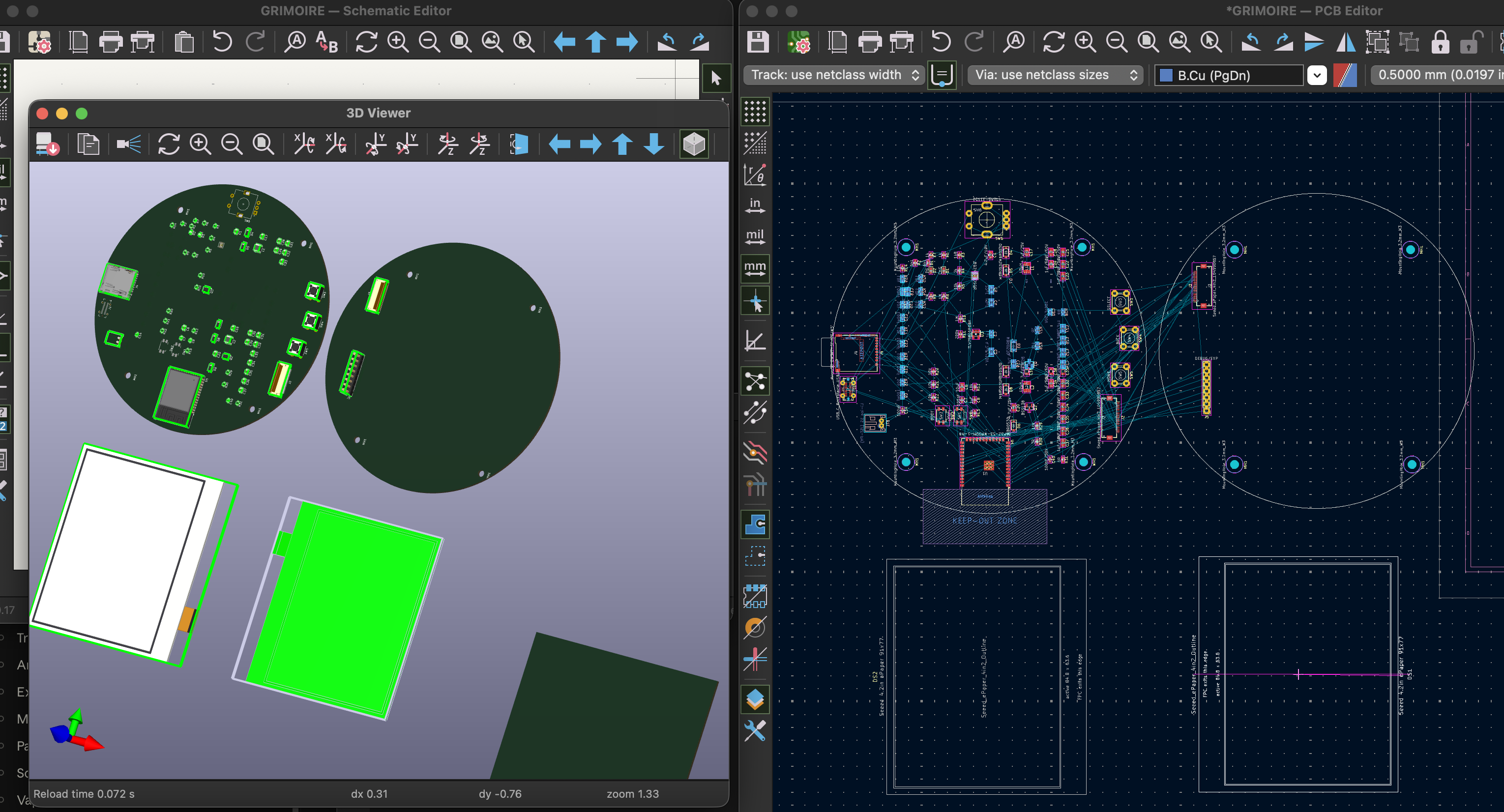

    **Next step:** the custom round PCBs are heading to fabrication now that the software and dual-display approach are validated on standard hardware. Big thanks to [PCBWay](https://www.pcbway.com) for sponsoring fabrication on this one — odd-shaped, round boards aren't trivial to produce, and having a manufacturing partner who can actually turn them around has been key to getting this off of a breadboard and into real hardware.
