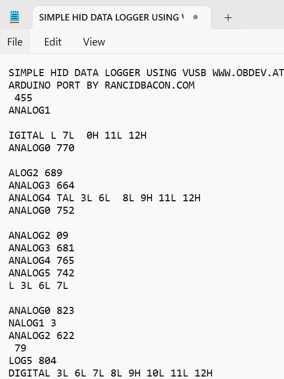

I opened Notepad, plugged in the V-USB Arduino device, and after a few seconds the P&P system enumerated as a USB 1.1 keyboard device. I was pretty amazed but there were errors in the data which did garble the notepad text. Still, it partially worked after 12+ years.
Moving the V-USB device over to my MS Surface Pro 4 running Win-11 24H2, the enumeration went well and the data stream into Notepad was error free! Both of these Windows machines are old units living out their second lives here with this old man, so I am not going to suggest why one worked and one half-worked.
