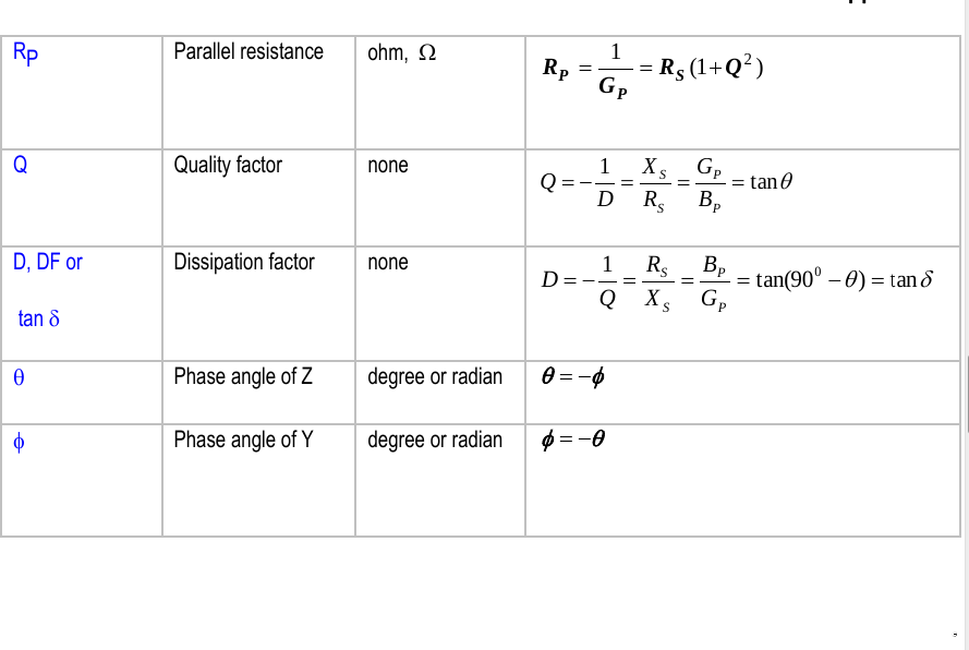

- Impedance Measurement Range: 1mΩ to 10MΩ Measurable parameters include: battery internal resistance, series capacitance, series inductance, series resistance, series reactance, D-value, Q-value, phase angle, and impedance magnitude.

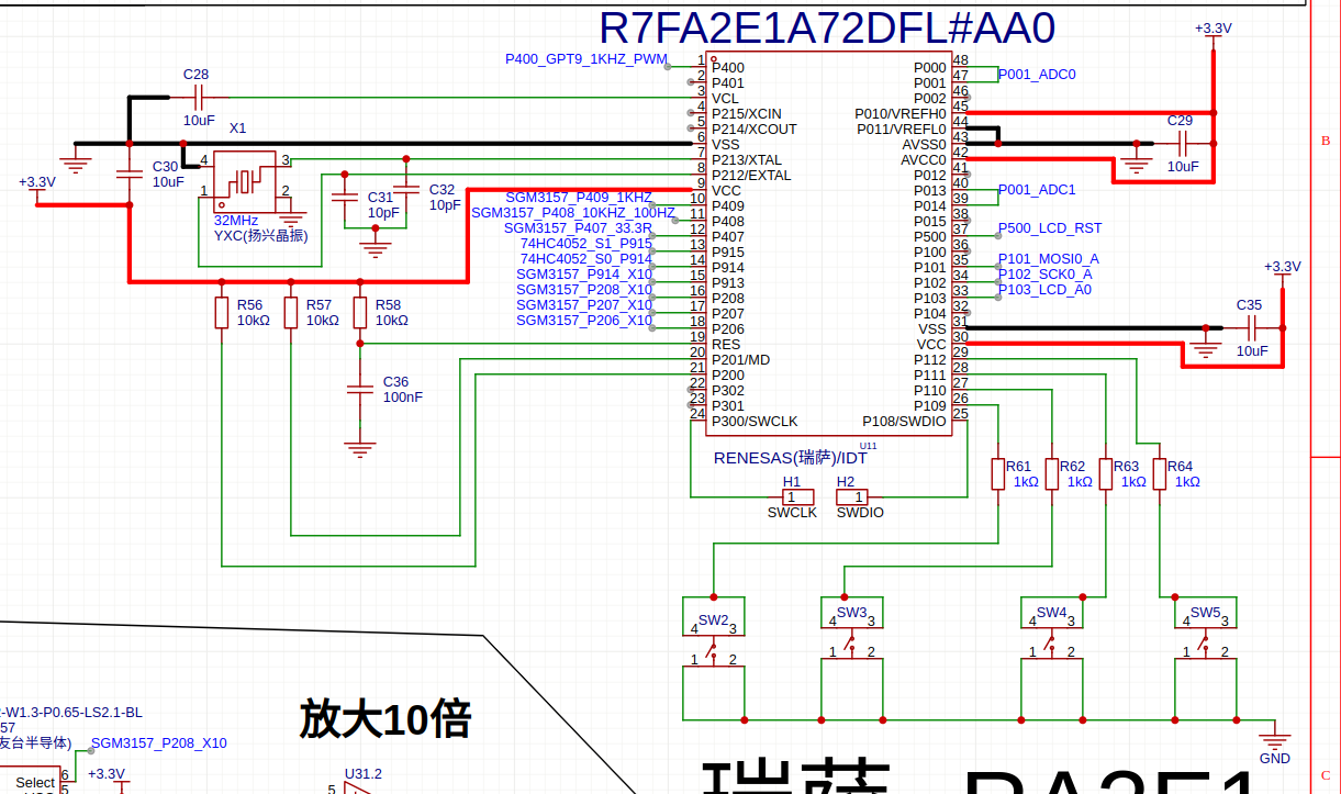

The Renesas R7FA2E1A7 MCU is used as the main controller, with a 32MHz crystal oscillator. Although the maximum frequency specified in the datasheet is 20MHz, an overclocking operation was performed to verify the idea of using 4 ADC ports for sampling. The sampling rate is 50KHz, and all collected data need to undergo DFT operations, resulting in a relatively large computational load. The DFT calculation frequency is around 70K, which just allows interrupts to be generated, hence the overclocking.
Pin functions:
- P400 outputs PWM. P409 and P408 switch the PWM filter circuit through an analog switch to serve as the excitation source.
- P407 is the 33.3Ω gear switch analog switch. Since the on-resistance of the 74HC4052 analog switch is relatively large, which cannot meet the requirements of the lowest gear, a 3157 analog switch is connected in parallel in the 33.3Ω gear to reduce the on-resistance.
- P915 and P914 are the control ports for the 74HC4052 gear switch, used to switch resistors of different gears.
- P206 and P207 are the gain switches for the measured components, each providing a 10x gain.
- P208 and P914 are the gain switches for the sampling resistors in the internal V/I circuit, each also providing a 10x gain.
- P300 and P108 are SWD ports. The JLINK V9 needs to be connected with 4 wires: 3.3V, GND, SWDIO, and SWCLK.
- P000 and P001 are the resistance sampling ports of the V/I circuit. P013 and P014 are the sampling ports for the measured components, using dual-port acquisition to verify the idea of improving resolution.
- The ADC directly uses AVCC and AVSS as references and is directly connected to the digital power supply of the MCU, which may increase ADC reading fluctuations.

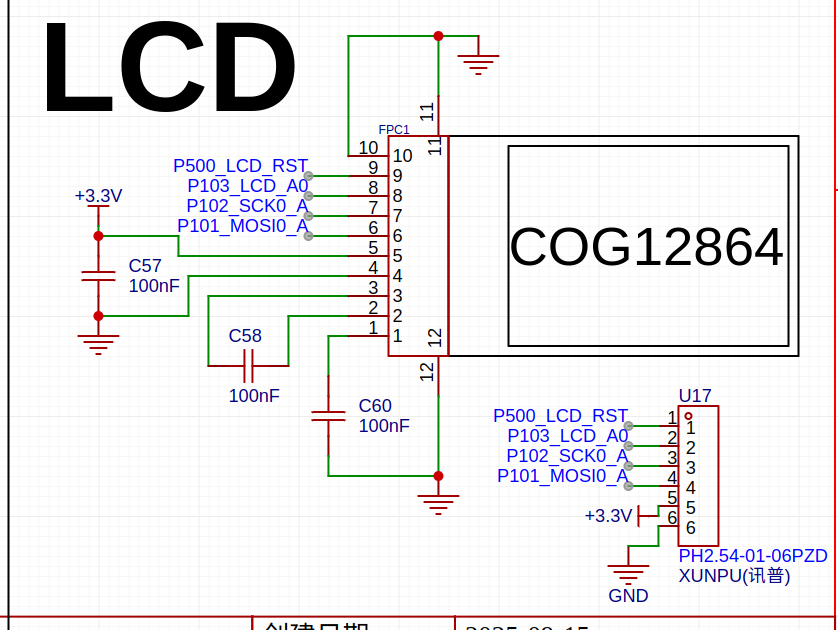

- P500, P101, P102, and P103 are LCD driving ports.
- P109, P110, P111, and P112 are four buttons.

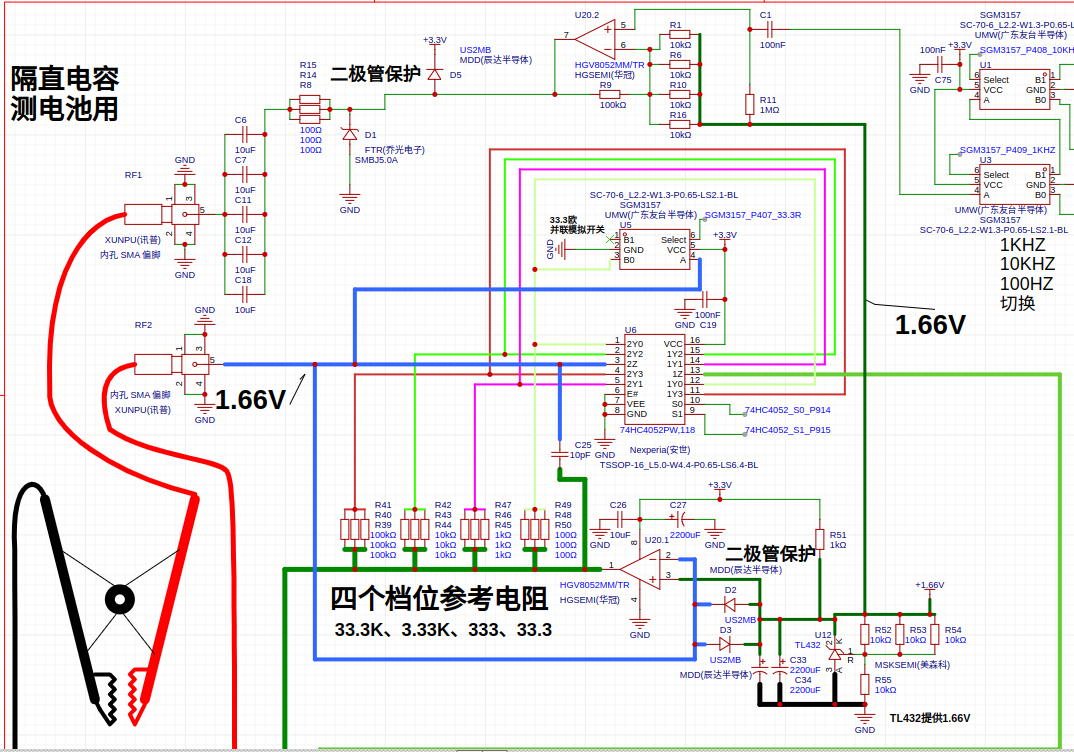

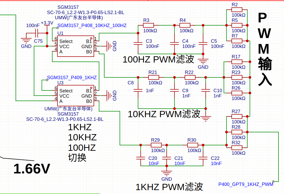

The PWM filter circuit directly adopts RC filtering, which converts the PWM signal into a sine wave after RC processing—this design simplifies the MCU programming complexity. Two 3157 analog switches are used to switch between three sets of RC filters, which serve as the excitation source.
However, the RC filter circuit has a relatively large component attenuation. This significant attenuation leads to a weak output signal, making it more susceptible to interference. Additionally, the weak signal requires high-gain amplification in the subsequent stage, which results in relatively large temperature drift. That said, due to the adoption of dual-channel acquisition in the system, the temperature drift actually has little impact on the final measurement reading.

After RC filtering, the signal is passed through capacitor C1 for DC blocking and then shifted up by 1.66V before entering pin 2 of operational amplifier U20 for high-gain amplification. A lower amplification factor here would cause high-frequency oscillation. The output of the op-amp is fed to RF1 via a 33.3Ω resistor and a 50μF capacitor, with D1 and D5 providing protection.
RF1 and RF2 are connected to Kelvin clips to conduct current. The inverting amplification of U20 (pin 1) uses a 74HC4052 to switch between four gain levels corresponding to resistances: 33.3Ω, 333Ω, 3.33kΩ, and 33.3kΩ. For the lowest resistance level, since the 74HC4052 has a high on-resistance, a 3157 analog switch is connected in parallel to reduce the resistance.
A TL432 provides a 1.66V reference ground voltage, and together with D2, D3, C33, and C34, forms an input protection circuit. The four range resistors also adopt a four-wire measurement method. Conveniently, the 74HC4052 has two sets of switches to support this configuration. This part of the circuit references open-source bridge designs.

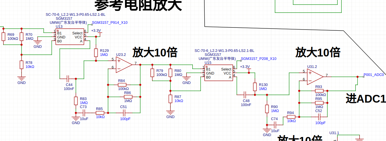

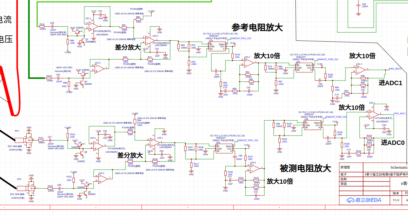

The following is a dual-channel amplification circuit, which separately amplifies the voltages across the measured resistor and the range-switching resistor. Each channel is set with two amplification factors, forming two amplification gears: 10x and 100x.
However, the impact of temperature drift on the readings of the dual-channel amplification is relatively obvious. When measuring the same resistor at different times, the deviation is quite large, which is less stable than switching back and forth with a single channel.

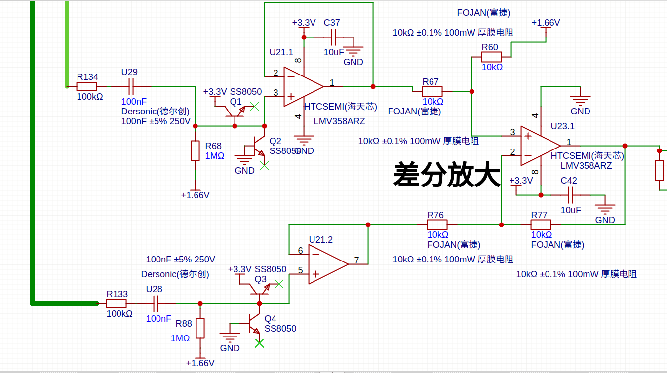

The voltage across the reference resistor or the measured resistor is first passed through a 100KΩ resistor and a 100nF capacitor for DC blocking. It is then shifted up by 1.66V via a 1MΩ resistor. An SS8050 transistor is used instead of a diode for protection to prevent damage to the operational amplifier. The processed signal enters the operational amplifier for follower output, followed by differential amplification through U23.1.
The LCD display still uses the previously purchased COG12865, with the ST7567 as the main controller. These were second-hand units bought for around 1 RMB each at the time, and they are no longer available now. To facilitate replication by other enthusiasts, pin headers for the LCD driver interface have been reserved, making it easy to design an adapter board.

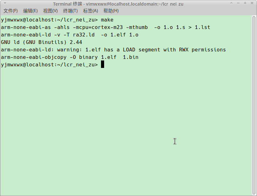

The source code and firmware are in their respective folders: 1.S is the source code, and 1.bin is the pre-compiled firmware.
To save the software project locally, use: `git clone git@gitee.com:yjmwxwx1/R7FA2E1A7.git`
Bug reports are welcome. Any provided bugs will be addressed and fixed with updates.
The compiler can be downloaded from the official ARM website: https://developer.arm.com/downloads/-/arm-gnu-toolchain-downloads
Alternatively, you can download GNU binutils and compile it yourself.
Simply enter `make` to compile the firmware.

Upon entering the ADC interrupt, DFT (Discrete Fourier Transform) calculations are performed to obtain the real and imaginary parts of both the measured resistor and the reference resistor. The impedance is then calculated using these four parameters through the following method:
### Impedance Calculation Method A detailed introduction to the CORDIC algorithm can be downloaded in the attachment.
1. The upper arm (real and imaginary parts) and lower arm (real and imaginary parts) are each rotated to 0 degrees using the CORDIC algorithm, with the rotation angles recorded simultaneously. 2. Subtract the lower arm angle from the upper arm angle; the angle difference represents the impedance phase angle of the measured component. Adjustments are needed if the difference exceeds 180 degrees. 3. Since the signal is rotated to 0 degrees, the magnitude of the impedance is directly calculated by multiplying the real part of the upper arm by the resistance value of the lower arm’s reference resistor, then dividing by the real part of the lower arm. 4. Calculate the cosine and sine values corresponding to the angle difference. 5. Multiply the impedance magnitude by the calculated cosine and sine values to obtain the series resistance and reactance.

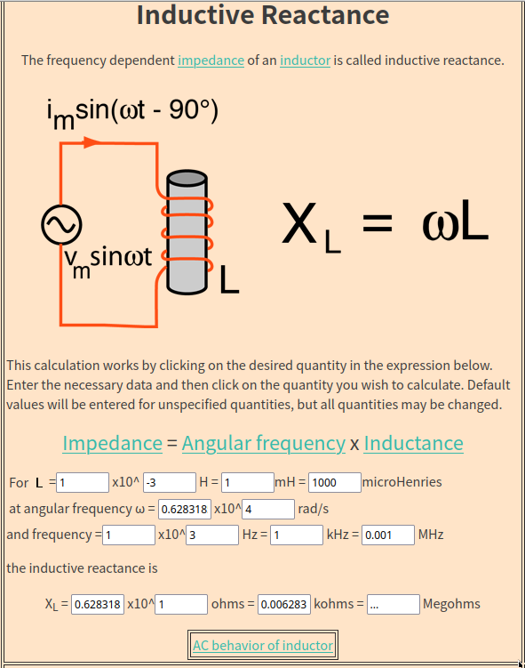

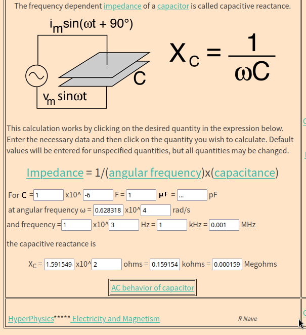

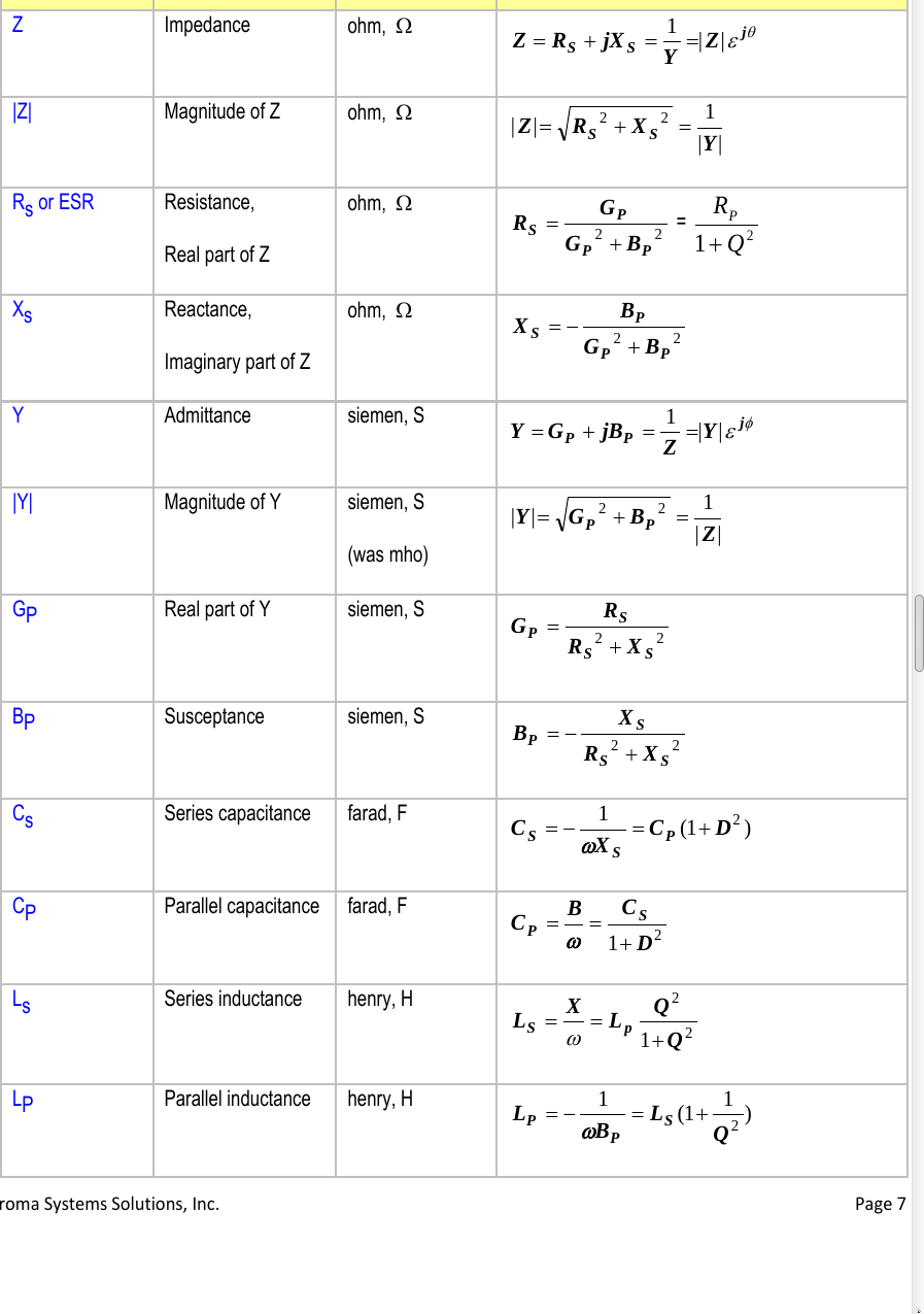

### Capacitance and Inductance Calculation Method An online version of the program is available for mutual conversion between different parameters, which is suitable for verifying the performance of the self-made LCR meter. Refer to the attachment for the file.

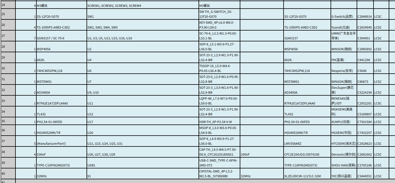

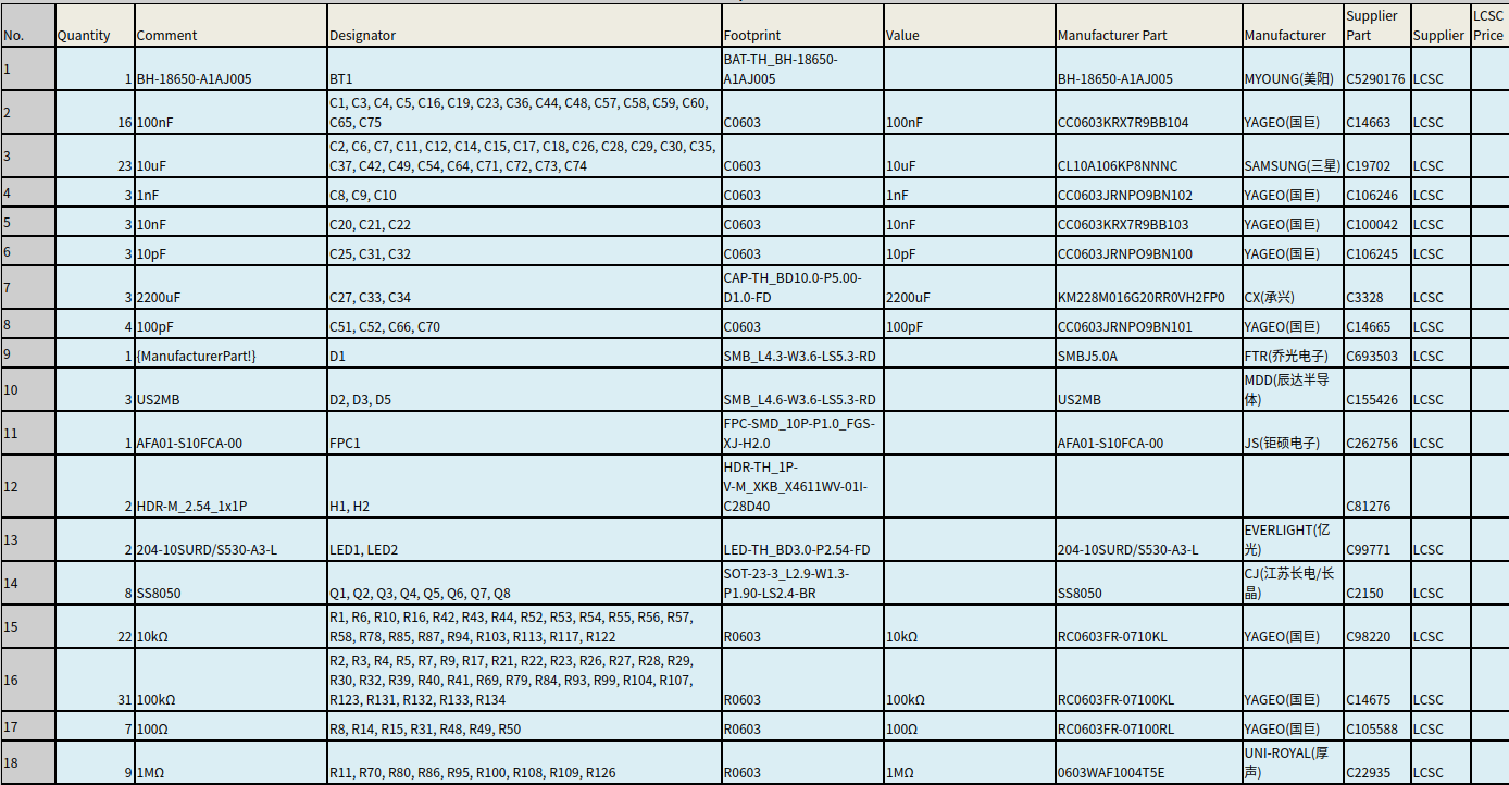

## 6. BOM List
yjmwxwx
