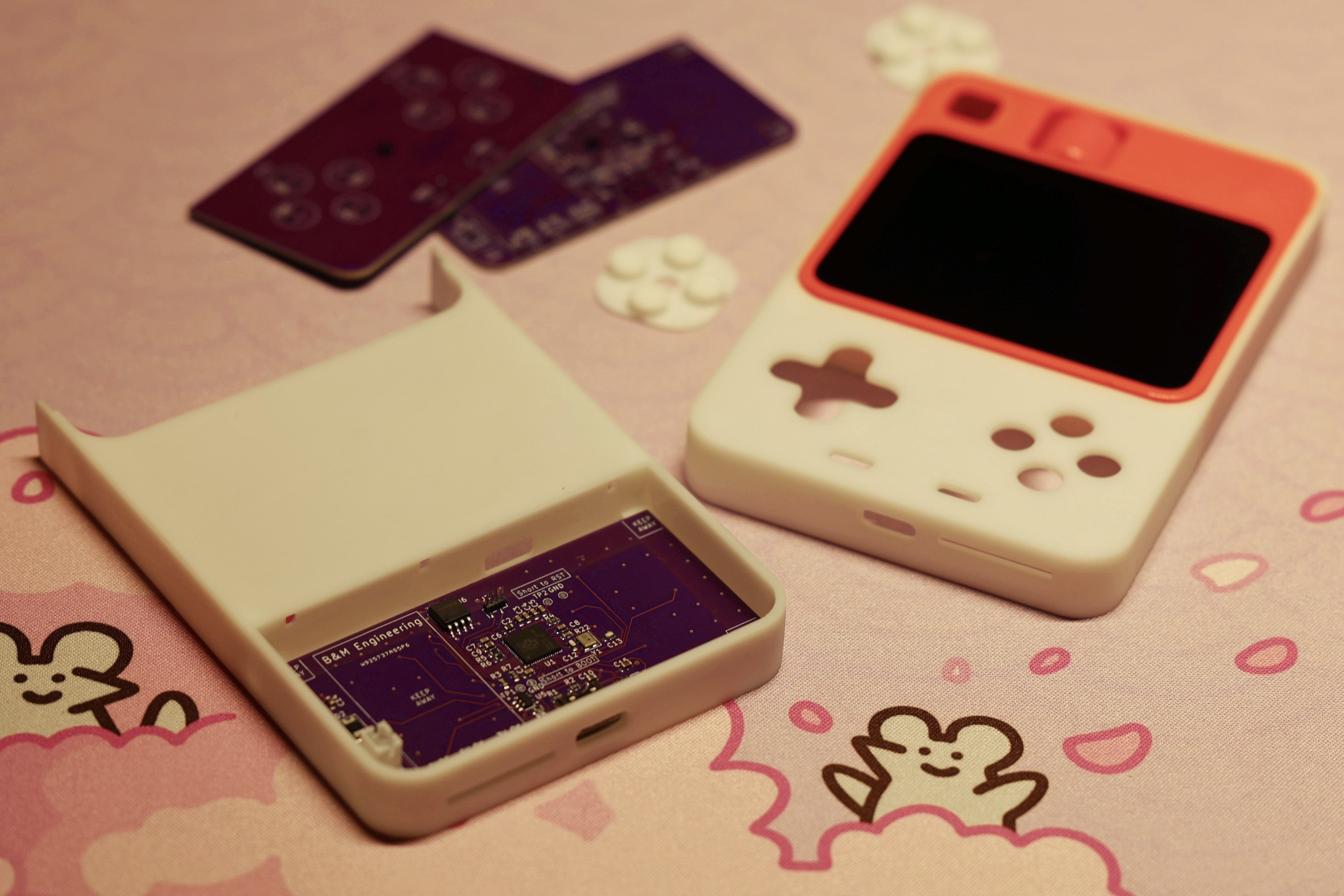

R1 Gamepad
RP2040 based "game pad in a shell" for Rabbit R1.
Rabbit R1 can be flashed to Android OS, this gamepad turns R1 into small gaming console
Public Chat
Gamepad includes 350 mAh battery, 10 tactile switched and 3d printed enclosure

    14 January 2026
    Finally I've received daughter board with USB-C connector. I put wrong cc1 and cc2 lines resistors so for R1 to detect gamepad I had to use power meter since it has own cc lines resistors.
    Anyways - here's short demo
  • PCB
    Dream1iner11/23/2025 at 22:01 0 comments
    23 November 2025
    Finally got the PCBs from the manufacturer: five of them are empty, and one is complete, with all the components soldered.
    I ran a simple electrical test before applying power, and everything looked fine. Then I connected the board to a USB power source, and there were no issues.
    Quick and dirty test firmware has been complied using QMK and it worked!
    I still need to order a second board to make it look pretty, but for the test, I connected the wires directly to J2, connected the board to Rabbit, and played Mortal Kombat: Unchained for a good half hour.
    Couple things that made me nervous:
    1. My power meter tool was unable to detect any current draw when I hooked PCB to power source. Seems like un-flashed rp2040 does not really drawing anything.
    2. Firmware was unable to detect buttons being pressed until I edited code and changed diode direction to
    COL2ROW even though I don't have diodes at all: every button is connected to it's own GPIO to prevent ghosting.

  • Case
    Dream1iner10/24/2025 at 16:08 0 comments
    24 October 2025
    Second iteration of the 3D-printed case, I think I’ve finally decided on the overall size and look.
    I will rework top part since I want this connection to be secure and reliable but it will do for now.
