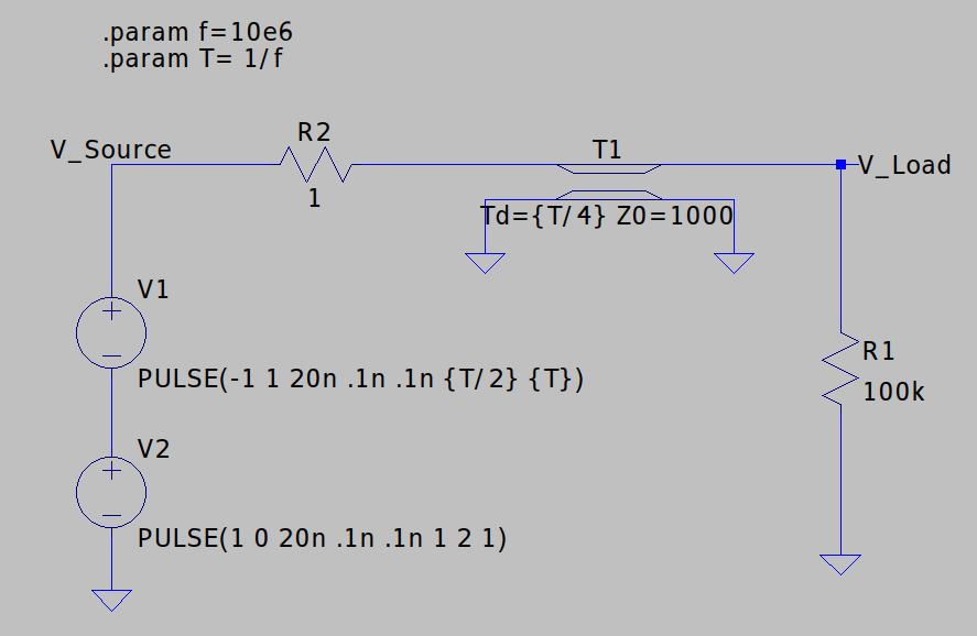

Here’s an LTspice model.  The sources at left generate a 10MHz square-wave that starts at 0V, then begins oscillating between -1V and +1V.  It drives an open-circuited transmission line.  If you look closely at the various model parameters, you'll notice that the transmission line's time delay (Td) is set to 1/4 of the square wave's period (T).   That condition generates the exact timing discussed above, where the source flips polarity right as a reflected pulse arrives back at the source.

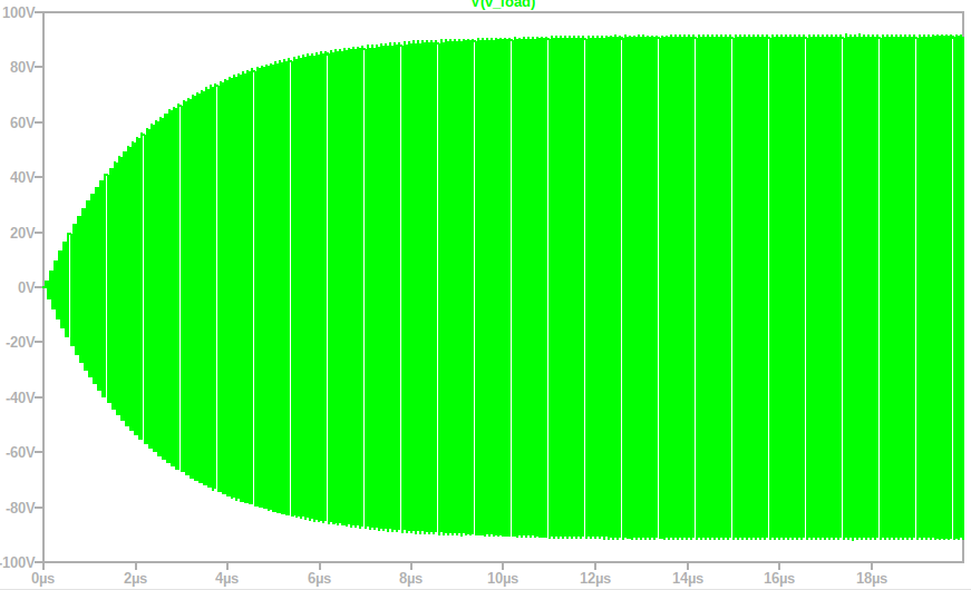

Here's the simulation output.  The top trace (V_source) is the source voltage driving the transmission line.  The second curve (V_load) is the voltage at the open-circuit end of the transmission line.  As we predicted it grows and grows in magnitude.

If we want to use the circuit as a power converter, to boost a voltage, we'll have some finite load resistance.  We'd also have a little source impedance to account for losses in the driver (such as FET on resistance).  In this case, the reflection coefficients at each end of the cable are less than one.  The same voltage-boosting principle still applies.  However, the output voltage will not keep rising toward infinity.  Instead, its rate of in increase will taper off, and then plateau at a finite voltage.
For instance, if we set the source impedance to 1 ohm, load to 100k, and characteristic impedance to 1000 ohms, the load voltage rises to about 91V, peak.  Here's an LTspice simulation showing the results:
