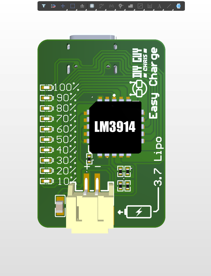

Circuit Design Explanation
The core of this project uses two main ICs working together. The BQ24075 handles the battery charging process safely, while the LM3914 drives the 10-LED display to show battery level. I designed the voltage dividers to scale the battery voltage properly for the LM3914's input range.
The Two Main ICs:
Key Design Points:
- USB-C input for universal compatibility
- Voltage dividers scale battery voltage for the LM3914
- MODE pin selection (dot vs. bar display)
- Proper decoupling capacitors for stable operation
Circuit schematic diagram showing the complete design

Troubleshooting
Initially, all LEDs stayed on regardless of battery voltage. The issue was incorrect voltage scaling for the LM3914. I had to rework the voltage divider resistors to properly scale the battery voltage to the chip's 1.25V reference range.
The Problem:
"After first assembly, all LEDs lit up regardless of battery voltage. This is a common LM3914 mistake!"
All LEDs lit indicating incorrect voltage scaling
The Solution:
- The LM3914 needs scaled voltage inputs
- RHI must connect to the 1.25V reference
- Battery voltage must be divided down
- Use proper resistor values for 2.7V-4.2V range
Testing & Final Result
After fixing the circuit, I tested with various battery states. The LEDs now accurately show charge level from empty to full. The system properly charges batteries while giving clear visual feedback through the LED bar graph.
Final working battery charger with accurate LED display
The completed charger reliably charges Li-ion batteries and provides accurate charge level indication. The compact design combines both charging and monitoring in one professional-looking board ready for use in various projects.
