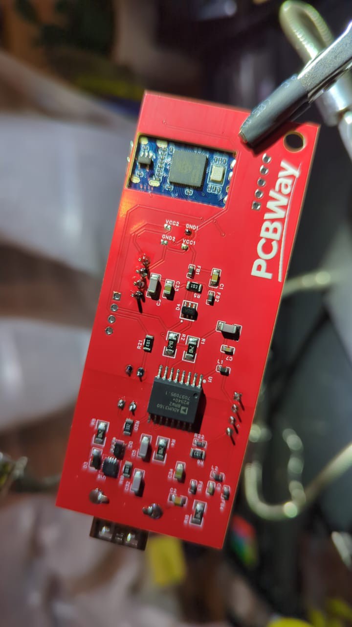

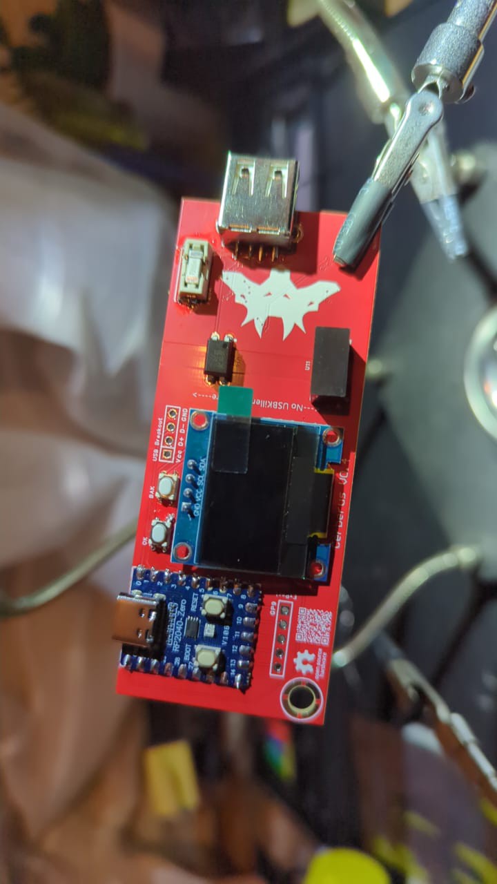

    Hi guys, these past few days I’ve been working more on the project, and I realized there were several things I could improve. For example, I managed to make the device withstand voltage spikes of up to 1500 V without being damaged, which greatly helps protect the hardware. The previous prototype could handle a USB Killer up to version 2, but starting from version 3 it no longer worked, so I had to adapt the design so it could withstand version 3 as well.
    I added a fuse to prevent any component from burning out. This allowed me to avoid having to replace the entire circuit component by component in case of an overload.
    I also had to redesign the entire prototype. The PCB was provided by PCBWay, a great sponsor that not only supplied a high-quality PCB but also helped source and solder some of the best components, which were difficult to find due to how unique they are. This made the result higher quality while keeping the cost very reasonable.

  • Shitty Prototype
    Glitchboi11/06/2025 at 05:03 0 comments

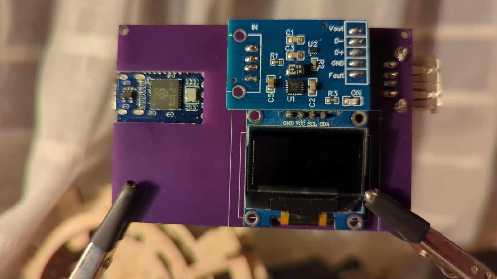

    After a while I finally have a "show and tell" version that works, also I updated the repo to include a lot of info an a to-do section for the future, I'll work in the software part.

    As of today I have finished my first working prototype, I have implemented all functions of the USBValve and added the overvoltage detection and remediation. I based my design in the TPS2514A (Charging Port Controller) and TPD2E001 (Electrostatic Discharge Protection).
    Because of the cost of the "specialty" hardware I design an module to reuse in case of need. I'll upload it later.
