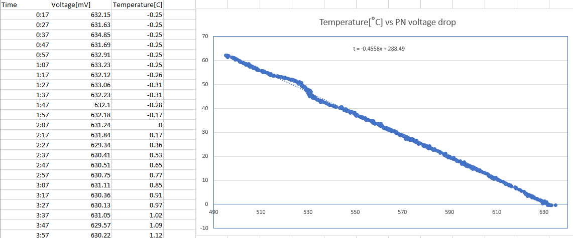

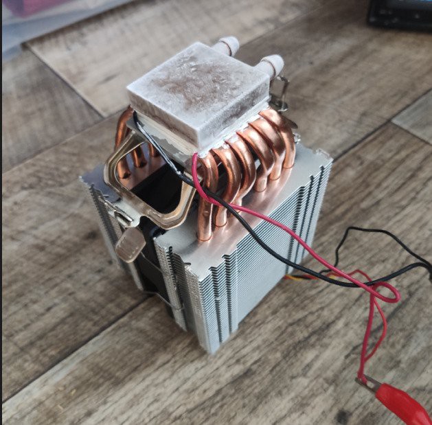

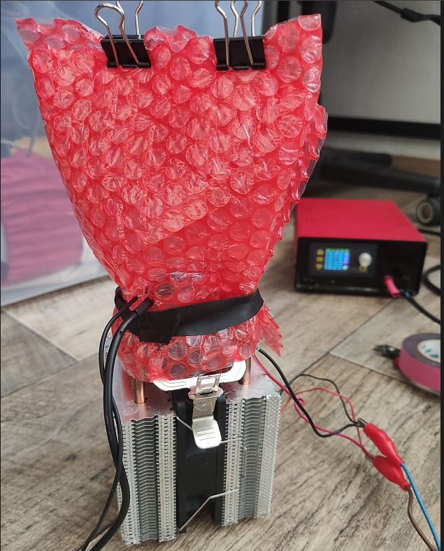

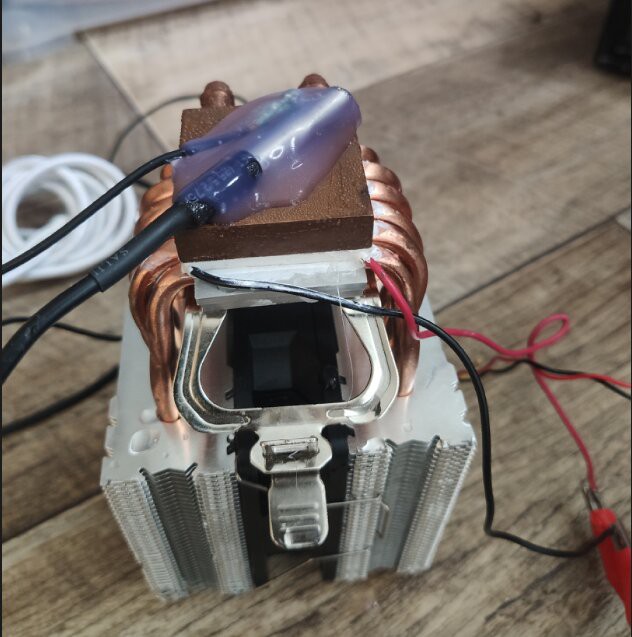

Now we need to calibrate the sensor, so we place both devices under the same temperature conditions. I used a setup with a Peltier module, as it is easier to control the desired temperature by adjusting the input voltage and polarity of the element.
Because of imperfections in the temperature regulation (I adjusted it manually), there is a slightly non-linear region caused by temperature overshoot, where I should have waited longer for the temperature to stabilize. Apart from that, the voltage-versus-temperature (V/T) characteristic is almost perfectly linear.
The approximation equation we obtained is:
T(V, mV) = -0.4558 × V + 288.49
or, when using volts:
T(V) = -455.8 × V + 288.49
This corresponds to a voltage decrease of approximately 2.194 mV/°C.
