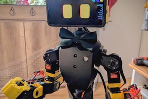

Meet BonicBot A1 (Current Version):
BonicBot A1 is an 80cm tall humanoid that runs on Android. Yes, literally a smartphone mounted in its chest running a custom robot control app.
Current Specs:
- Brain: MediaTek Dimensity 7300 (4nm, 8GB RAM) via Android smartphone
- DOF: 7 (2 arms with 2 DOF each, neck with 3 DOF)
- Mobility: 2x encoder motors (differential drive base)
- Display: 6.67" AMOLED touchscreen + RGB LED matrix "face"
- Sensors: RGB-D camera, IMU, force sensors, mic array
- AI: Gemini AI integration, 100+ language support
- Battery: 4400mAh (2-3 hours operation)
- Weight: 6.5kg (ultra-portable)
- SDK: Python library for easy programming
