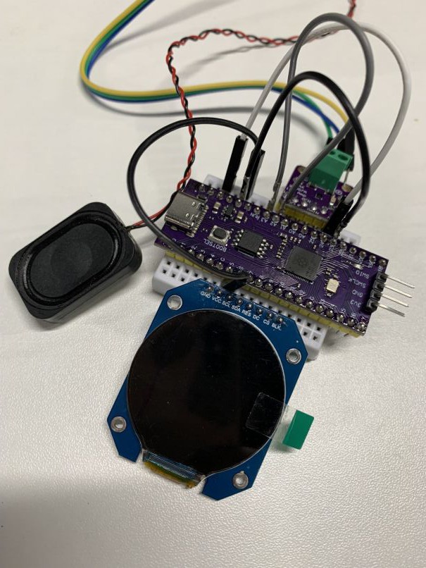

    A prototype device built on a small breadboard, with a Raspberry Pi Pico development board, a round display, and an audio amplifier module connected to a small speaker.
    A pin apparently had a manufacturing defect (?) that caused it to open right at the IC package, so the pins had to be manually shorted and mapped in an odd way in firmware. But after that was clear, driving the display through DMA'ed SPI, and the audio amplifier through I²S (PIO) was mostly smooth sailing. The core problem, as we have predicted, would be in efficient video decoding, and in turn, the selection of video codecs.

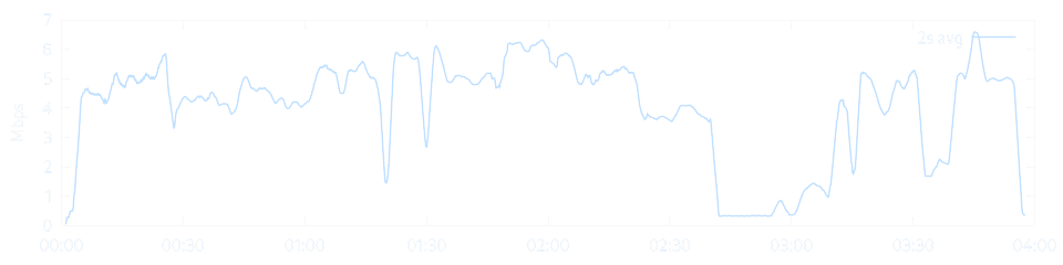

    The first experiment is with the QOI format. QOI is a very simple lossless image codec with a decent compression rate comparable to that of PNG. Applying that to our video frame-by-frame, we get a lossless video encoded at ~15 Mbps. A further downscaling by a half (120×120) yields a much more acceptable 4~5 Mbps:
    Plot of bitrate fluctuations over the entire video's duration. Peaks at 6 Mbps and dips at 0.3 Mbps, averaging to around 4 Mbps.
    Original scale (240×240) is heavy in computation and only able to run at 12 fps, but at half scale, decoding is fast enough to run comfortably within RP2040's default 133 MHz system clock. Combine that with QOA-encoded audio processed with my previous implementation uQOA, we get a first working prototype. Here is a recording of the result:

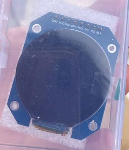

    I already have RP2040 development boards and a spare 1.28" 240×240 display at hand. Audio is less of a concern; an I2S-interfaced MAX98357 block covers all needs.
    A round LCD display in a little plastic box.
