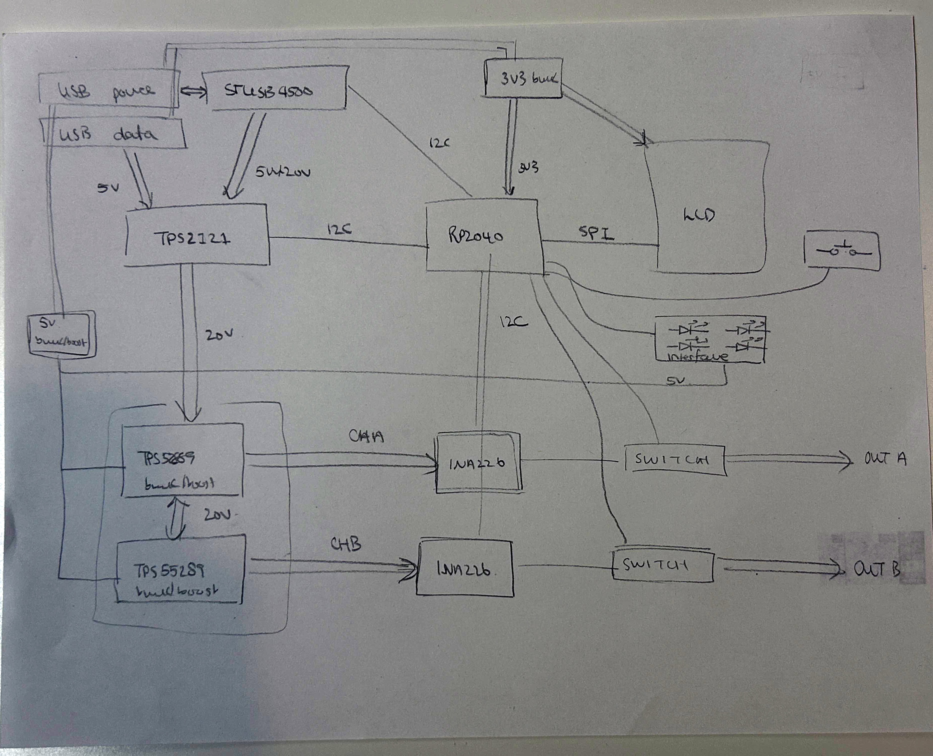

Prototyping block-diagram of the ProtoV power supply.
Combining everything together, I had a clear idea of what I needed to concretize into a final PCB board. A USB Type-C Power delivery (PD) input negotiates up to 100W, for the whole power supply to use. Mediated by the user interface and the MCU, an RP2040, the two channels' voltage and current limits would be adjusted, delivered, and finally measured.

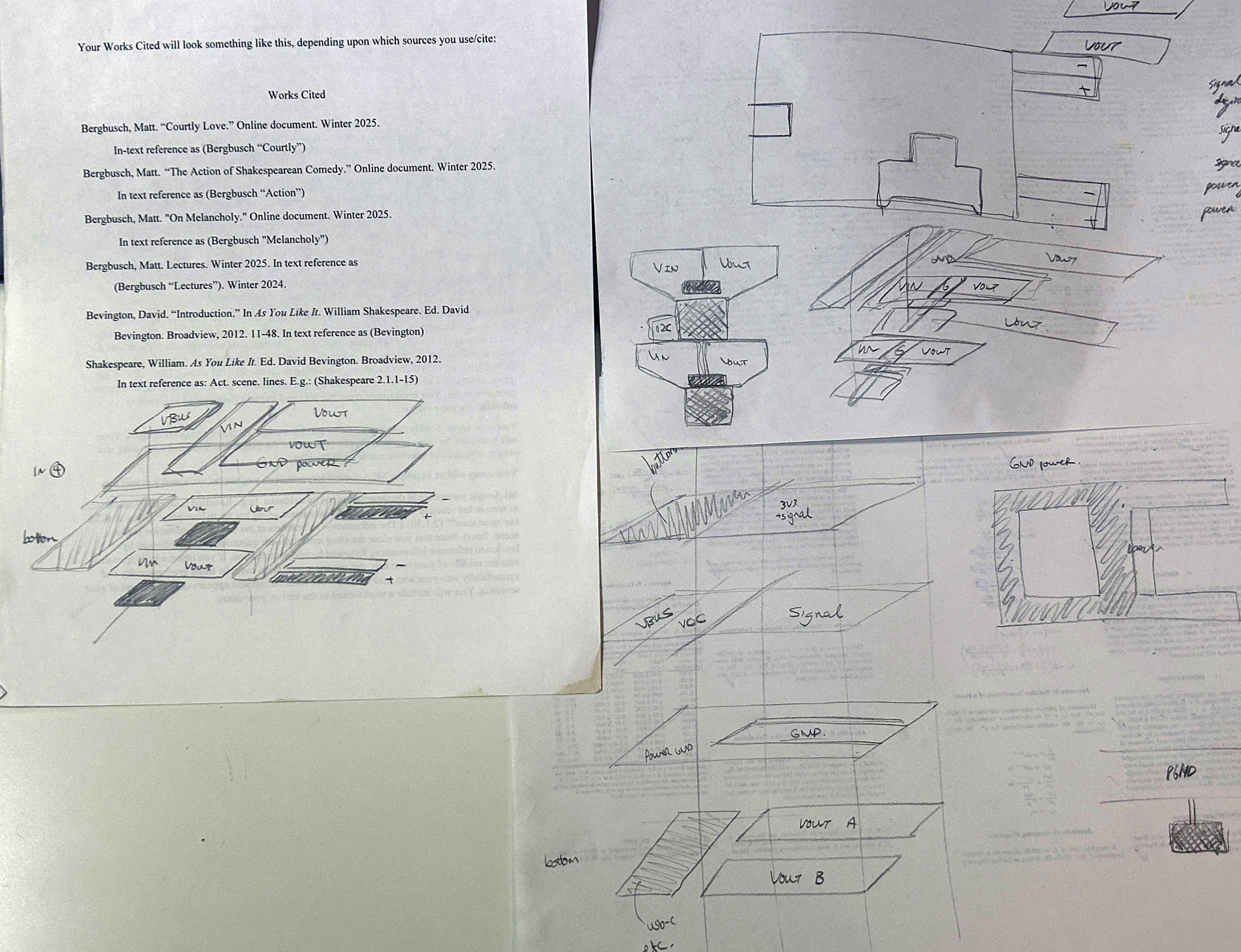

PCB power traces routing concept plans.
One of those "form over function" design choices I decided upon was to have the whole power supply fit within the footprint of a standard credit-card (85.6 mm by 53.98 mm). Though one could also  argue it's "function over form," since that makes the device small... Anyways, power traces need to be hefty, and ground planes large so that the TWO switching converters in that tiny footprint won't act up. I settled on a six-layer PCB, with two inner layers as ground, and power traces doubled with via-stiching.

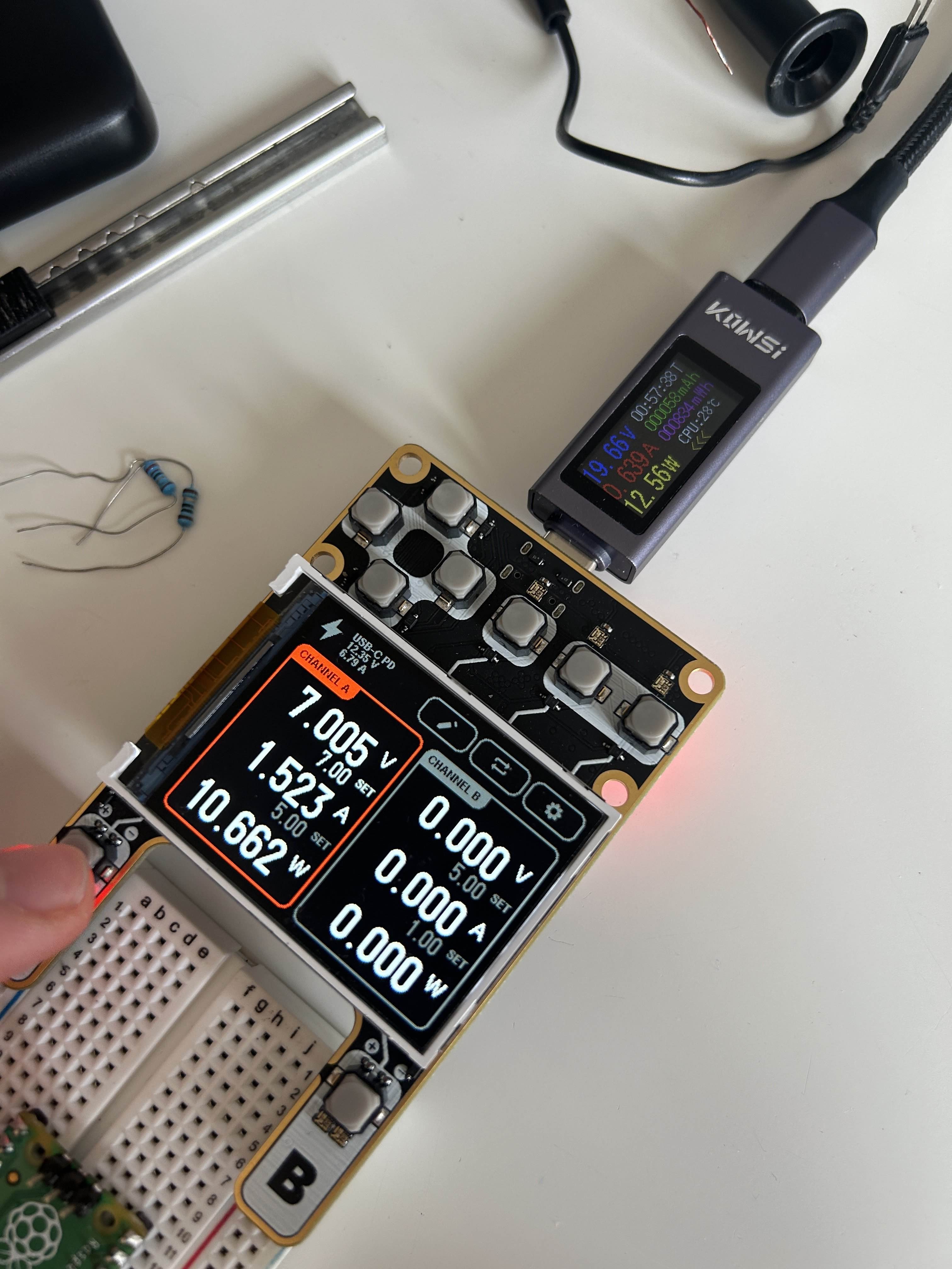

First manually assembled ProtoV unit, with the display mounted on top. Carrying out an efficiency test, measuring input power versus actually delivered power to the load.
Lo and behold, the delivery driver showed up with the first set of six-layer boards, with ENIG edges. I had designed the prongs with pin headers to stick out, so they would interface directly with the power rails of a breadboard. There's also some silkscreen markings to make the UI more intuitive: to properly delimit the D-pad controls, the various settings buttons, and channel enables. I flashed on the firmware I had been writing at the same time, and things worked out well, after a few hours of debugging here and there!

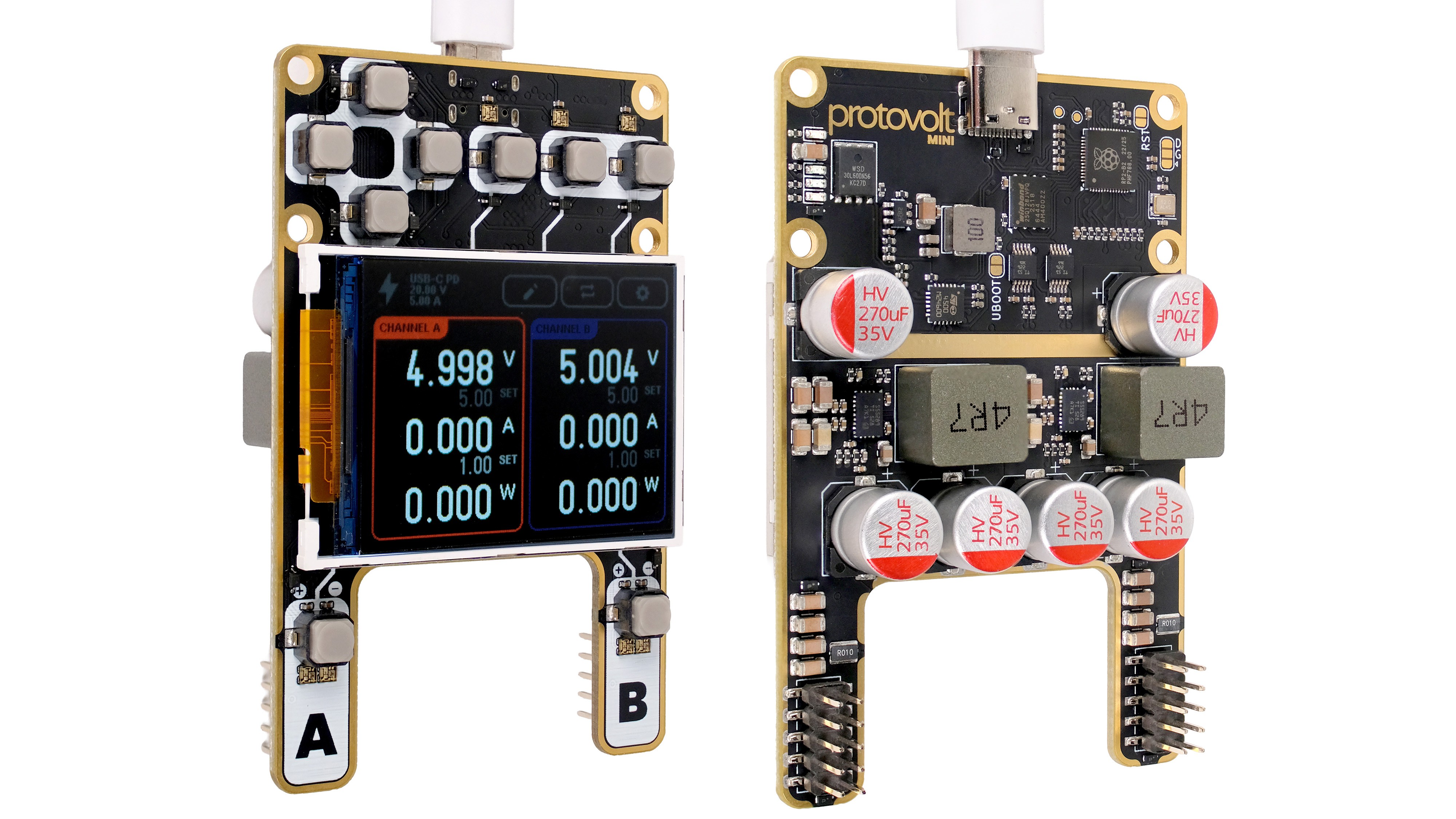

Front and back of a ProtoV MINI, supplying 5V power into both outputs.
Next up: more software development. I'm thinking an API in Python, so that multiple devices can be controlled directly via a host computer. This will allow for the running of long term power tests for professionals, battery charging cycle monitoring, and general lab activites in an educational setting. Also, more hardware revisions as EMI/noise analyses come in. I'll post some transient scope traces, and some FFT noise graphs as midterms roll into finals.
