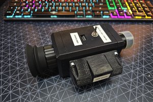

However, after 3D printing and assembling the DIY version, I found it wasn’t very convenient to use. You must keep one eye on the eyepiece while manually adjusting both the lens and the slide, and it takes a lot of effort just to get a clear image. And if you want to take a picture of what you see, that becomes even more troublesome.
So, I thought of attaching a camera to the microscope lens and displaying the image on a PC instead. This way, it becomes much easier to observe and capture images.
2. Choosing the Solution
The first module I tried was the Ai-WB2-32S Cam-D200, which is compact enough for this project. However, during testing, I found its frame rate significantly lower than the BW21-CBV. Therefore, I decided to switch to the BW21-CBV module instead.
With the PCB camera confirmed, the next step was to design a way to mount the lens where the eyepiece is normally positioned.
3. Lens Mounting
I first designed a simple sleeve to firmly hold the BW21-CBV camera lens in place, making it easy to attach the module to the microscope’s eyepiece.
Next, I determined the distance and positioning between the eyepiece and the camera. I designed a lower bayonet-style connector that locks onto the eyepiece, with the clip fitting perfectly to secure them together.
Once the 3D printer finished printing the components, I assembled the eyepiece and the structural parts.
With that, the camera and eyepiece installation was complete.
