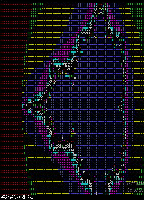

I measured the effect on the Mandelbrot test program (more about this test here). The speedup was modest (about 4%) but bigger advantage is that future keyword additions wont increase the interpretation times as much as a chain of BC would.
Run time in seconds, 100MHz Basic CPU clock, set parameters W=79, H=79, M=20TBIL interpreter with BC (chained "ifs")TBIL interpreter with SA (switch on alpha char)
Regular Basic code (use of PRINT, LET everywhere)91.30587.616
"Optimized" Basic code (use of ?, LET only for vars with keywords starting with same alpha char)90.907 (interpolated)87.234
As can be seen, tweaking the Basic code itself does not contribute significantly to speeding up the benchmark program.

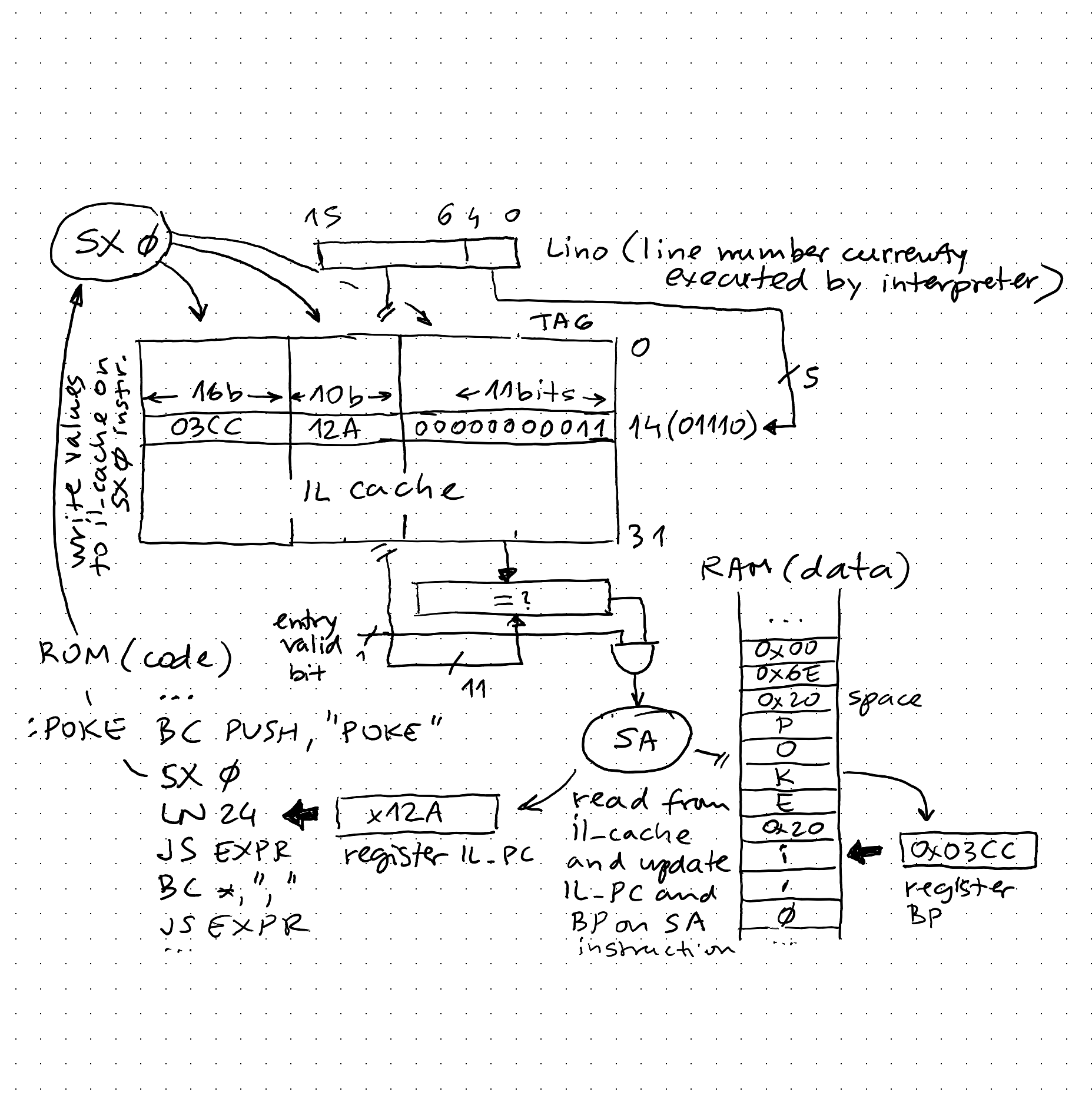

To execute line 110, interpreter must determine if the statement is PRINT, POKE, or maybe just P=... (implied LET). This of course takes time, esp. if done in a loop. If it would be possible to store away the fact that 110 is a POKE, and that its parameters start with i, ... then on other 4095 iterations time could be saved avoiding quite a bit of parsing. This is the goal of the IL cache.
IL cache is 32-entries deep and 48 bits wide (with some padding):
-- TBIL cache
il_cache_entry <= il_cache(to_integer(unsigned(Lino_index)));		-- IL cache entry pointed to by Lino
il_cache_valid <= il_cache_v(to_integer(unsigned(Lino_index))) when (cnt_statement = X"00") else '0';
il_cache_hit <= il_cache_valid when (il_cache_tag = Lino_tag) else '0';
il_cache_empty <= '1' when (il_cache_v = X"00000000") else '0';
il_cache_full <= '1' when (il_cache_v = X"FFFFFFFF") else '0';
 32-entries means that the index is 5 bits, and tag 11 bits because it is indexed by 16-bit integer which is the Basic statement (for example 110 = 0x006E = 00000000011:01110)
The IL cache is only active and meaningful in "run mode", when Basic program is running, otherwise the Lino (line number) register contains 0 and each statement would map to cache entry 0 with little effect.
Sequence to update the cache:
  1. Basic interpreter is modified by adding SX 0 instruction as the first instruction of each Basic command/keyword. SX 0 in original Tiny Basic is a NOP, so could be reused without other side-effect.
  2. When SX 0 is executed, PC_IL (program counter) point to next IL instruction (which is the first instruction of the statement), and BP (Basic pointer) points to first non-blank character after the keyword
  3. Microcode that implements SX takes PC_IL, BP, upper 11 bits of Lino and stores this data into the IL cache, in location determined by lowest 5 bits of Lino (classic cache tag/index)
  4. il_cache_v is a 32 bit flag register - SX 0 also sets the <index> bit in that register to 1, to indicate valid entry
Sequence to read the cache:
  1. SA instruction ("Switch on alpha") first examines the valid bit and match of tag in il_cache with the upper 11 bits of Lino. If both are true, cache entry has been found
  2. If cache hit was detected, IL_PC and BP can be set from il_cache - this means the search sequence to find the keyword is skipped, and also the search for first non-blank in program code (RAM), saving time
  3. If cache hit is not detected, SA instruction execution proceeds as described above
Sequence to clear the cache:
  1. When Lino goes from 0 to non-0 (program execution starts) then il_cache_v 32-bit flag register is reset to 0x00000000. This invalidates all entries in the cache, allowing SX 0 and SA to write to and read from cache.
The il_cache shaves off about  4 to 5% of execution time, depending on the Basic program. Together with 4% saving by introducing the SA instruction as described above, performance boost is about 8%.
