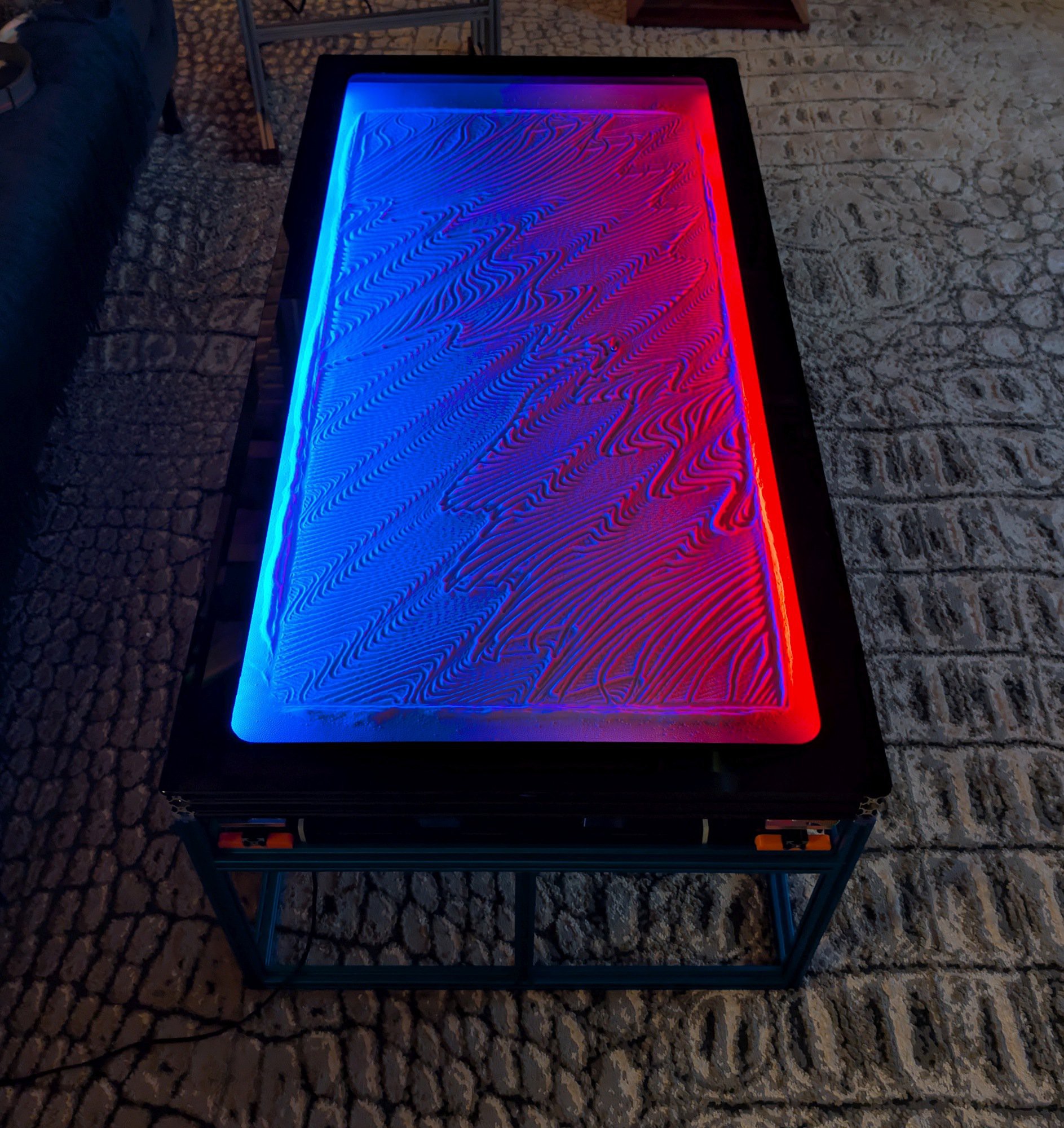

MY previous table, Arrakis 2.0, has found a new home and that left me in need of a new coffee table. I could go out and buy something fashionable, but I liked having the sand table, so I designed a new one. When the old table was moving to its new home, I managed to break the glass top and had to replace it with a new piece, custom made to fit the oak frame, for $330. I wanted the new table to be a little smaller so it would take up a little less space in my living room and could be easily transported by fitting through doorways, and would use a glass top that would be fast, cheap, and easy to replace. A bit of research led me to 24 x 48" glass that's a common size for coffee tables and available cheaply (about $100 delivered from amazon).

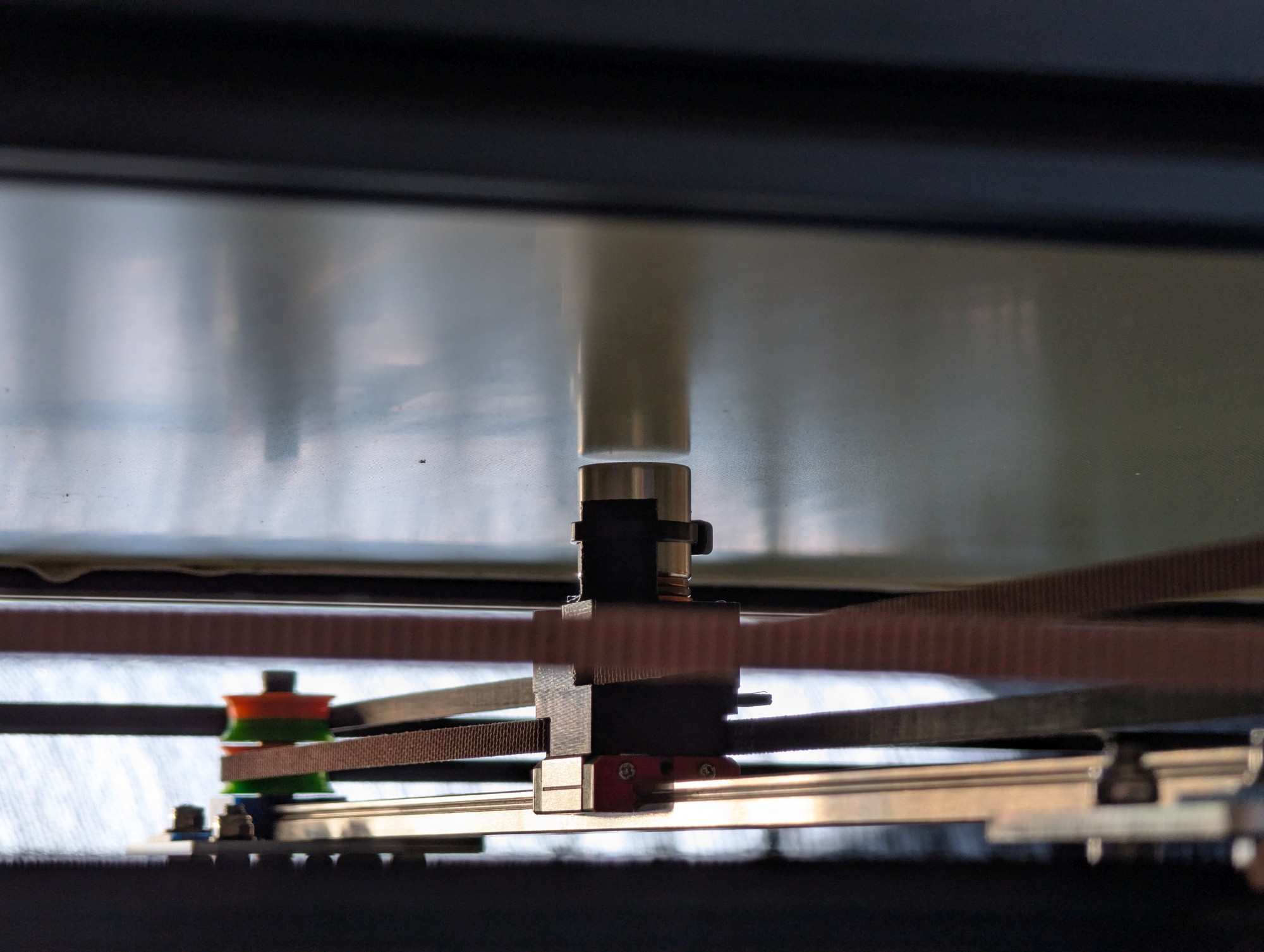

The magnet is a 20 x 20mm cylindrical N52 neodymium type. The magnet carriage/belt clamps are 3D printed parts that screw onto the bearing block on the X axis linear guide. The belt clamps hold the ends of the belts with the teeth interdigitated in narrow slots that don't allow the ends to separate. There is a 3mm air gap between the magnet and the bottom of the sandbox.

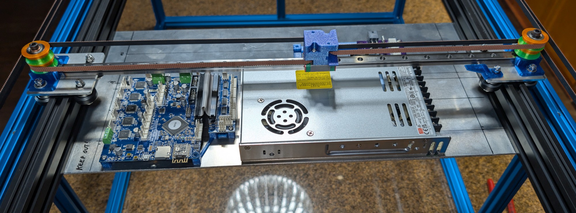

Electronics
Power is provided by a 24V 350W Mean Well switcher. The controller is a Duet3D Duet2 WiFi board with an expansion board that provides step, direction, and enable signals to the servomotors. Endstops are optical type with LM339 comparators and status LEDs onboard. LED strips in the sandbox are powered by a 24-12V buck converter and controlled by their own controller. There are two ReDump protection circuits that sit between the power supply and servomotors. They protect the power supply, controller board, and LEDs against certain types of mechanical/electrical failures at the servomotors.
X axis passes over electronics with plenty of clearance. I was initially concerned that the magnet moving over the controller board could induce errors but it seems to be OK.
Electronics includes 24V 350W power supply, 2x ReDump protection circuits, Duet2WiFi controller and expansion board, LED buck converter and controller.

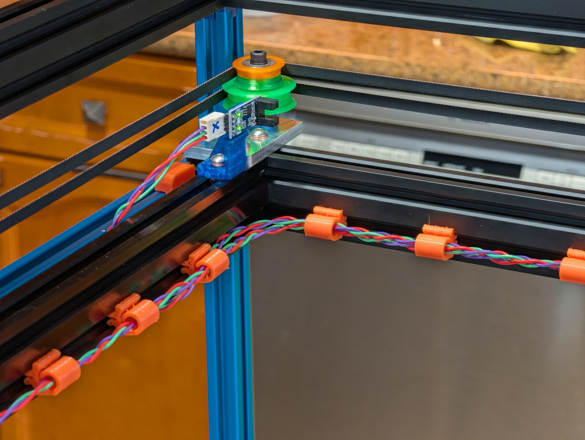

X-flag in X=0 sensor. Moving the sensor along the rail allows the X=0 position to be adjusted.
Y flag in Y=0 sensor. Moving the sensor along the rail allows the Y=0 position to be adjusted. The X flag on the magnet carriage passes over the Y=0 sensor with plenty of clearance.
3D printed TPU cable clips for routing wires

11/15/25-  I got the LEDs working today and played with the air gap between magnet and the underside of the sandbox. After trying a 12 mm ball and seeing it get left behind by the mechanism, I decided to close the air gap a bit. I stacked two pennies under the magnet, then wrapped the magnet carrier with tape and put a zip tie over the tape to make sure the magnet doesn't lift up.
Air gap between the magnet and the bottom of the sandbox. I later wrapped it with tape and then zip tied it because the magnet was lifting up.
Now a 12 mm ball can be used at 1000 mm/sec and it doesn't get left behind by the mechanism, but I'll probably use a 6mm ball.

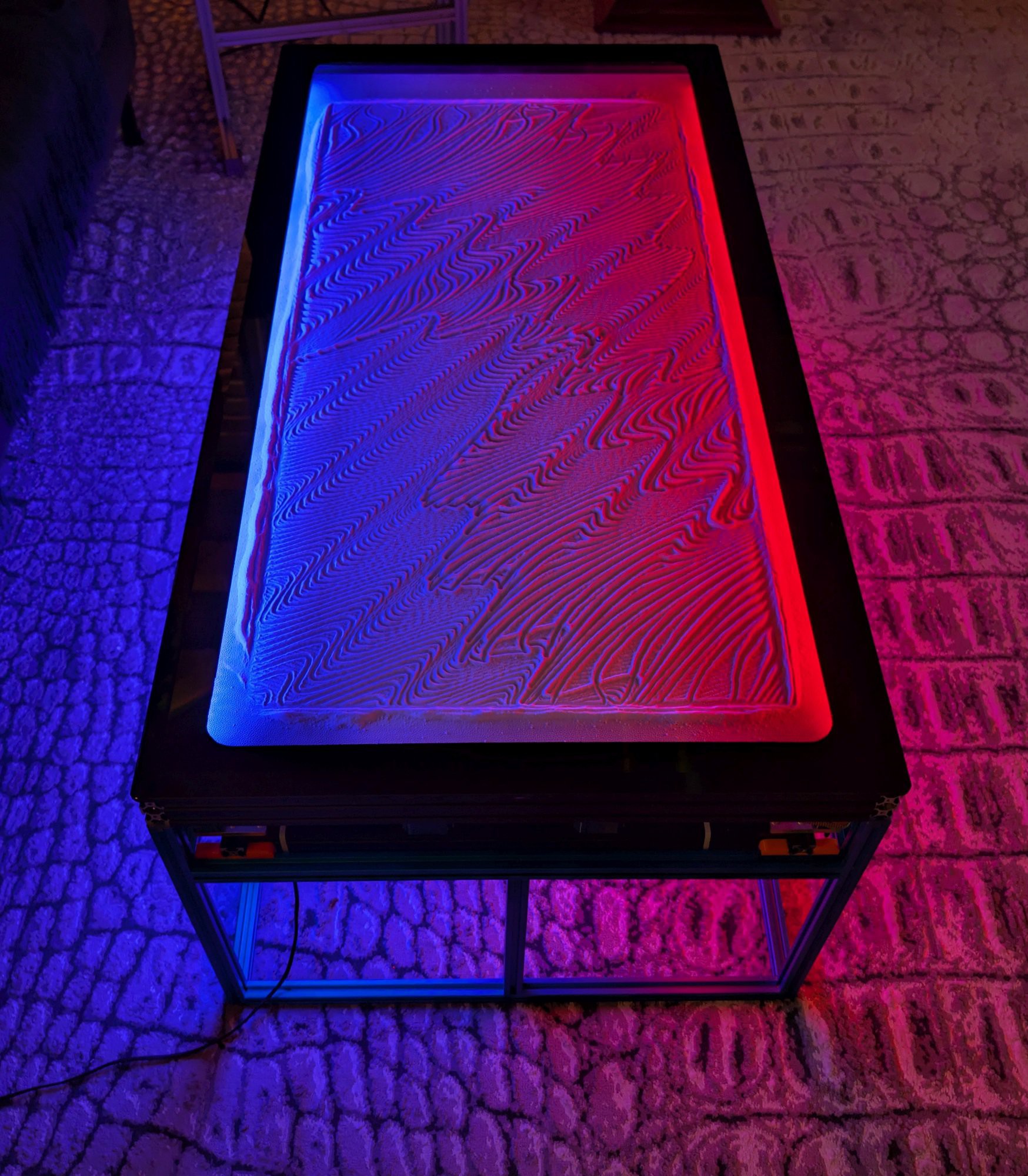

I have added floor lighting under the table connecting the LED strips to the strips inside the sandbox
Floor lights off
Floor lights on
I did some experimenting with Sandify today and found that I can use it to import and scale some pattern files created for Arrakis 2.0 to fit on this table. Unfortunately, it seems to have a file size limitation that causes it to crash with some of the most detailed patterns, so I'm going to have to write a program to scale the patterns myself.
Update 11/22/25
I cut and installed the mirrored blue acrylic side panels today. I used small pieces of clear silicone edging to center the 1/8" panels in the 6.1 mm wide slots in the t- and v-slot. I also added threaded pins to the corner posts of the blue support frame to locate the sandbox and keep it from moving.
Mirrored blue acrylic side panels installed.
The pulleys and belts clear the side panels by about 5 mm. You can see the silicone edging that was used to center the panels in the slots.
This project is officially finished. Now I just have to scale the Arrakis 2.0 pattern files to fit this table...
