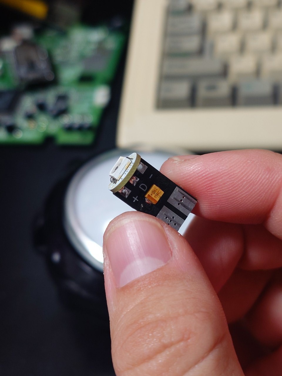

    So, as you may know, I have a bunch of 100mm Sanwa dome buttons which I would love to use for this project. However, I want them to change colors depending on your play accuracy — which is not possible with the two wires the T10 bulb socket of the switch provides you.
    That is until I stumbled upon this article: https://todbot.com/blog/2021/11/19/two-wire-neopixel-ws2812-leds/
    Modern diodes and capacitors are tiny, and PCBs are very cheap, so this blursed contraption was born in the end:
    It wedges into a standard T10 socket and can be controlled with a standard WS2812 protocol — assuming your current capacity on the data pin is sufficient, and you return the data line back to high when you're done transmitting.
