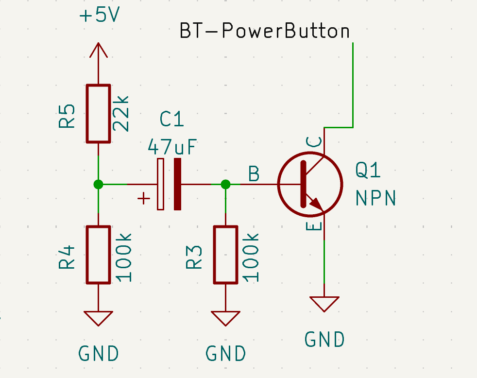

Hacking the Bluetooth module
The Bluetooth module that I got had a major issue for my usecase: it requires a button long press to turn on after being powered. I couldn't find a fix online, so here's some SEO sentence to help other people find this and benefit from my struggle: "how to hack bluetooth module long press turn on".
The solution was an RC pulse generator circuit to activate an NPN transistor for a bit over 3s.
