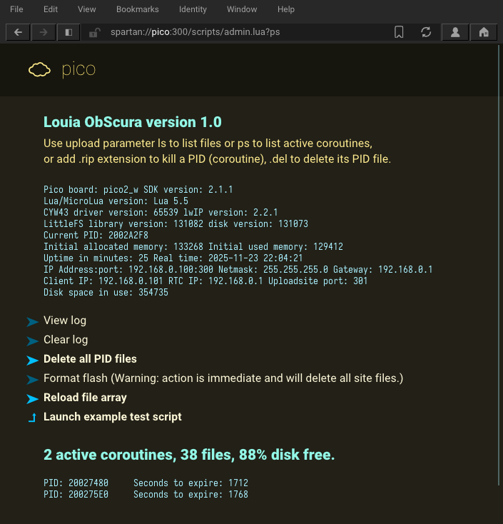

- Software version information
- Pico board type
- PID number of its own process (which ended immediately after serving the page)
- Server uptime and real-time
- Relevant IP addresses and ports
- Total memory use
- Total disk space use, space available, and number of files
- Total coroutines in progress
Then it provides the following custom Spartan hyperlinks:
- View log
- Clear log
- Delete all PID files
- Format flash
- Reload file array
- Launch example test script (obscura.lua) to show off its API and batch capabilities

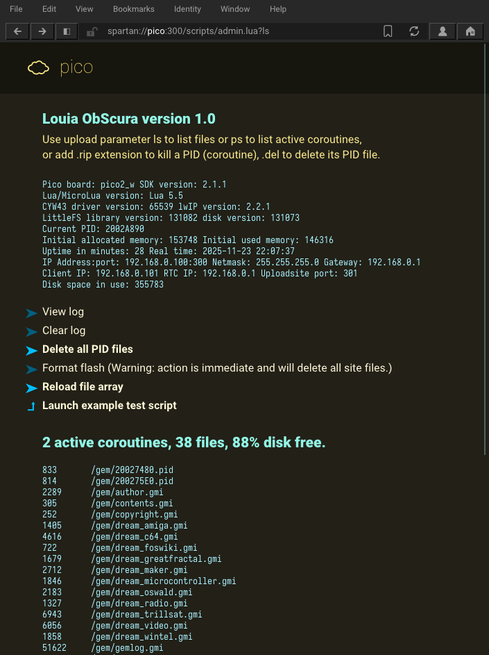

It also includes two Linux-like commands using the Spartan input prompt by typing them into the Lagrange browser URL field like you would type into a Linux shell:
- ps - List all running coroutines
- ls - List all directories and files (including .pid files from coroutines)
Here are examples of it in operation using the Lagrange 1.18.8 browser. Note the ls and ps commands in the URL field:
As shown above, it also responds to various custom paths and extensions, and if an .rip extension is added to a running PID file, it kills that running coroutine. If .del is added, it deletes that .pid file.

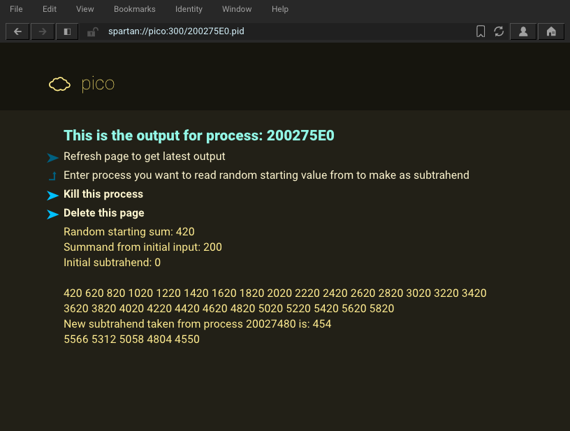

You see, the CGI-like OS can operate like a CGI script that runs some server-side code on request and returns it back, then ends the coroutine. It can also act as a psuedo FastCGI server itself by simply rerunning the bytecode that was already compiled by the Lua load() command within the same coroutine (kind of what FastCGI does by not spawning a separate process each time), but I left this bytecode tweak out of my final source and only commented it, as it is trivial to add later. Or it can run the script and keep running, continuing to send output to a unique .pid file it creates, like a batch process, even pulling information from another coroutine's output (or live input uploaded to that coroutine) then continues processing in the background while it still receives other Spartan requests concurrently. I've opened numerous PIDs (the term I use for coroutine "threads" in this context), and the incremental memory use is fairly low, and I haven't even optimized it yet. I've even opened up to 40 Lagrange browser instances on the Pico 2 W and tried downloading a 1 MB zero-byte file all at the same time, and they all ran concurrently and completed, while still serving other Spartan requests, pushing the limit of that tiny Pico.
Here is an example of the included example test script, obscura.lua in operation, running two instances of itself. It simply sums a series of integers every 3 seconds, using the initial upload string to the script as the starting summand (if any) and then generates a pseudo-random number between 1 and 1000 that it uses as a starting sum. Then it simply iterates and adds the summand to that sum, growing the sum, then adds again, and repeats. When live input is sent to the .pid page generated by this script that contains the hex value of another running PID (a coroutine thread value) that was also created from this script, it will scan that .pid page for its pseudo-random starting sum and then make this a subtrahend, subtracting from the sum. So if the initial summand chosen is larger than the externally-chosen subtrahend, the sum will grow, but if smaller, the sum will decrease, eventually going into negative integers.
Note the input prompt to enter the PID of another process:
It's a simple example that shows how initial input via the original .lua upload, plus live input via the .pid upload, plus reading from another running .pid file like its own reveals its concurrent-processing potential. It was slowed down to 3 seconds per iteration for demonstration, but this delay, of course, can be removed for high-speed processing.
