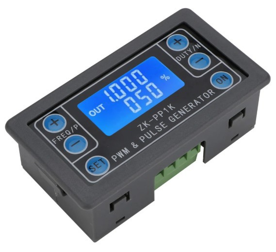

 - The heart of the driver circuit is inexpensive Square Wave Generator with adjustable frequency and duty cycle. This incredibly useful - I also call it magical - module is responsible for the stability and versatility of the entire circuit.
For the price of a few dollars we get a pulse generator with adjustable frequencies from 1Hz to 150kHz, and a duty cycle from 1 to 99%. It even has a small LCD display on which the selected values are displayed. You can notice that I use this module in a number of my previous projects. It can be powered by a voltage from 3 to 30V and the amplitude of the output signal is equal to the supply voltage.

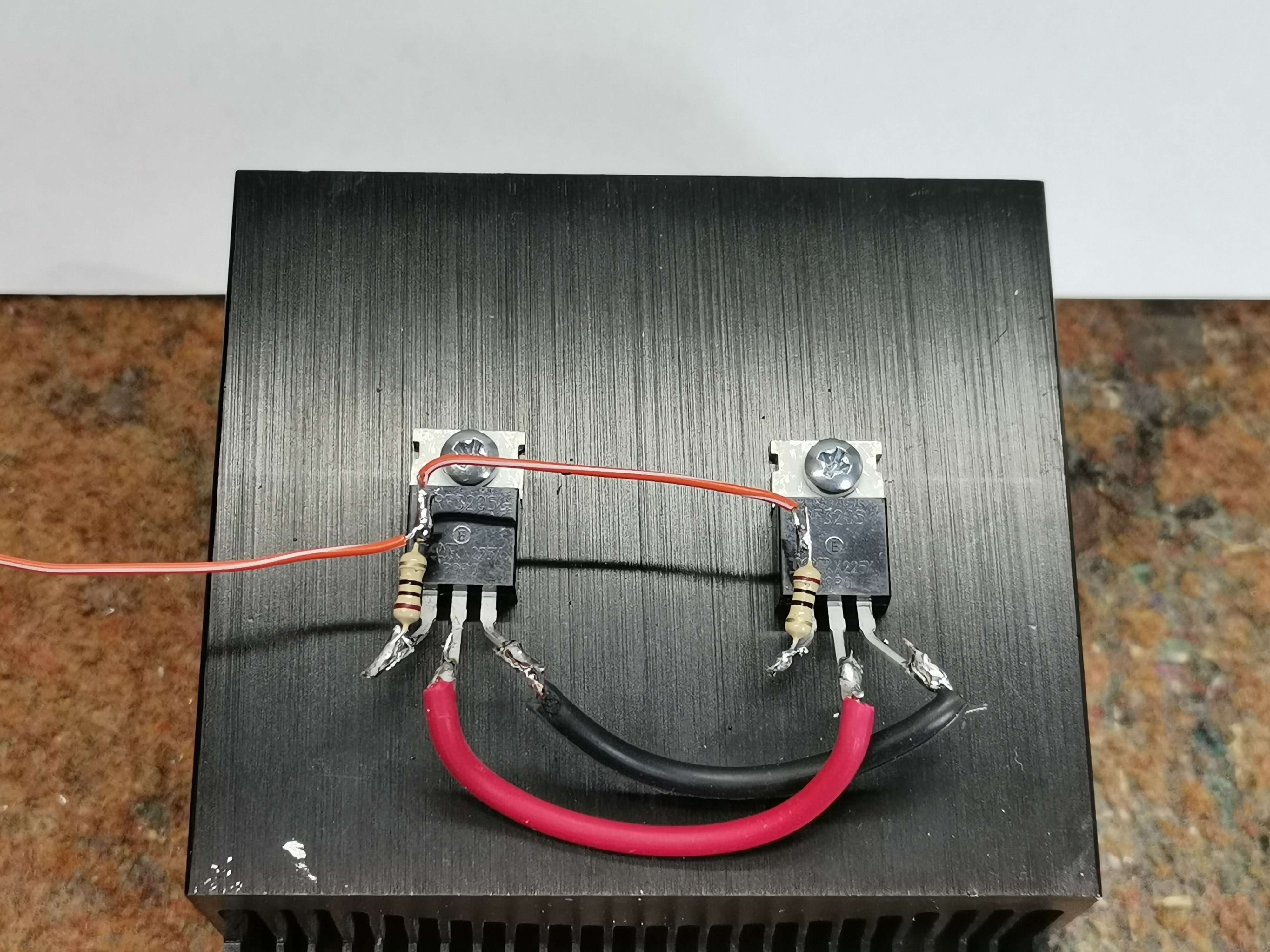

- Then we have two power MOSFETs type IRF3205 connected in parallel amd mounted on a large heatsink that provide power to the low-impedance primary of the HV Transformer.
- 7812 Linear voltage stabilizer which serves to power the ZK-PP1 Module. This stabilizer limits the output rectangular signal to 12V in case we use a power supply greater than 15V, thereby protecting the gate of the output mosfets.
- At the signal output of the generator has a potentiometer with which the amplitude of the generated signal can be continuously regulated.
- At the input side of the low-voltage source, there is an automatic fuse that trips in the event of a driver failure, most likely a burnout of the Mosfets.
