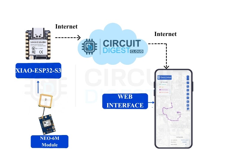

🛠️ How It Works
  1. GPS Fix — The Neo-6M GPS gets satellite signals and computes lat/lon.
  2. ESP32 Processing — The XIAO ESP32-S3 reads the GPS data over UART.
  3. Wi-Fi Upload — Coordinates are sent via Wi-Fi to the GeoLinker API.
  4. Geofence Logic — The code checks distance from a reference point using the Haversine formula.
  5. SMS Alerts — When outside the boundary, an SMS is triggered via a cloud API.
  6. Offline Mode — If Wi-Fi drops, data gets buffered locally and uploaded later.

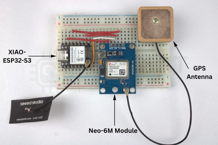

🔌 Hardware You’ll Need
  • Seeed Studio XIAO ESP32-S3 – main controller with Wi-Fi.
  • Neo-6M GPS Module – for GPS coordinate acquisition.
  • Breadboard & Wires – for prototyping.
  • External GPS Antenna – improves satellite reception.

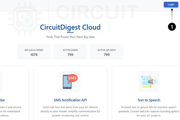

🧠 Code & Cloud Setup
You’ll need a GeoLinker API key for uploads and SMS services. The ESP32 code manages GPS reads, handles geofence checks, and talks to GeoLinker. If your Wi-Fi goes offline, the tracker keeps data in a buffer and resyncs automatically once reconnected.
