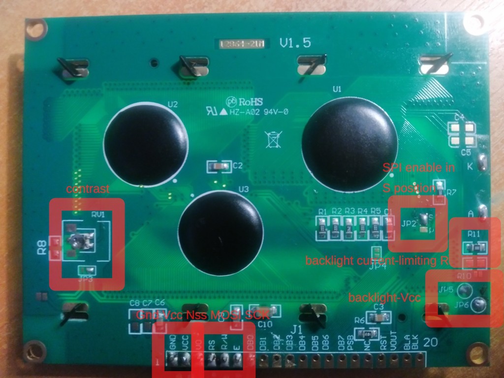

Hardware:
In my variant there was a lot of useful jumpers, who reduces required wires.
  • Connect JP5 and JP6 to power up backlight from VCC-GND pins through 30Ohm R11.
  • Connect JP2 in S position to activate SPI interface (pulls down PSB pin).
Thats'why you need only 5 wires instead of 8.
The interface Is SPI1 of stm32. The pins are: NSS-GPIOA0, SCK-GPIOA5, MOSI-GPIOA7. While NSS pin is software, you may replace it.

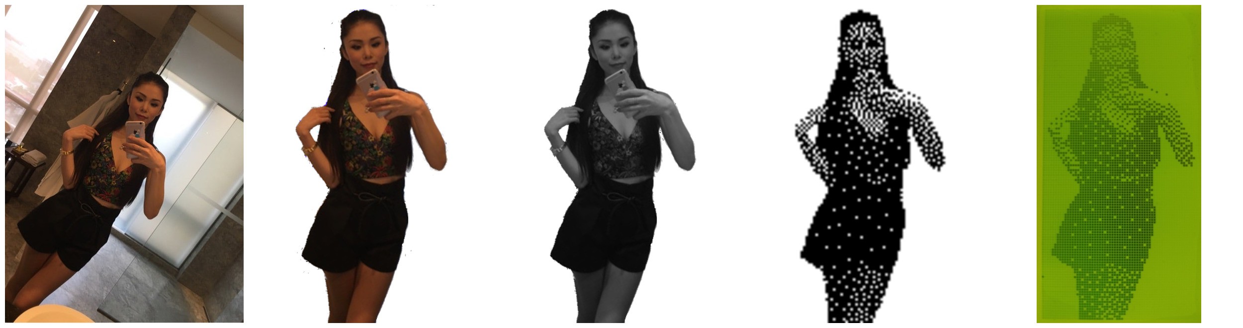

Adding your picture:
Unfortunately there isn't one command to make a picture from your photo.
  • First, crop the image in 2:1 aspect ratio and, optionally, delete the background in gimp. For cropping nomacs image wiever is esiest variant.
  • Resize your image to 128x64. For not coming back to gimp, mirage image viewer can do it instead.
  • Futher you need to have imageMagick and netPbm packages in linux.
  • Convert your jpeg/png to grayscale binary with the commad:
    convert img.png img.pgm
  • Add halftone imitation in your binary image. Convert from grayscale to halftone binary:
    pamditherbw -value 0.2 img.pgm | pamtopnm > img.pnm
    Value is the threshold. Closer to 0 values is lighter, to 1 darker.
  • Convert halftone image to native st7920 format, pbm header:
    convert img.pnm img.pbm
    convert -format pbm img.pbm img.h
  • Correct your header while changing the name from ImageMagick to appropriate. And deleting first 10 bytes in array with header (from 0x50 to 0x0a).
  • Include your img.h and put the array in the dispImage(img) function.
