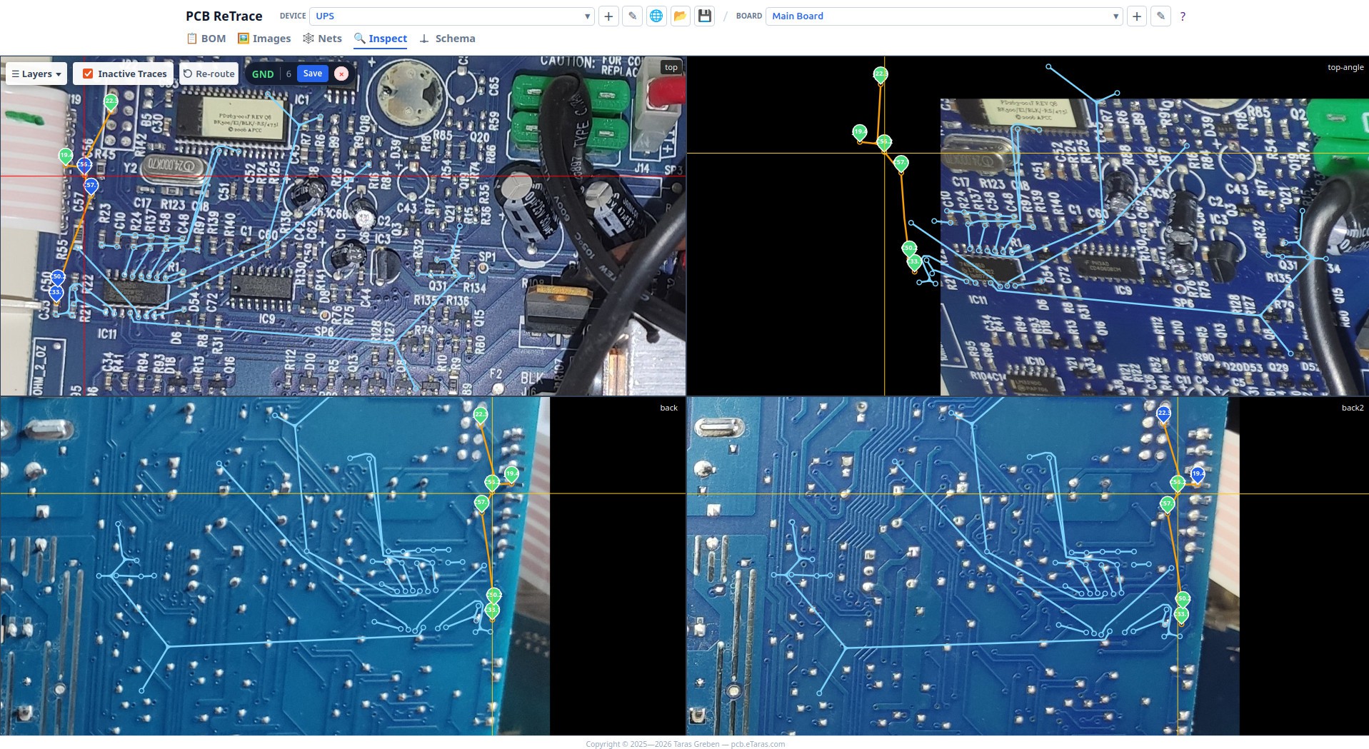

    Just pushed another set of updates to PCB ReTrace. The biggest highlight is a new feature for the Inspector view: netlist connections are now visualized directly on top of physical PCB photos.
    Visual Connectivity in the Inspector
    Up until now, you could trace nets, but verifying them required jumping back and forth. Now, the Inspector can draw connection lines directly overlaid on your board photos.
    • How it works: These lines are not designed to resemble the actual physical copper traces on the board. Instead, the tool automatically calculates connections using your netlist and pin coordinates.
    • Homography Reprojection: The magic relies on the existing homography matrix. It maps these calculated connection paths directly onto your PCB photos, meaning they line up accurately even if your pictures were taken from different angles, or show different sides of the PCB.
    • All Nets Visible: You can now visualize connections for all nets at once to quickly audit the entire board's connectivity in context.
