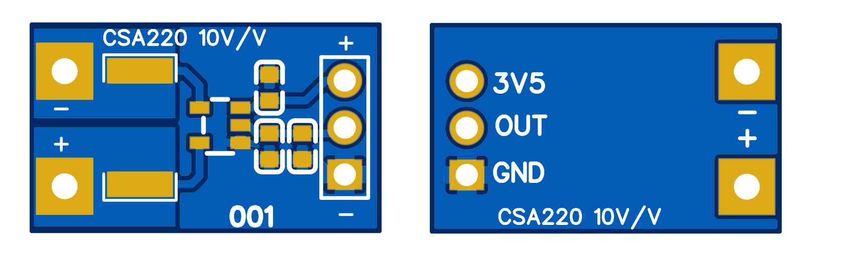

PCB Layout:
I am using the polygon plane method because it is a small PCB. If you want to know kelvin wire measurement, draw small traces from current sense resistor to amplifier. It will reduce the overall parasitics and maintain the power integrity as it is. High-current paths are kept short and wide, analog output trace is isolated from switching currents hence the header is placed on the other side. The decoupling capacitor is placed close to the VDD pin. Download the required files from here.

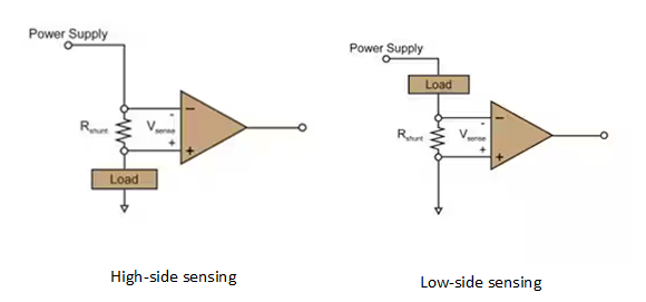

Deciding between High/Low-Side Current Sensing:
The shunt resistor is placed between load and ground. Now the ground potential we are using is not the same as actual ground, the actual ground is below the newly created ground reference; this is called ground shifting. This will break ADC references and communication grounds. Which is not a good method, yet very easy. One major drawback is that because the actual ground is below the created reference, the small voltage developed across the sense resistor can exceed the negative limit of ICMR which may create problems in measuring high currents.
High-Side Current Sensing:
In this method the shunt placed between supply and load, the ground remains intact. It is slightly more complex and then we have to see the upper range of ICMR. It should be more than enough to do this. If using the general purpose amplifiers they can not perform this operation. So either go for a special current sensing amplifier or for a rail to rail opamp.
