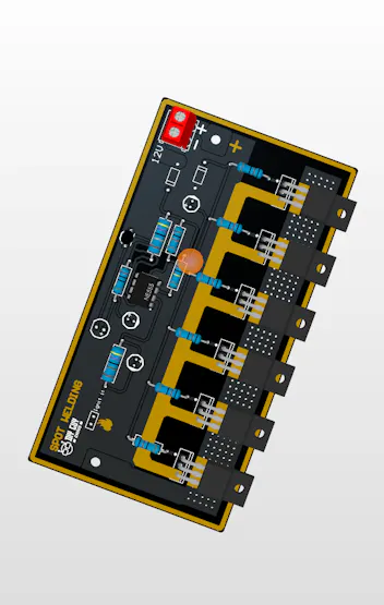

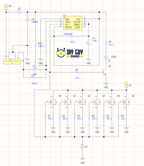

Schematic and PCB Design
Begin by creating the circuit schematic. The heart of our spot welder is the NE555 timer configured in monostable mode. This generates a precise 10ms pulse when triggered. Connect the NE555 following standard monostable configuration: pin 1 to ground, pin 8 to VCC, with a 10kΩ resistor between pins 7 and 8, and a 100nF capacitor from pin 6 to ground. Connect pin 2 (trigger) through a 10kΩ pull-up resistor to VCC and to one side of your push button the other button side goes to ground.
The output from pin 3 drives the gate of our MOSFET array. Since a single MOSFET can't handle the hundreds of amps needed for welding, we'll use six IRLB4132 MOSFETs in parallel. Connect all gates together, all sources together, and all drains together. Add a 220Ω resistor in series with an LED from pin 3 to ground as a pulse indicator. Finally, connect the MOSFET sources to ground and the drains to the positive welding probe terminal.
For the PCB, design wide traces at least 3mm for all high-current paths. Remember that thinner traces will overheat during welding pulses. Arrange components logically with the NE555 and support components on one side and the parallel MOSFETs with ample spacing for heat dissipation on the other. Include clearly labeled terminals for battery input, welding probes, and trigger switch. Once satisfied, export your design as Gerber files for manufacturing. I used JLCPCB, where all solder mask colors cost the same, so pick your favorite!
Circuit Assembly
With your PCB in hand, start assembling components from smallest to largest. First, solder the resistors and capacitors. Use an IC socket for the NE555—this protects the chip from soldering heat and...
