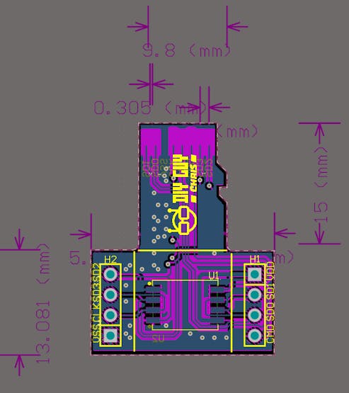

Schematic and PCB Design
Start by designing the breakout board in your preferred PCB design software. I used Altium Develop for this project.
Design Considerations:
  • Create a schematic that duplicates the XTSD chip for top and bottom assembly
  • Connect all chip pins to SIL connectors for easy breadboard compatibility
Follow standard SD card layout for the edge connection if you want reader compatibility
  • Follow standard SD card layout for the edge connection if you want reader compatibility
  • Set PCB thickness to 0.6mm - this is crucial for fitting into standard SD card readers.
  • Use 0.2mm trace width for signal line
  • Add clear pin labeling for easy wiring reference

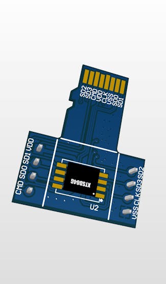

Manufacturing Preparation:
  • Generate Gerber files from your design
  • Choose a solder mask color (I went with JLCPCB's signature blue)
  • Select ENIG (Gold Nickel) surface finish for better solderability
  • Verify all design rules before submission
Pro Tip: You can access my complete design files through the GitHub repository linked at the end of this guide.

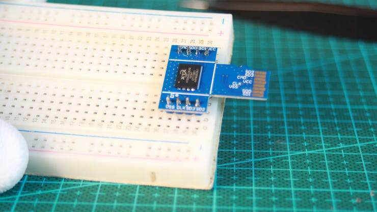

Adding Connectors:
  • Insert SIL pin headers into a breadboard
  • Place the PCB on top, aligning the holes with the pins
  • Solder each pin using a fine-tip soldering iron
  • Use copper braid to clean up any excess solder
Safety Note: Work in a well-ventilated area and use ESD protection when handling the chip.

Breadboard Setup:
  • Place the breakout board on your breadboard
  • Connect power lines first (3.3V and GND)
  • Connect the four SPI signals (CS, MOSI, MISO, SCK)
  • Double-check all connections before powering on
Important: The chip requires 3.3V power! Do not connect it to 5V as this will damage the chip.

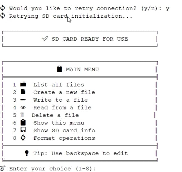

Final Test and Results
Upload the Code:
  • Install the SdFat library via Arduino Library Manager
  • Open the provided Arduino sketch
  • Select your board and port
  • Upload the code to your Arduino
Serial Interface Test:
  • Open Serial Monitor at 9600 baud
  • You should see the main menu with 8 options
Test each function:
  • List files (should show any existing files)
  • Create a new text file
  • Write data to the file
  • Read back the data
  • Delete files (with confirmation)
  • View SD card information
  • Test each function: List files (should show any existing files) Create a new text file Write data to the file Read back the data Delete files (with confirmation) View SD card information
