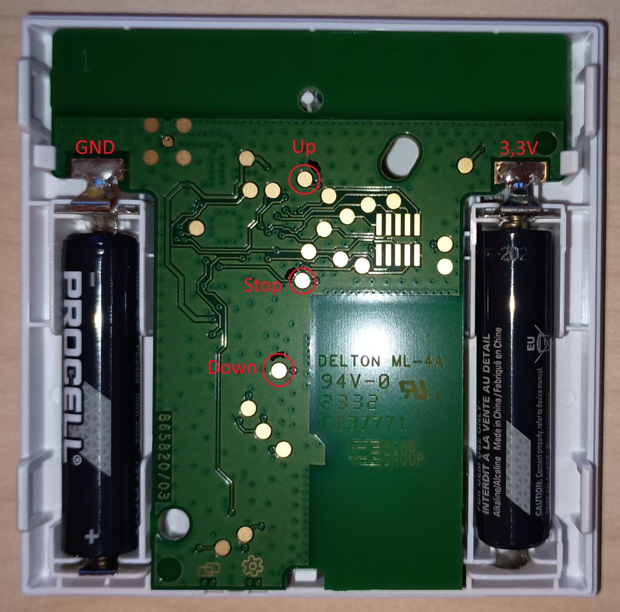

First of all you have to open the back cover of the remote control and as next step the additional cover with the nameplate. Now you have the back side of the PCB in front of you with all the test-points. You can now also remove the PCB, but that's not needed! All you need are the test-points which directly connect to the buttons. The following picture shows you the relevant test points:
The buttons are connected via pull-up to the supply (around 3V) and are pushed to GND by the buttons.
Now I added open collector circuits in parallel to control the signals like the buttons. Thanks to the open collector circuit we have a logic OR condition between the hardware button and the input signal. Additional the open collector circuit acts as a level-shifter, so a 2.5V .. 5V microcontroller can be connected (e.g. the 5V Arduino Nano).
The collector of the NPN transistors (e.g. BC846) must be connected to the test points, the emitter to GND (e.g. by scratching of the solder resist and using the GND-plane or by using a wire to the GND battery connection). Don't forget the resistor between the input and the base.Hint: In the internet there are various projects which directly connect the test points to a microcontroller (e.g. ESP8266) GPIO port. I wouldn't recommend this solution as you now will short the GPIO port to GND if you push the button (exception: You can configure the GPIO port to open-collector like some STM32 can do). If you nevertheless want to use this solution: Check that your GPIOs are working with 3.3V.
