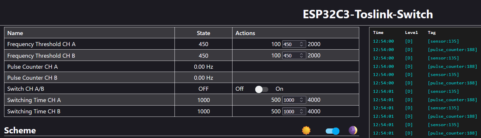

  • ESPHome-based firmware with OTA updates
  • Live configuration via:
    • Home Assistant
    • Integrated web interface

Web Interface:

The ESP32 continuously monitors both inputs and evaluates their activity:
1. Incoming SPDIF signals are frequency-divided (division by 4096) to a measurable range
2. The ESP32 counts pulses to determine signal activity
3. If an input stays above a configurable frequency threshold for a defined time:
   - Channel A → Switch OFF
   - Channel B → Switch ON
4. Once switched, the system waits until the signal drops below the threshold before re-arming
