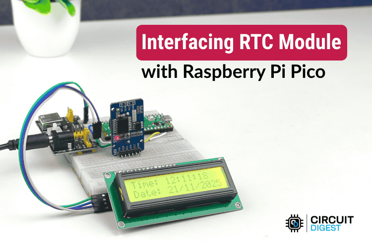

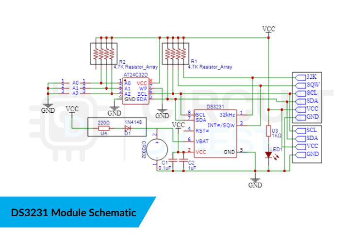

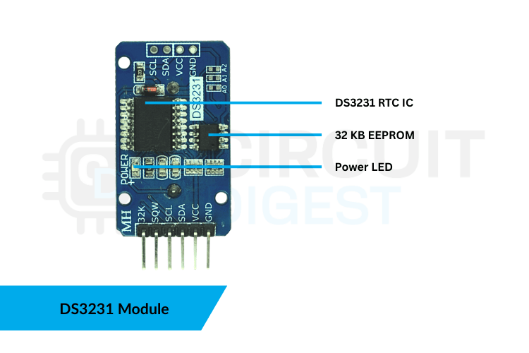

Why DS3231?
The DS3231 is an I²C RTC with a Temperature-Compensated Crystal Oscillator (TCXO), so it stays accurate across temperature swings. It tracks seconds, minutes, hours, day/date, month, and year, and keeps running on its backup battery when the main power drops.
Parts You’ll Need
  • Raspberry Pi Pico (any variant)
  • DS3231 RTC module (with CR2032 battery)
  • 16×2 I²C LCD (with backpack)
  • Breadboard + jumper wires
  • USB cable to program Pico
  • Optional power supply for stand-alone use
