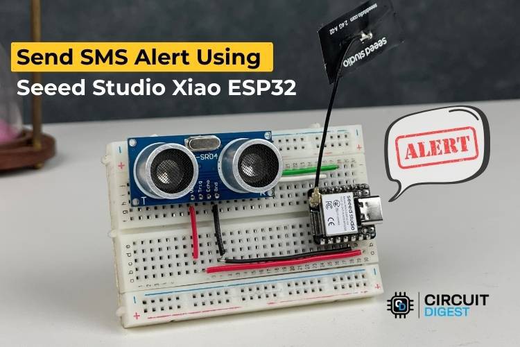

Project Overview
This DIY IoT alert system uses a Send SMS Alert using Seeed Studio XIAO ESP32 microcontroller and an HC-SR04 ultrasonic distance sensor to detect nearby movement and send SMS notifications over Wi-Fi via a cloud API. Instead of GSM hardware, the ESP32 sends HTTP requests to a free SMS service, keeping the design compact, cheap, and easy to replicate.

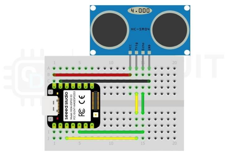

Wiring Guide
Keep the hardware simple with just four connections:

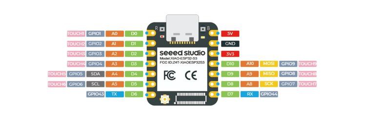

HC-SR04 PinXIAO ESP32 PinNotes
VCC5VPower
GNDGNDGround
TrigGPIO 5Trigger signal
EchoGPIO 3Echo pulse input
No level shifting is needed for basic operation with the HC-SR04, and the tiny XIAO form factor fits neatly on a breadboard.
