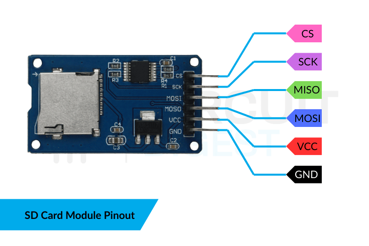

An SD card module typically contains:
  • A microSD card socket for the storage media,
  • A 3.3 V voltage regulator and level-shifters (if powered from 5 V),
  • Pull-up resistors and basic supporting components.

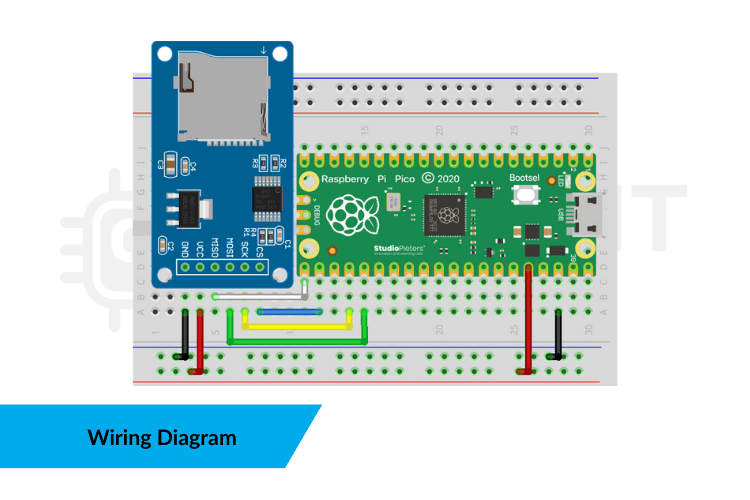

These hardware features protect the SD card and translate logic levels for safe communication with the Pico. Most modules expose six main pins: VCC, GND, MISO, MOSI, SCK, and CS (Chip Select).
Required Components
Here’s everything you need to build the project:
  • Raspberry Pi Pico – RP2040 microcontroller board
  • SD card module – with SPI interface and voltage regulation
  • microSD card – formatted as FAT32
  • Breadboard and jumper wires
  • USB cable – to power and program the Pico
