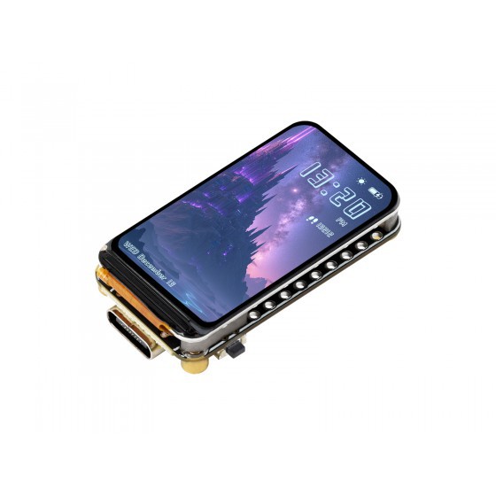

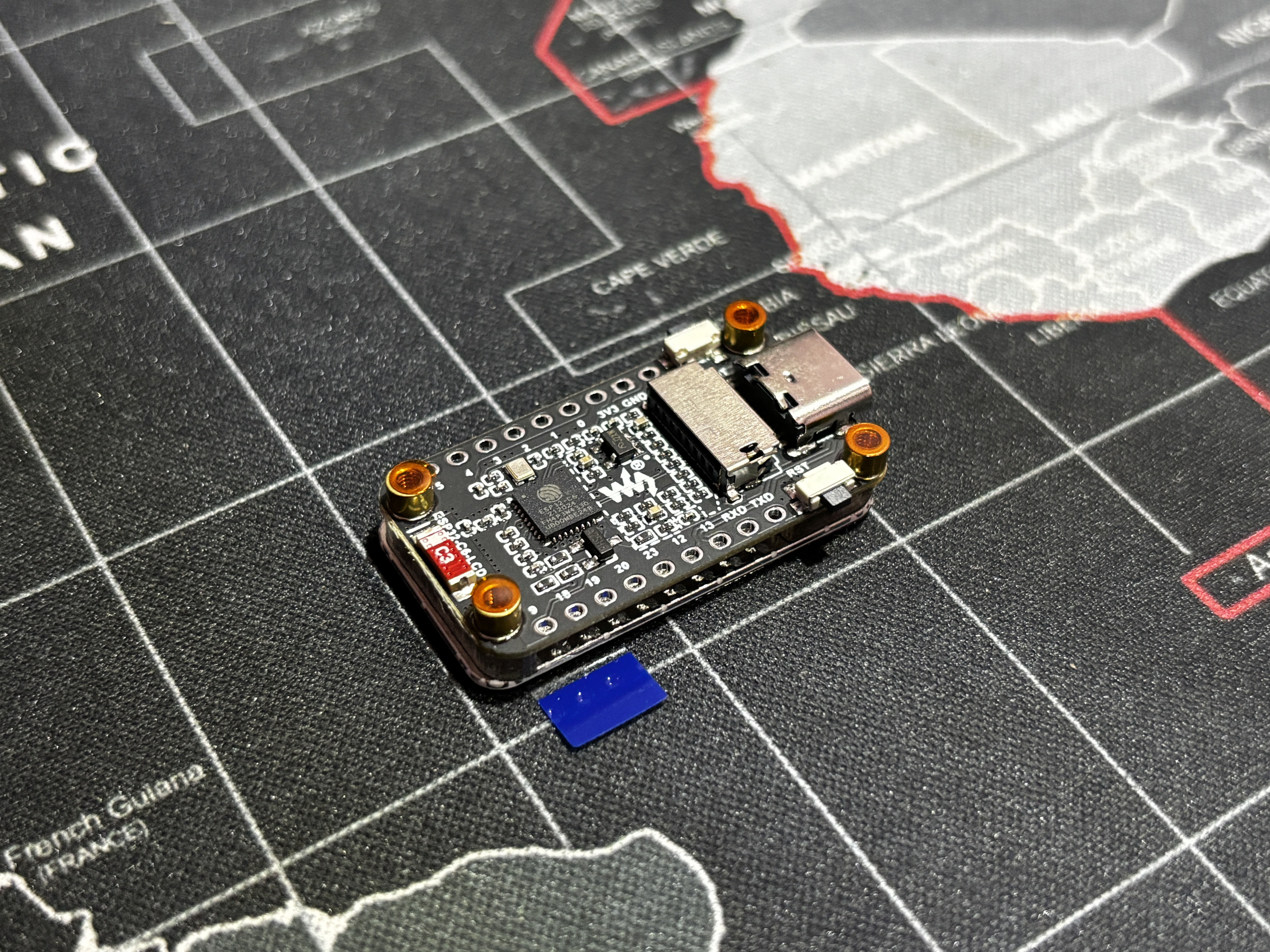

ESP32 S3 DEV BOARD
For the main microcontroller, we are using the ESP32-S3 LCD 1.47" Display Board by Waveshare. The name might be long, but the board itself is surprisingly compact, and it packs a lot of power into a small footprint. At its core, the board is powered by an ESP32-S3 microcontroller, featuring a dual-core 32-bit Xtensa LX7 processor running at up to 240 MHz, along with built-in Wi-Fi (802.11 b/g/n) and Bluetooth 5 (LE) support. It comes with 8 MB of Flash and PSRAM, making it well suited for applications that require graphics, real-time data processing, and responsive user interfaces. The board integrates a 1.47" SPI-based ST7789 LCD display with a resolution of 172 × 320 pixels and support for 262K colors. Despite its small size, the display is crisp and vibrant, making it ideal for compact UI elements such as fan RPM readouts, mode indicators, and status screens. For interaction and expansion, the board includes an onboard RGB LED for visual feedback, a TF (microSD) card slot, and a GPIO header that allows additional peripherals to be connected directly. The ST7789 display works reliably with graphics libraries such as Adafruit GFX and LVGL, making UI development straightforward. You can check out more about this display from its wiki page. https://www.waveshare.com/wiki/ESP32-C6-LCD-1.47 Also, for sourcing this display, we got it from PCBWAY's gift shop. https://pcbway.com/s/cQO566

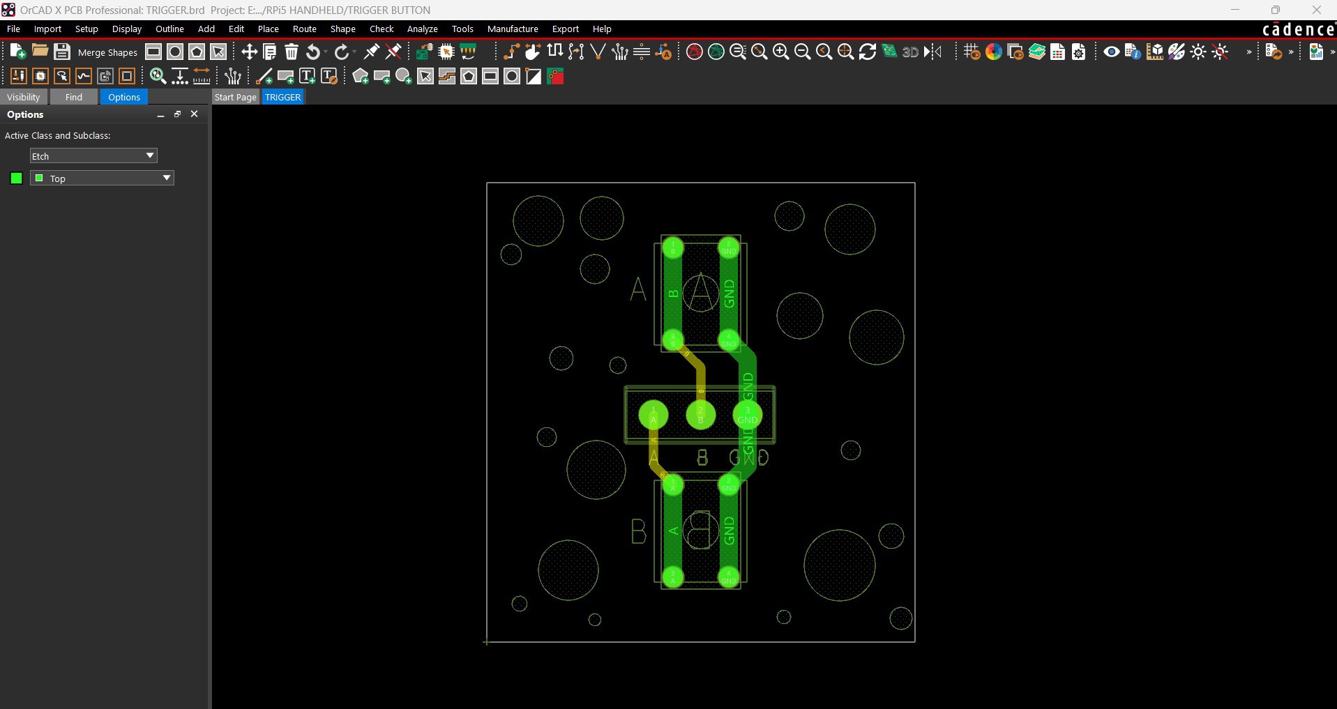

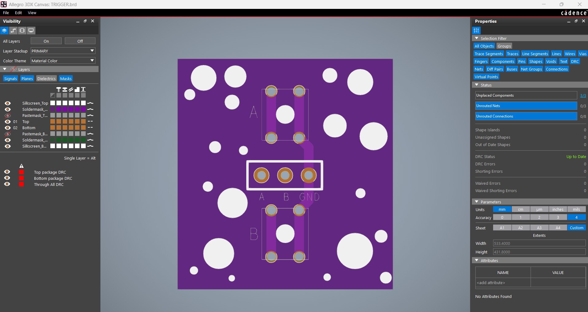

SWITCH PCB
For this project, we reused one of our previously designed switch PCBs. The board consists of two 4×4 tactile push buttons wired in a pull-down configuration. The ground pins of both switches are connected together, and each button pulls its respective signal line low when pressed, allowing the microcontroller to reliably detect button presses. After finalizing the schematic, we designed the PCB and added a few custom elements to the silkscreen layer to improve its overall aesthetics and make the board easier to identify during assembly. Once the design was complete, the Gerber files were exported and shared with a PCB manufacturer for fabrication.

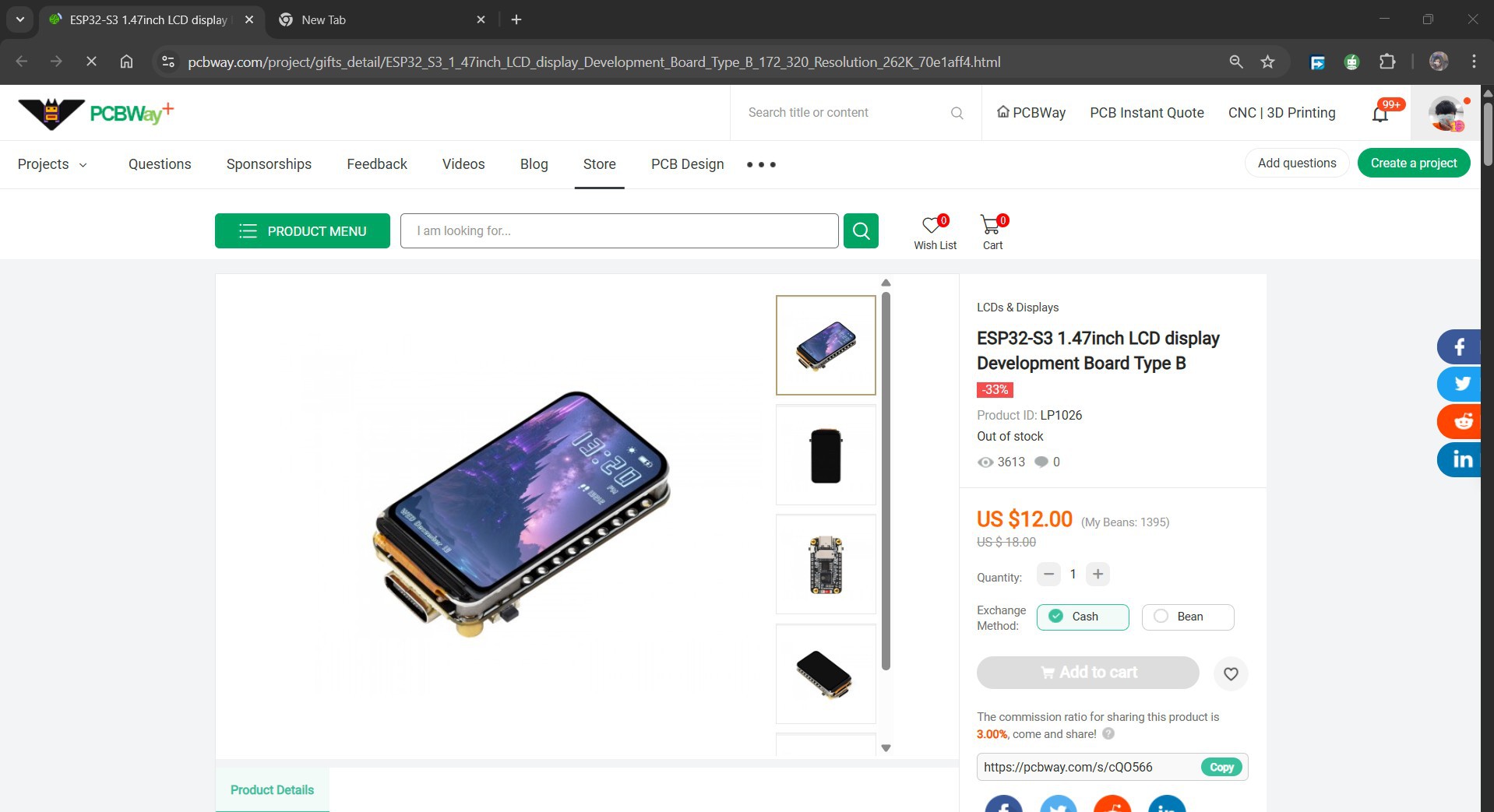

After finalizing the PCB design, we exported the Gerber files and uploaded them to the quote page on PCBWay.
For this project, we chose a purple solder mask with white silkscreen. The PCBs were delivered within a week, and the quality was excellent, as always. While I usually stick to white or standard black solder masks for most of my builds, this time I decided to try PCBWay’s purple finish. This was partly inspired by their Christmas sale campaign, during which matte black, purple, and pink solder mask options were available for a limited time. Over the past ten years, PCBWay has distinguished themselves by providing outstanding PCB manufacturing and assembly services, becoming a trusted partner for countless engineers and designers worldwide. Also, PCBWay is organizing the PCBWay 8th Project Design Contest, a global event that invites makers, engineers, and innovators to showcase their most creative builds. With categories in Electronics, Mechanical, and AIoT, it’s a great opportunity to share your work, connect with the community, and compete for exciting prizes. You guys can check out PCBWAY if you want great PCB service at an affordable rate.
