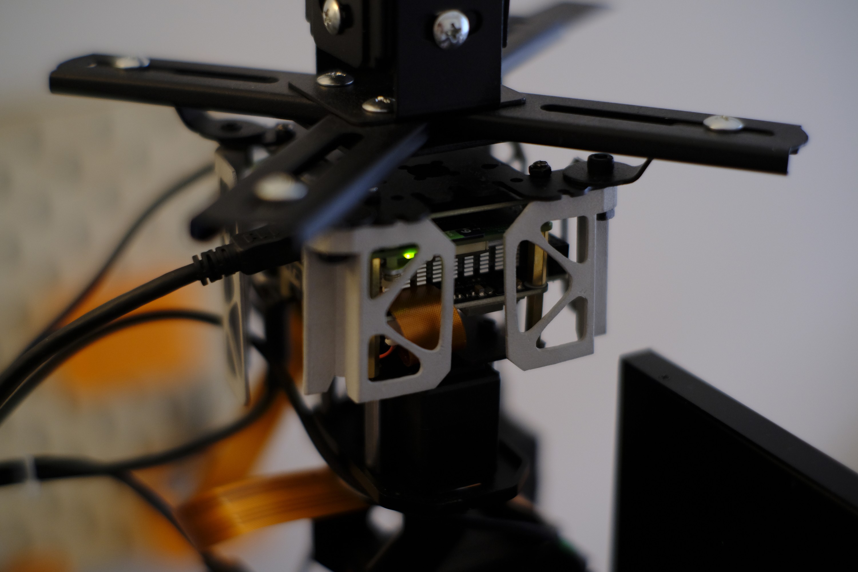

This build is based on the Waveshare 360° Omnidirectional High-Torque 2-Axis Expandable Pan-Tilt Camera Module. I’ve essentially turned the module upside down and mounted it to a projector holder.

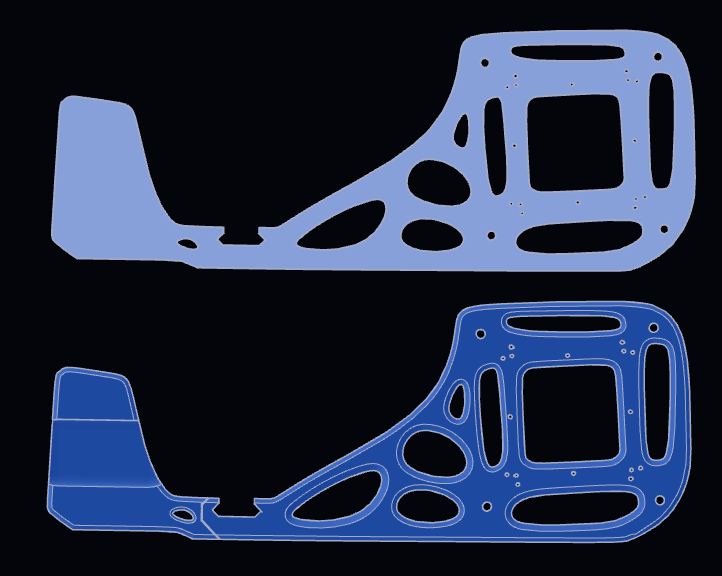

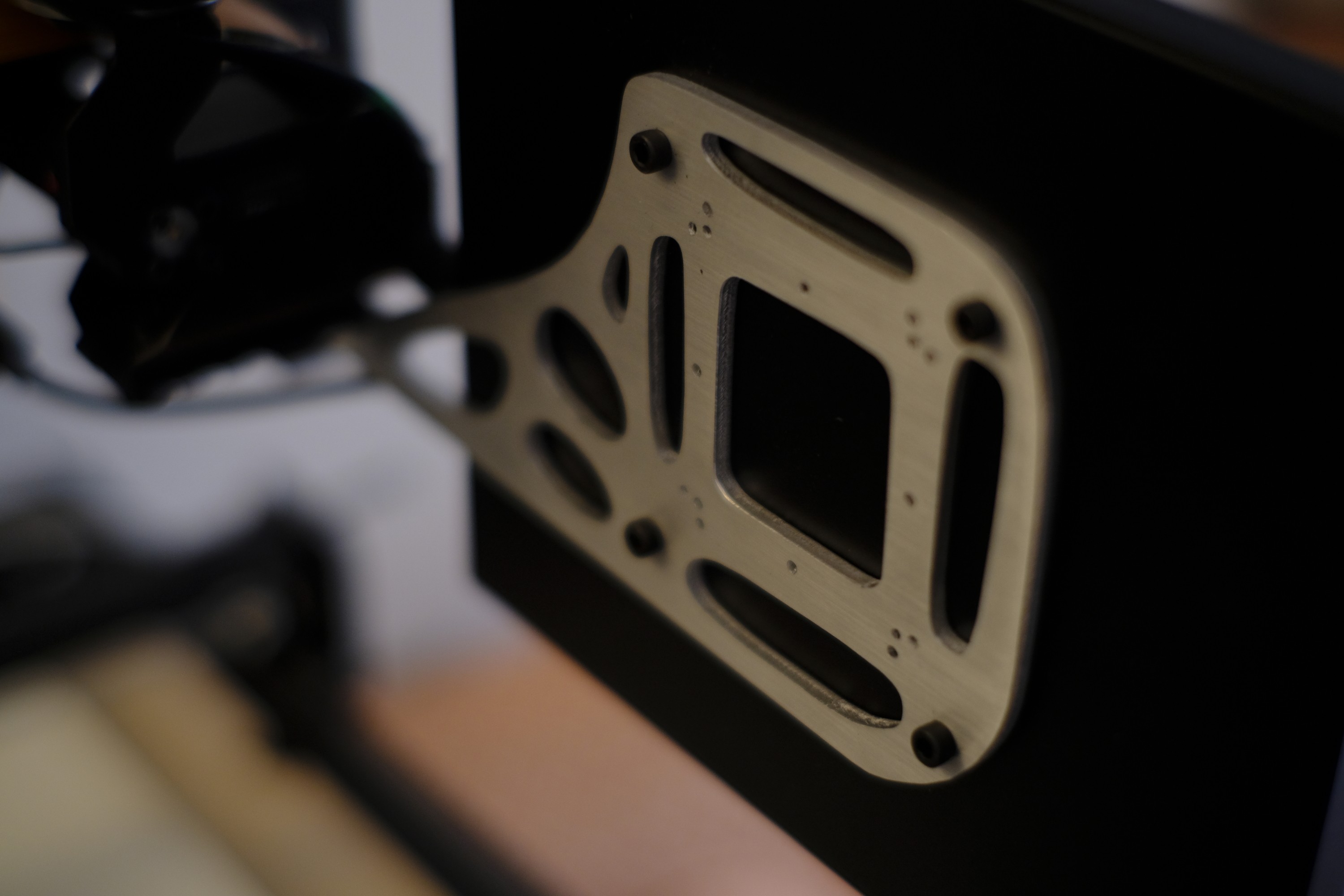

I’ve attached the SVG for laser-cutting the mounting plate from 4mm aluminum sheet. Surprisingly, this is very affordable (under $30 at the time of writing) and significantly more stable than the 3D-printed PETG-CF backing I used before. If you’d rather print it at home, I’ve also included the 3D model version.
The bracket uses a simple topology-optimized design. It works well and gives the build an organic Y2K aesthetic. The 3D-printed version can be printed in two parts on my A1 Mini and superglued together — not perfect, but it holds up well enough if you don't have a large enough build plate.

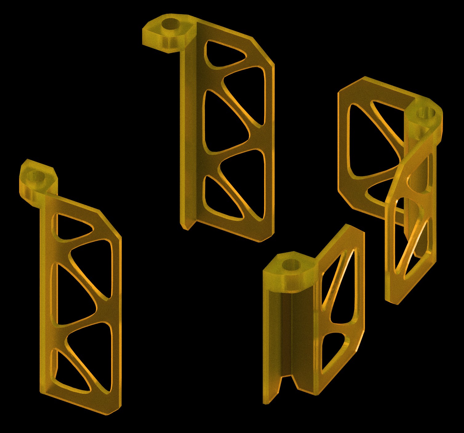

I’ve also included a few optional secondary parts you might want to print. Originally I planned to fully encapsulate the hardware in an organic protective shell, but because of the moving parts I had to simplify the design for now. I may attempt a more complete enclosure in a future revision. For now, these parts look great when printed in UTR Thermal resin or SLS aluminum.
