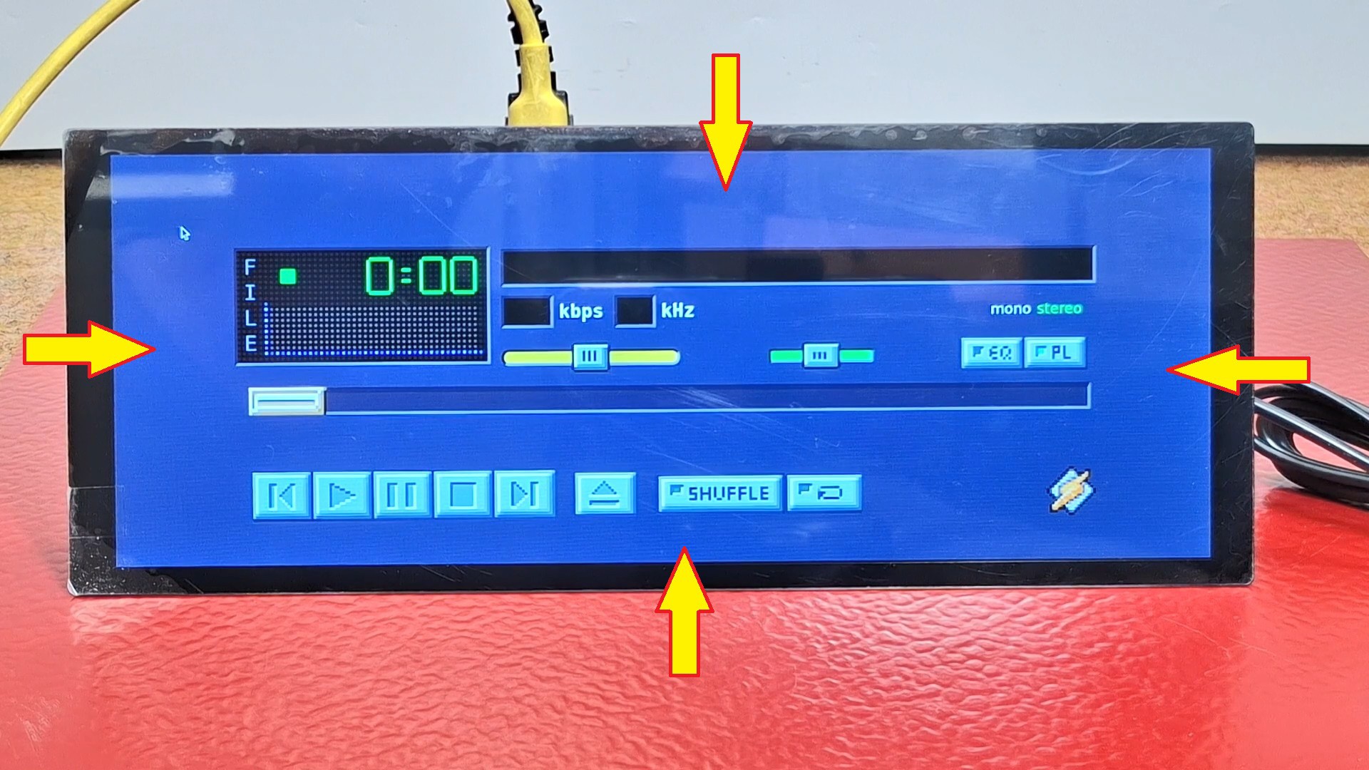

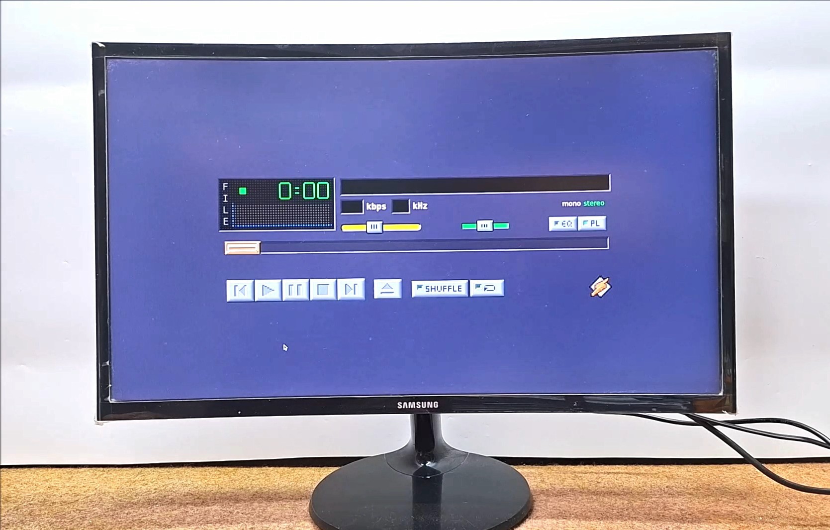

  Now it's time to connect the original touch display. We start the program in the same way as before. As you can see, Linamp does not cover the entire screen and there is empty space on all sides.
 The reason for this is the fact that the author created the program strictly for a resolution of 1280x400, and specifically on this display it is 1600x600. It is very simple to set the required resolution on this display.  We go to preferences - screen configuration, right click on HDMI - resolution. However, the required resolution is not here. In order for the required resolution to appear, we need to make certain changes to the OS kernel. For this purpose, the following procedure is used:

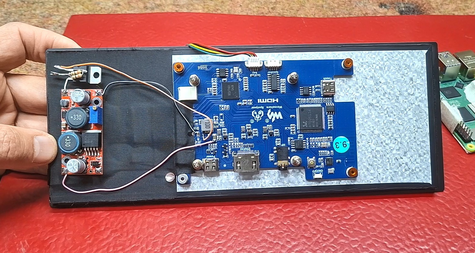

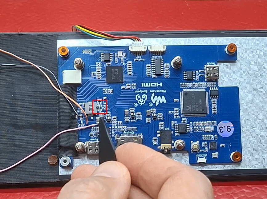

  After assembling and testing the device, I had a very unpleasant experience. Namely, out of carelessness, I mistakenly connected 12V instead of 5V and at that moment I smelled the smell of burnt electronic components. Raspberry Pi 5 was irreversibly damaged. On the display, I discovered a small SOT23-6 chip marked "LPS FtEf1" which was completely shorted and at the same time I could not find any information about it anywhere.
 Then, as a more elegant solution, I connected a cheap external BOOST converter module from 5 to 20V and with an LM317 I limited the output current to exactly 60mA. This way I got the display back fully functional (otherwise its price is around 100 Dollars.)

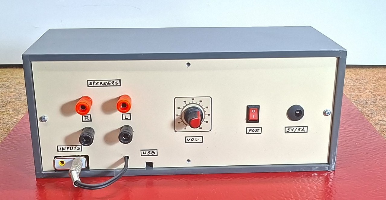

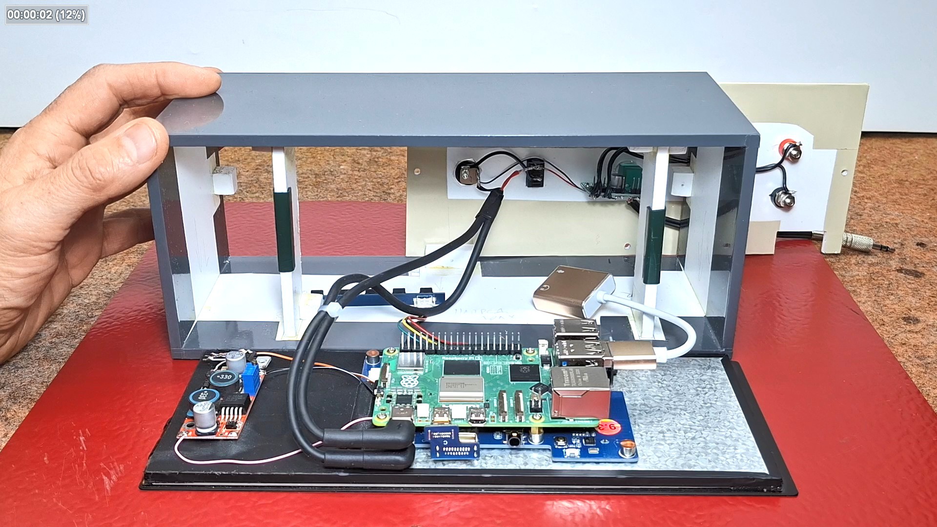

 Now it's time to install the device in a suitable box and demonstrate its functionality. For this purpose, I made the box from PVC material and covered it with colored self-adhesive wallpaper. This is what the finished product looks like. Inside is the Raspberry Pi 5 plus the HDMI touch display module, and on the back panel is a small stereo amplifier  module PAM8403, but of course a more powerful amplifier can be installed.
 It have the 5V / 5A input voltage connector as well as a small toggle switch. The volume potentiometer is part of the amplifier module. As I mentioned earlier, for the software to work on the Raspberry Pi 5, you need to add an external USB sound card with appropriate input and output connectors. Its output is connected to the input of the audio amplifier.

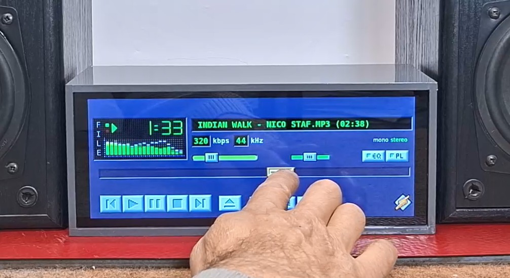

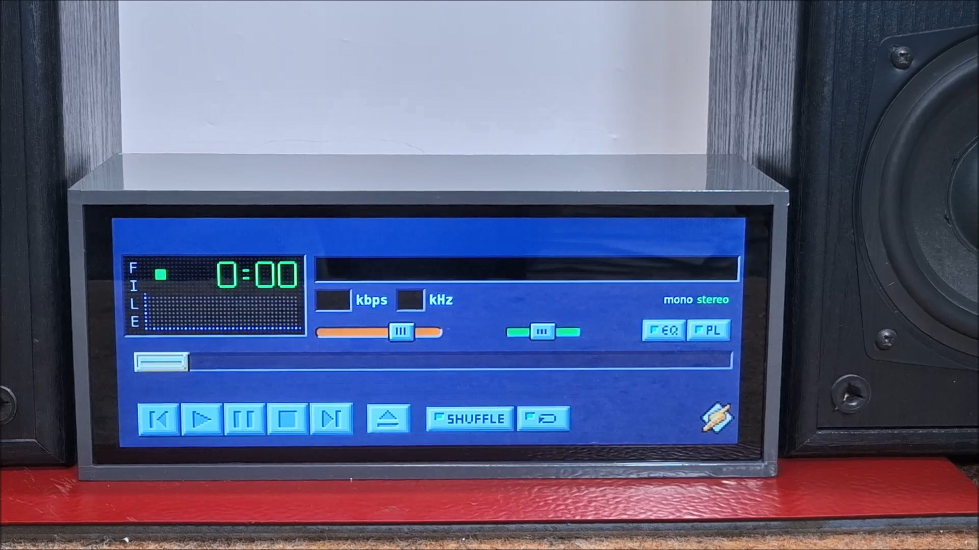

 I start the device with the small switch on the back and wait for the operating system to boot. It is very easy to adjust the option for the program to start automatically, but I left that part out so that I can gradually show you how to turn it on. It is easier to go to the LiNAMP folder and start the shell script there directly. This is what the active audio amplifier looks like with the Winamp interface.

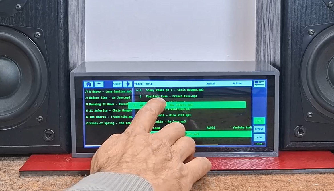

 All buttons, the slider, the volume and balance potentiometer, are responsive to touch. I connected two sound boxes to the output of the audio amplifier. The playlist button opens a window for sorting the playlist, just like in the original software. We need to select the folder with music and we can edit the playlist with drag and drop.
  When playing a song, the equalizer is active, and the long slider shows the duration and elapsed time of the song. Just like in the original, with this slider we can select the moment until which the song is activated.

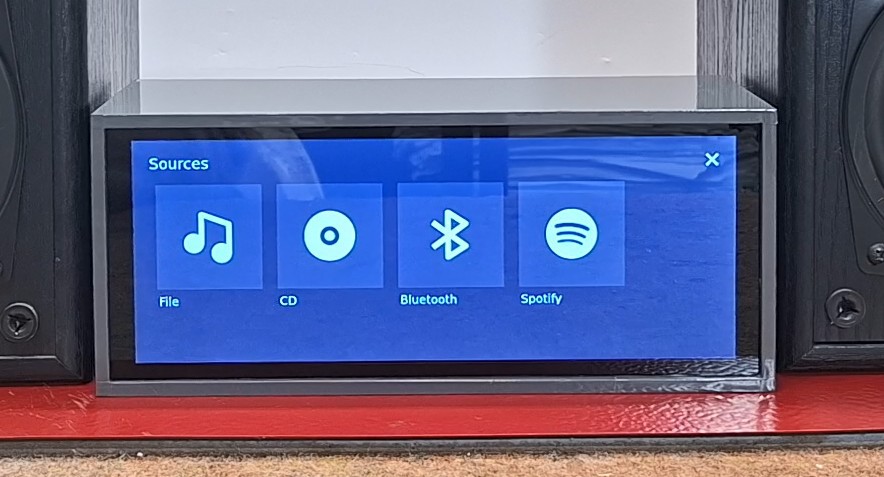

 As I mentioned earlier, all other functions are activated by touching the screen. By pressing the Winamp logo, we enter a menu where we can select one of four sources from which the sound would be emitted: File (that is  this particular case), external USB CD player, Bluetooth source, or Spotify.
