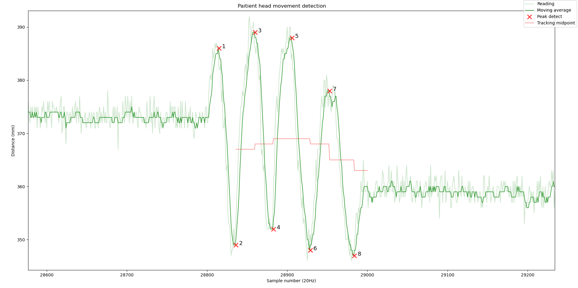

An ESP8266 collects measurements from a VL53L0X laser distance sensor, applies smoothing to remove noise, and looks for oscillation in the signal above a minimum magnitude. When the required number of peaks are detected, an optocoupler is used to "press" the external door bell remote button by completing its path to ground.
This approach achieves a strong signal, even with only a few centimetres (~1 inch) of head movement:
Graph of head movement detection showing an strong oscillation signal against a noisy baseline.
Peaks 1 and 2 are tracked silently. Peaks 3, 4 and 5 produce an audio-visual cue, and peak 6 rings the external door chime. Peak detection resets after a number of seconds, allowing the user to cancel a sequence by holding still.

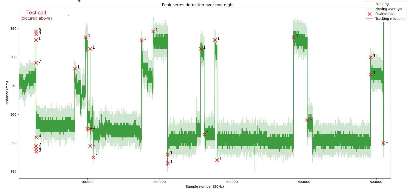

This setup allows for normal movement during sleep. Over the course of a night, re-positioning is detected, but does not form a sequence:
Full night of pattern detection, showing no unintended triggers
Over more than 300 nights this has never produced a false alarm, but is easily set off by the user when they intend to.

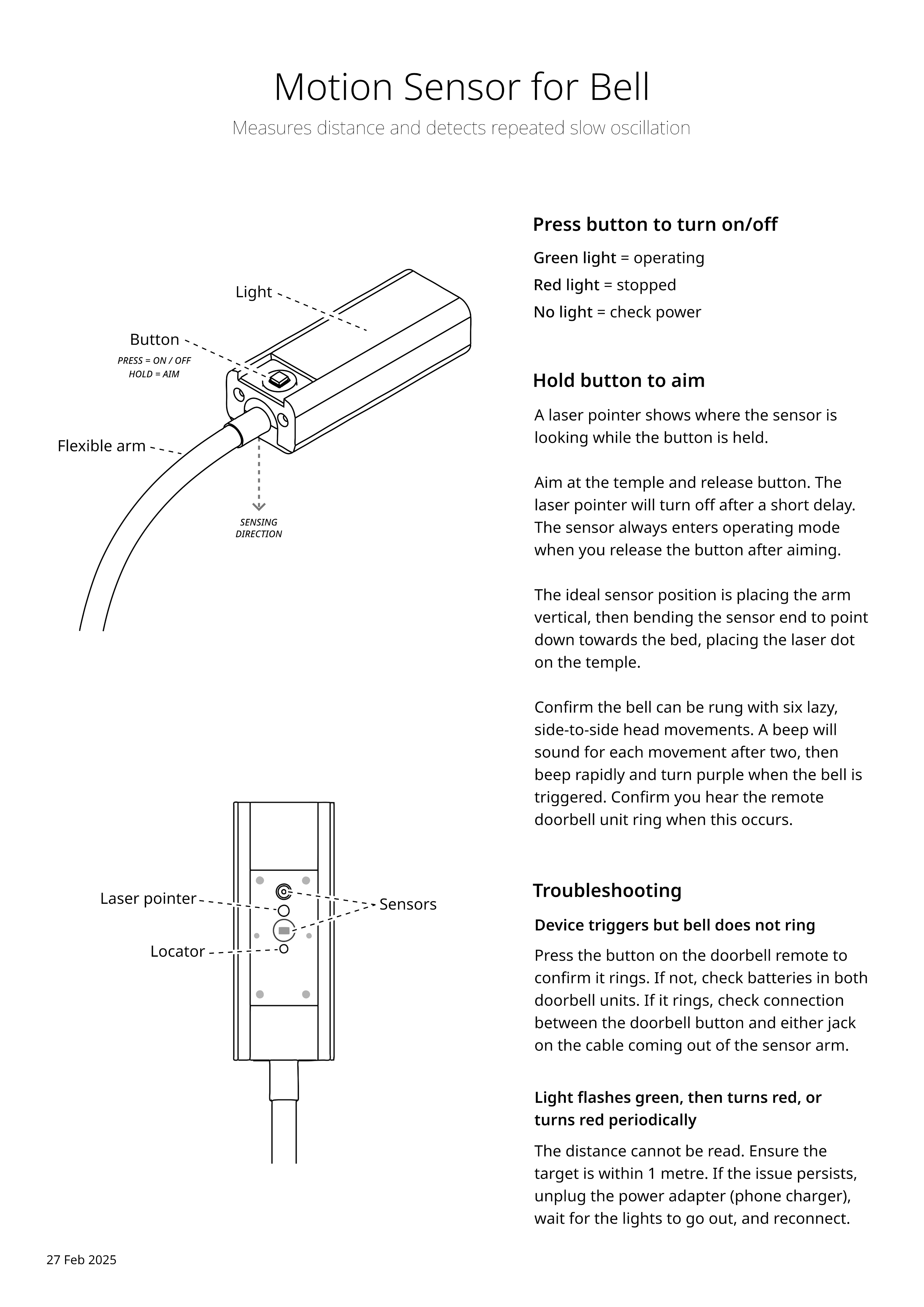

Operation by staff
The device was designed to be robust and simple enough for a team of care staff to use and handle daily. I produced this help sheet to go on the wall by the bed:

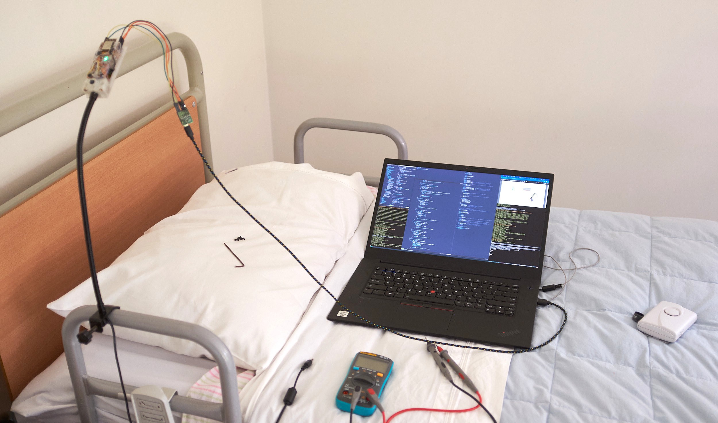

Motion sensor device on medical bed with development laptop
The device in place during initial testing and installation, with debug connection to a laptop.
Exploring this person's range of motion, we had identified head movement as their strongest signal. Speaking was muffled and complicated by noise from a BiPAP (breathing) machine. Blinking and eye movement were possible, though more complex to measure. Other motions were limited or tucked under blankets at night, making them harder to work with.
