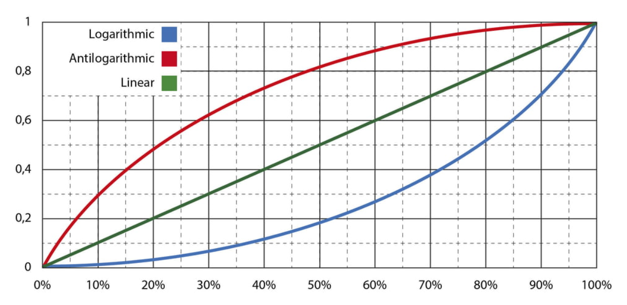

In my
implementation, I placed great emphasis on good gamma correction so that the brightness curve appears as linear as possible. For
this purpose, I created logarithmic correction tables that counteract
the inverse logarithmic brightness perception of the eye and
compensate for it.
Fechner's law states that the subjective sensation is proportional to the logarithm of the stimulus intensity. According to this law, human perceptions of sight and sound work as follows: Perceived loudness/brightness is proportional to logarithm of the actual intensity measured with an accurate nonhuman instrument. [Wikipedia]
These correction tables cover all 256 brightness values, which is obviously excessive when only 15 steps are displayed. I use this type of gamma correction in all my projects and had already calculated the tables.
Without gamma correction, the brightness increases very quickly at the beginning with a linearly increasing PWM duty cycle and then changes only very slowly later on – pay attention to this, unfortunately you can see this poor dimming curve everywhere. The impression for the human eye in this case is shown with the red curve.
The blue curve shows how the PWM duty cycle increases with evenly rising brightness setpoints: very slowly at first, then faster and faster.
The perceived brightness impression can finally be seen in the green curve - ideally completely linear.
Unfortunately, this perception depends on many environmental factors such as external brightness, color, and probably also on the individual.
