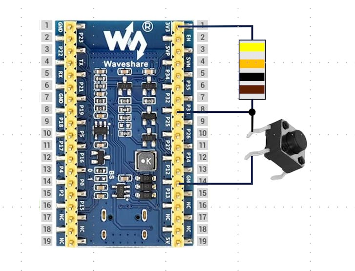

E-ink Display + Driver BoardGPIO 33 of the module must be connected to a push button, that pulls 3.3 Volt to ground, like shown in the pictures below:
Device Button
The button is used to switch between screens, reset the device, or trigger user-defined functions.
