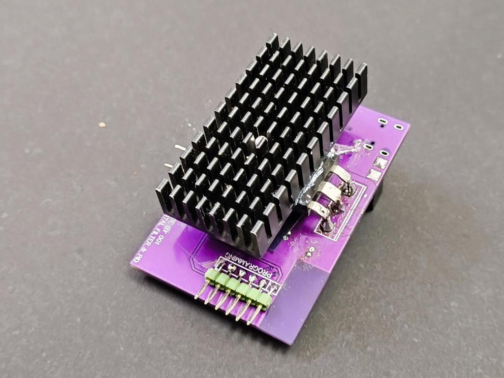

Electronic load V3:
I used a low-value shunt resistor to minimise the drop across it. I have used a PCB mount heatsink on the transistor. To display everything and control this load easily, I have designed a web server and integrated all the current monitoring there. It is still powered by 12V, and an ESP8266 is used for controlling the load. Moreover, I reduced the BOM cost, and after testing, I modified the design slightly; the PCB design is attached below. This can work fine up to 30 watts in continuous current mode, which is more than enough for testing single-cell batteries and USB PD ICs.

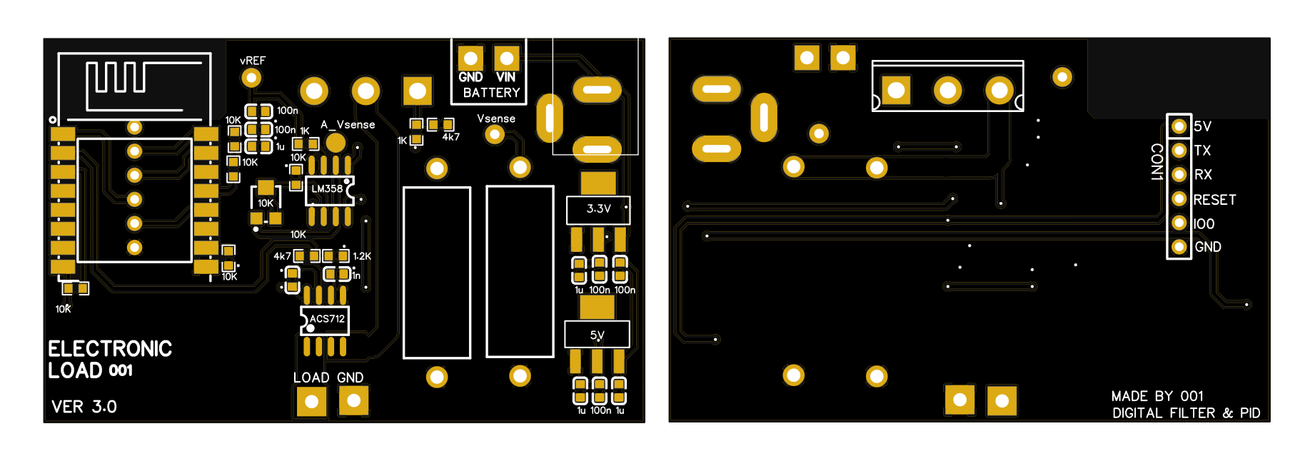

Circuit Description:
So, I have made the circuit in different sections, with the input on the left top and the outputs on the right side. The input section contains a USB-C input, which is later charged with a 12V DC jack, and some decoupling capacitors for the LDO AMS1117 3.3V. The second section consists of the MOSFET and control block, where the comparator serves as the MOSFET driver, and the MOSFET is connected in parallel with two 0.33 ohm resistors.
The third section is the PID feedback and current sensing section, which provides actual current data to the ESP8266. The block below has the main microcontroller with programming headers. Some resistors are used to make a minimal system. The microcontroller operates at 3.3V and generates the PWM at the same level (here limited by current, in future we can increase resolution). Then, some filters are used below to make the PWM output as smooth as possible.
I have added a potentiometer in order to adjust the gain of the DC amplifier, so you can tune it as per requirement when calibrating the system. The calibration in the code is performed according to the Vref. Here is the real calibration data I have used in mine:
PCB Designs:
I aim to mount the heatsink either on the PCB itself, but using a rectangular PCB and mounting the heatsink on the transistor at the bottom layer is a perfect option. In this way, I can keep the heat away from the PCB and my control section works normally as expected. On the PCB, I have placed the DC inputs on the right side, along with the LDO and decaps. The main transistor is mounted on the back side of the headsink, in the middle.
And all the control parts are with the microcontroller on the right side. I have routed the 2mm for high-power traces and standard 10 mils for all other traces. The main output pads on the front middle side are exposed with larger tinned copper. PCBs do not have any high-speed sections, so there is no need for impedance matching. I used GND copper fills on both sides in order to reduce any noise from the ACS or op-amp.

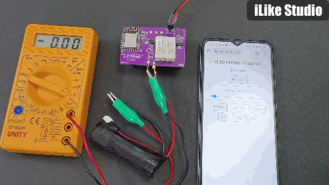

Just upload the code through the Arduino IDE, selecting ESP8266. Programming headers are provided on the bottom layer. For coding-related tasks, follow this article: How to program ESP8266 in Arduino IDE. After uploading the code, open the Serial Monitor with a baud rate of 115200. The serial monitor will display an IP address. Open the IP in the browser connected to the same network. The server contains a slider and real-time current values flowing through the output feedback from ACS712 (part under construction). The set value is compared to this output feedback, and PWM is automatically adjusted. In the extras, we have some quick buttons to set the current.
Calibration:
Step 1: For calibration, first note the voltage across the current sense resistors using a multimeter. Use this setup to note the voltage (Vsense); the current should be precisely 1A, controlled by varying Vgs.
Step 2: Note the voltage output from the PWM filter after adjusting the slider on the HTML webpage. Now, set the current to 1A through the slider and note the voltage of the PWM, which we called vREF.
Step 3: Vsense < vREF, and we need to make both voltages equal; that's what the op-amp does.
Step 4: After this step, the setup now works fine, but we can fine-tune the voltages and slope of the current. The code itself provides the calibration number for this here.
Working and Testing:
After all the calibration, it is ready to test. Simply connect the DC barrel jack and start using it. With the power off, the device enters reset mode and starts from zero to address safety issues. We can control the PWM directly from the web server, and the current is monitored there only. Keep in mind that the current sensing resistor wattage should be sufficient to sustain high current. The maximum allowable current is 2.5A in the web server; it can be increased if a bigger heat sink is used. If the transistor heats too much at the higher current value, derate the maximum current from the slider; otherwise, burns may occur.
