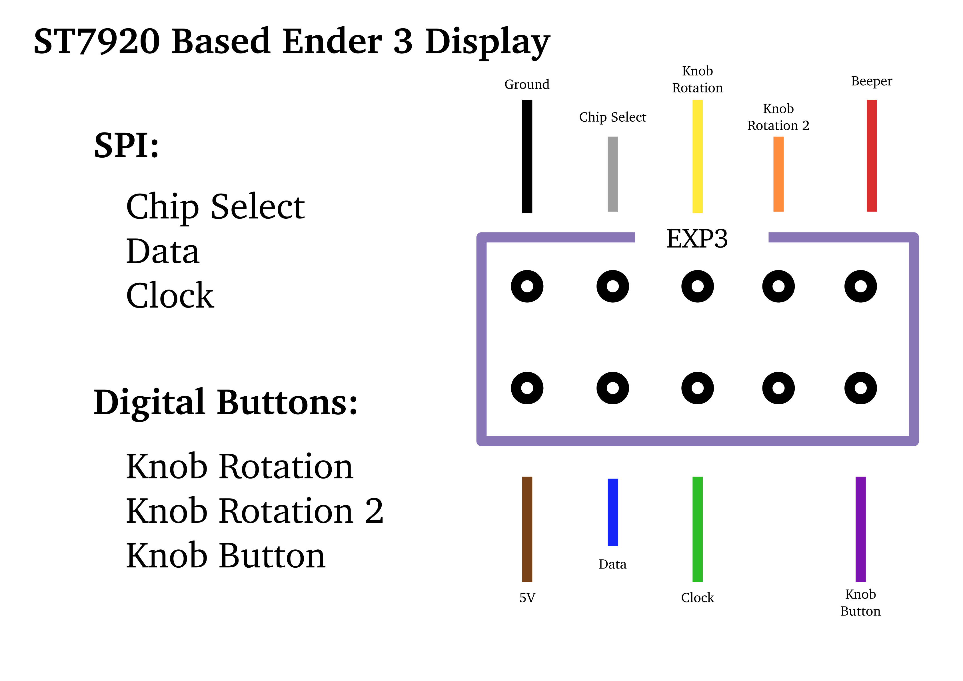

    If screen is scrambled switch pin D13 and D11.
    -RR
  • ST7920 Pin-Out
    Rhea Rae5 hours ago 0 comments
    Use EXP 3 Header!
    -RR
  • Ender Clock-Duino v1.0 Sketch
