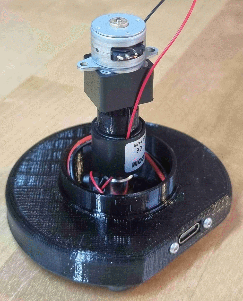

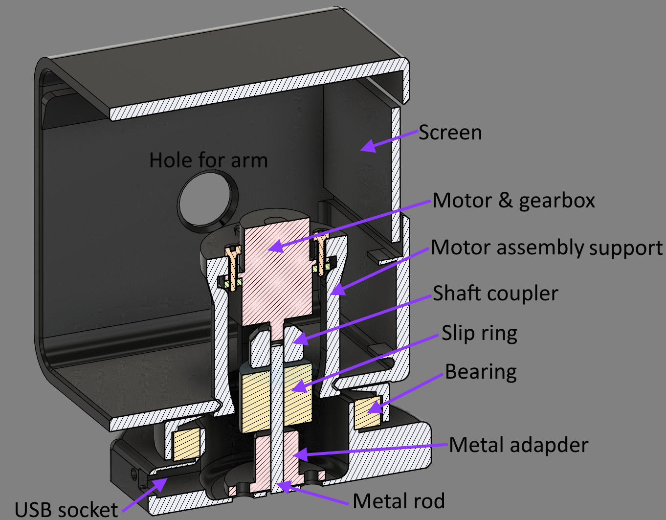

Here is internal view
There is one big bearing, metal shaft on which the motor sits. The hollow slip ring goes around the shaft.
Here is the view of motor and slip ring assembly

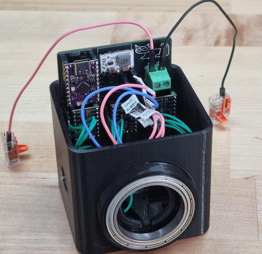

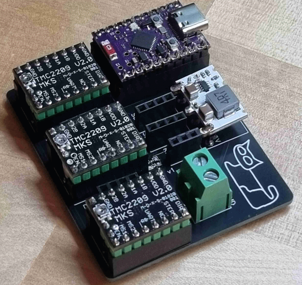

Inside there is a simple PCB that connects together the ESP32-C6, 3 TMC2209 drivers and a tiny dc-dc converter to step down a voltage from USB to 3.3V that is used by the screen and radar
Please note the cute cat drawing on the pcb. Here is the photo of three stepper motors fit inside before pcb was put and place
