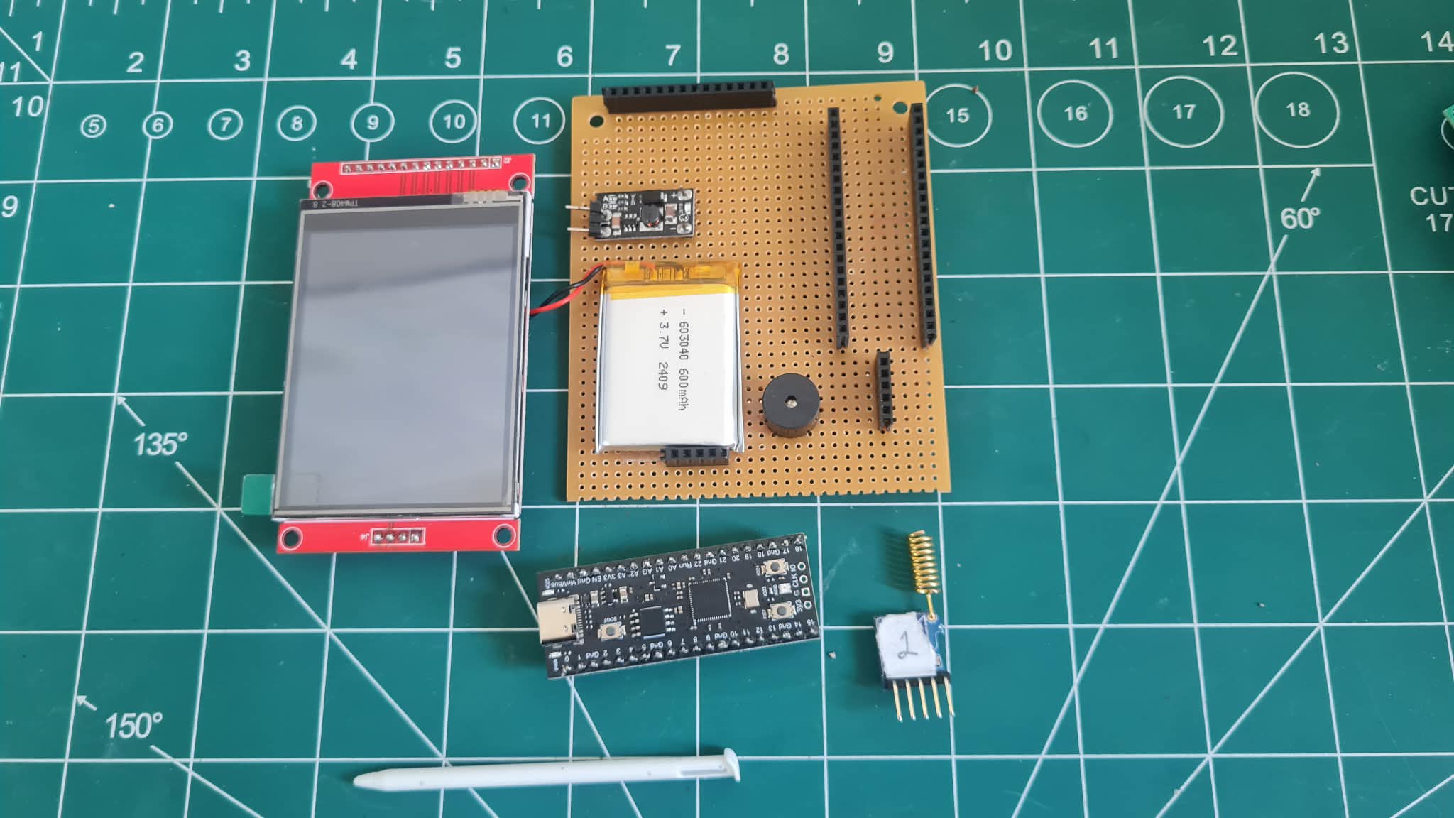

Supplies
PICO2 (RP2350A) x2
RYLR998(LoRa) x2
ILI9341 x2
PIN HEADER 40 x2

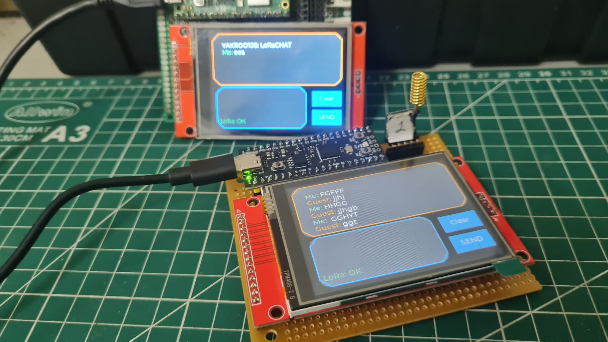

Step 1: Concept Overview
CyberMesh LoRaChat is a peer-to-peer text messaging system built on LoRa (Long Range Radio) technology. Each device operates as an independent node capable of sending and receiving messages directly from other nodes.
There is no gateway, no cloud backend, and no single point of failure. Even if part of the network becomes unavailable, remaining devices can continue communicating.

Step 2: System Architecture
Each CyberMesh LoRaChat node consists of:
- Raspberry Pi Pico 2 – main controller
- ILI9341 TFT display – user interface
- LVGL – graphical UI framework
- MicroPython – firmware development
- RYLR998 LoRa module – long-range wireless communication
Users can type, send, and receive short text messages through a simple on-device interface, similar to a basic chat terminal.

Step 4: Power & Reliability
CyberMesh LoRaChat is optimized for low power usage:
- LoRa minimizes transmission energy
- MicroPython code avoids unnecessary background tasks
- Can run on batteries for extended periods
This makes the device practical during prolonged outages.

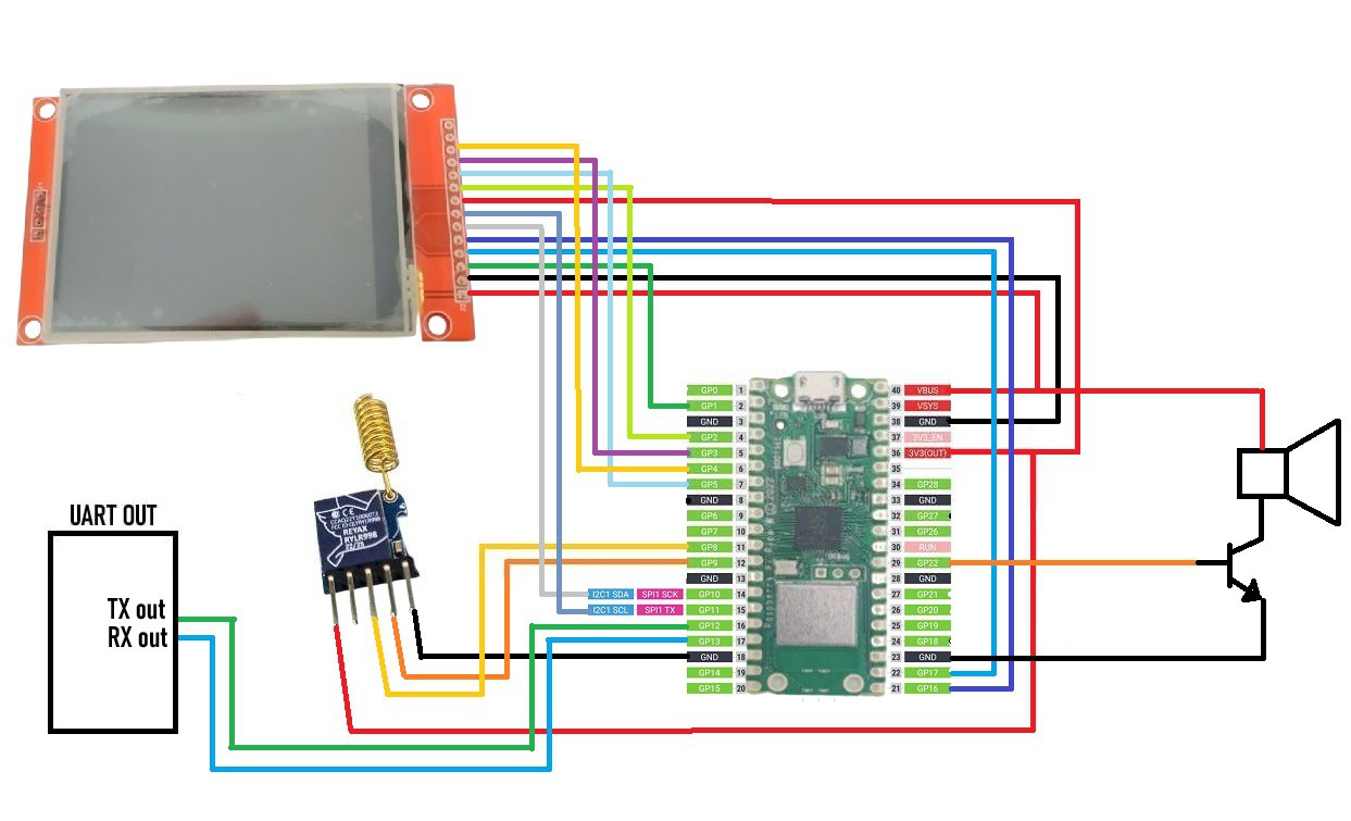

Step5:Circuit
