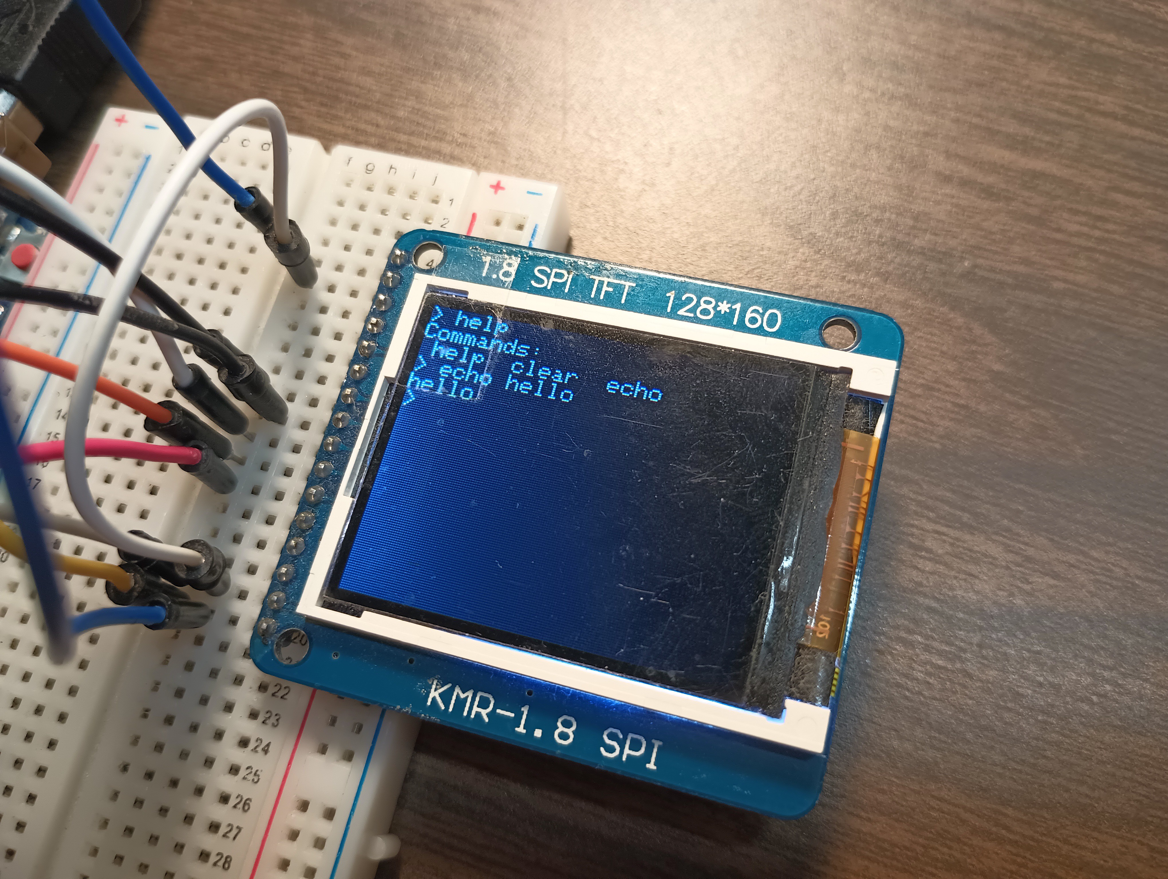

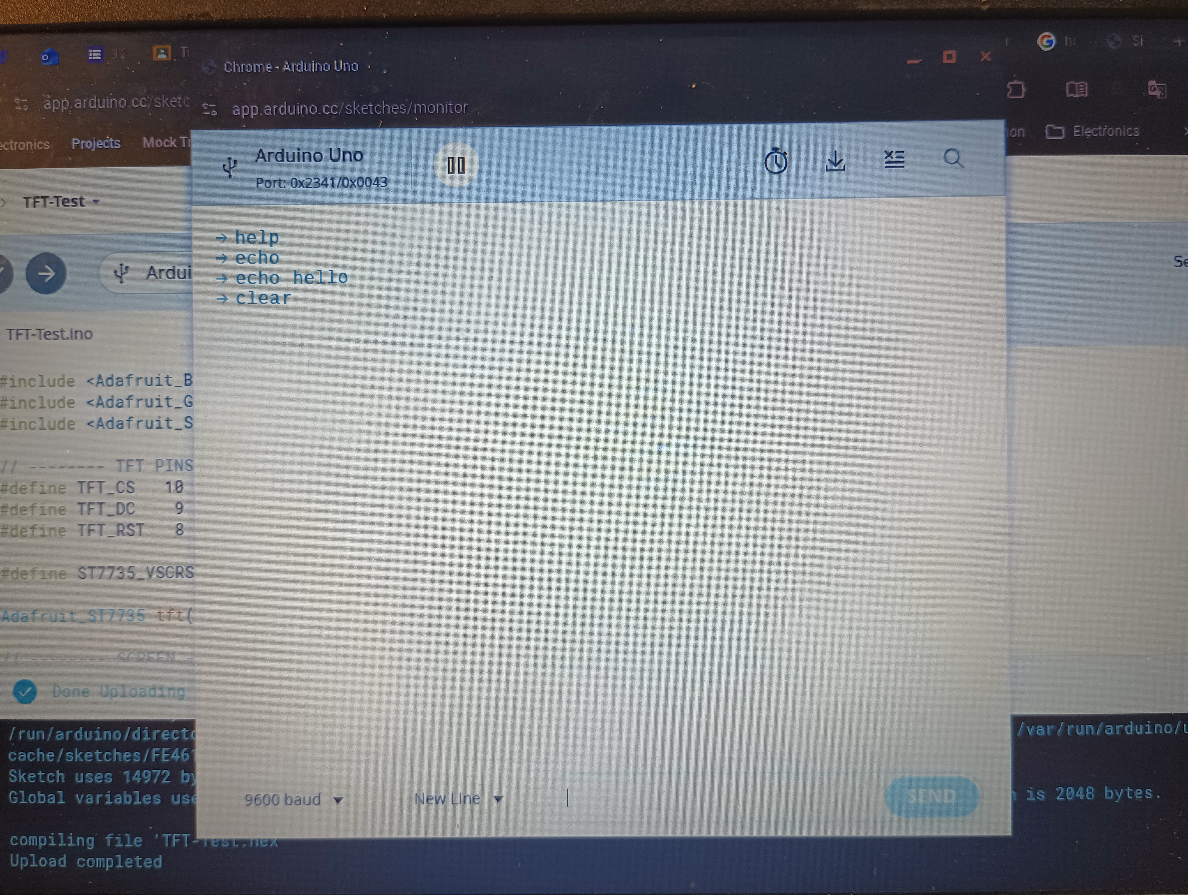

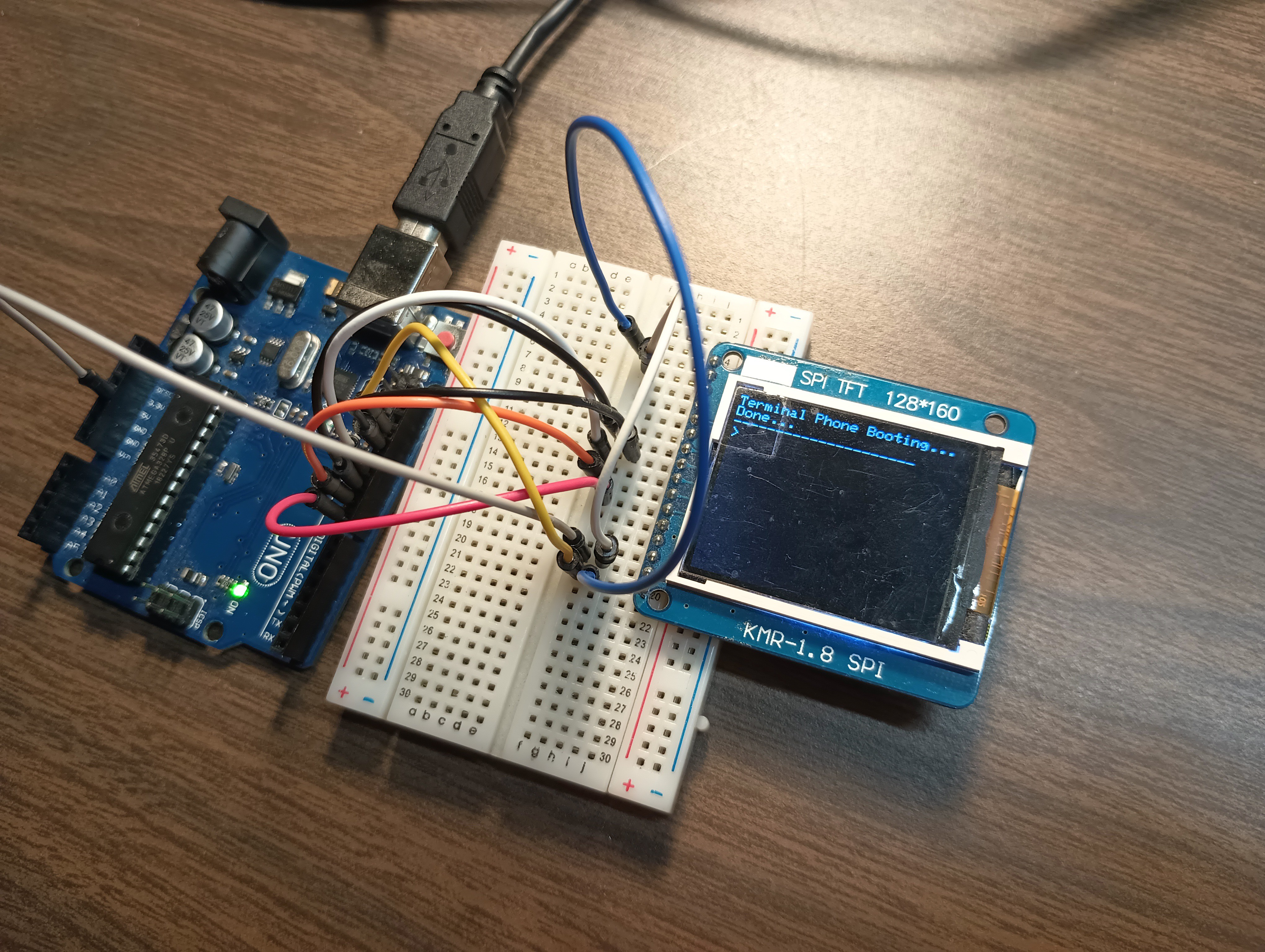

    The Setup
    1.8" Color TFT LCD display connected to Arduino UNO which receives text input from the serial port.
    Here's some images:
    So now when I type some commands into the serial port, they run on my terminal. I only have three commands right now: help, clear, and echo.
    It really feels cool!

    • Right now I am using serial port for text input. I am trying now to prototype a matrix keyboard to test text input.
    • The UNO has limited really resources, especially RAM. This means that refreshing a 128x160 TFT display can cause some flashing and lag. I'm deciding to move to ESP32 or similar microcontroller with more resources

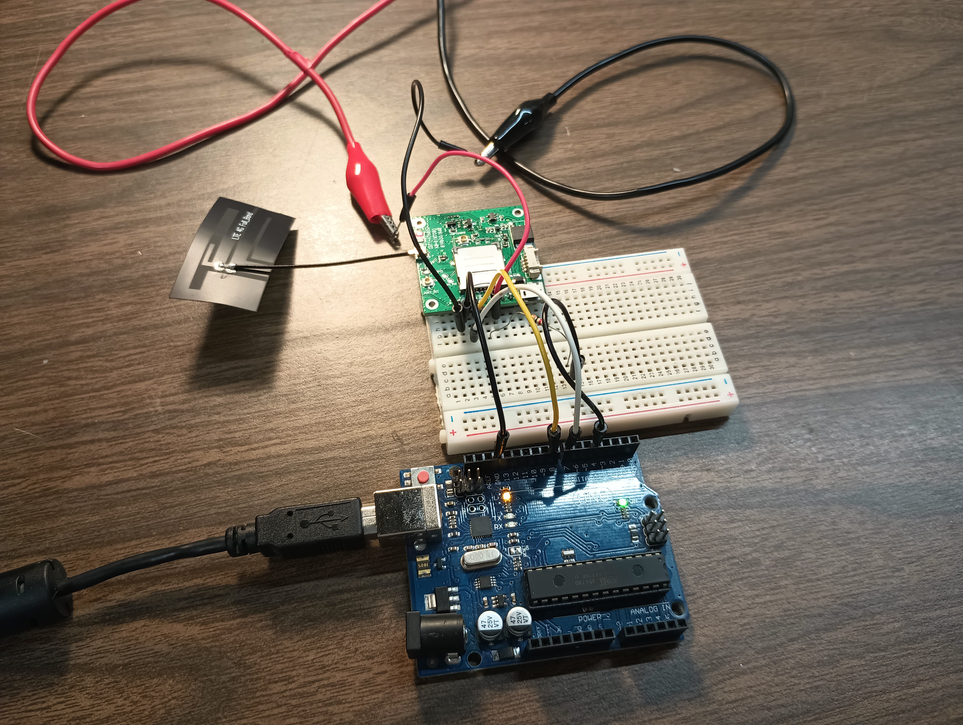

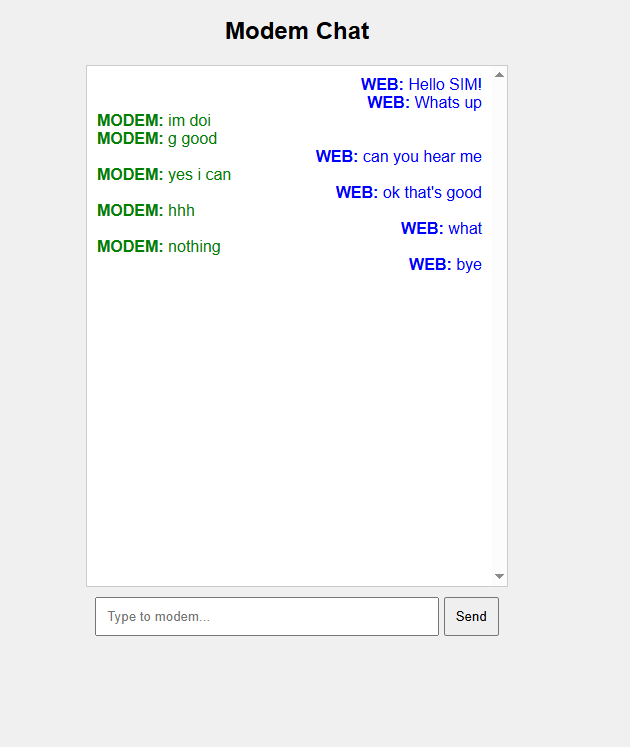

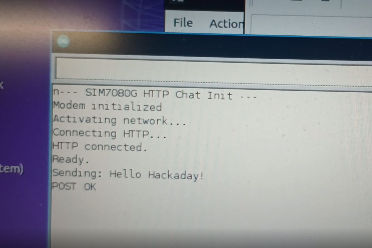

    After a few days of work (there was a problem with activating the SIM card), I have a fully functional web-based interface to communicate with my modem!
    How it works
    My setup:
    1. Arduino connected to SIM7080G modem module which allows communication of serial port with modem, through human readable chat format (not AT commands).
    2. A website hosted by Pythonanywhere of a simple chat interface
    3. The modem communicates with my website through HTTP GET and POST requests.
    Here are some images of the setup:
    This is the web interface:
    Here is the hardware setup
    Here is the serial port of arduino:
    Here is the link to the code: https://github.com/bolanxu/Terminal-Style-Cellular-Device. (Look at the Web-Based-Chat-Interface branch.)

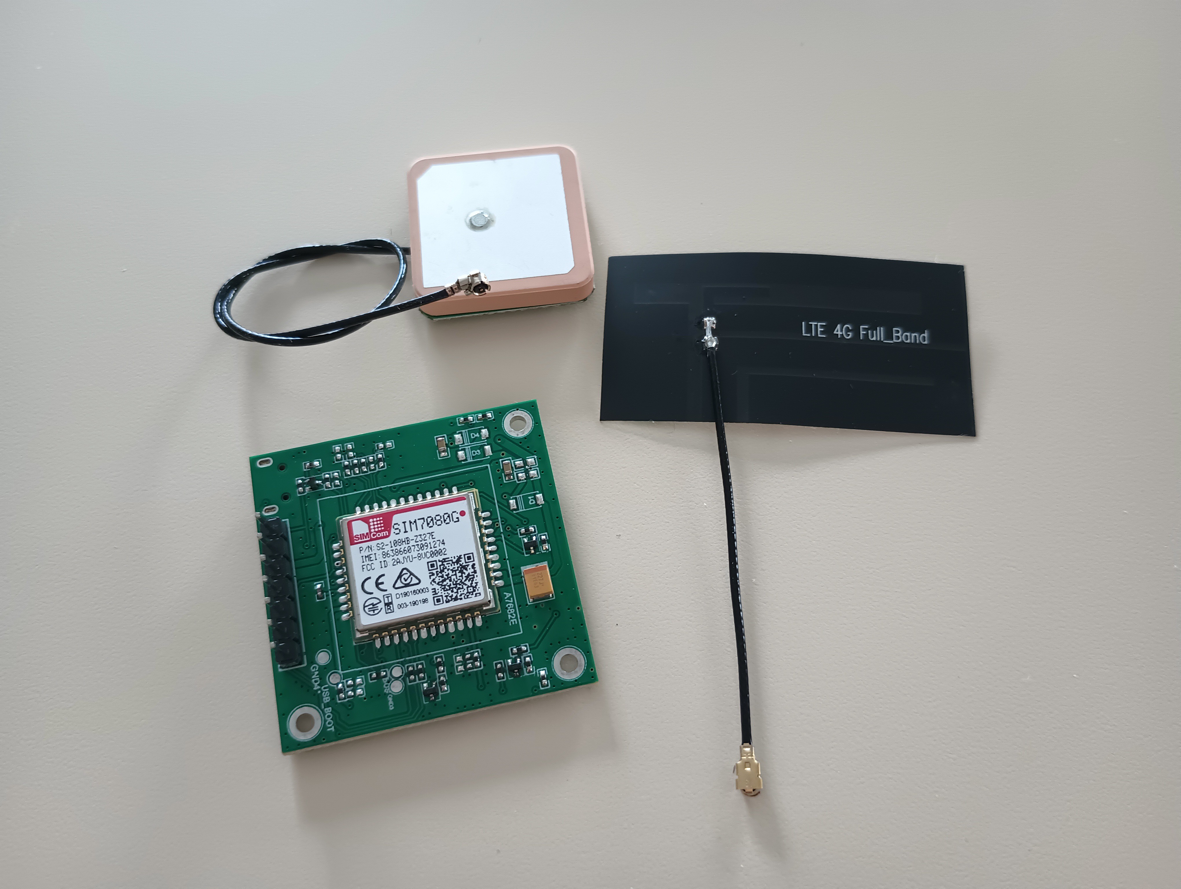

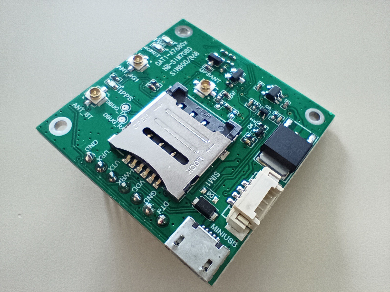

  • SIM Modem Has Arrived!
    Bolan Xu01/27/2026 at 17:43 0 comments
    After a week of anticipation (AliExpress is slow 😅), the SIM7080G modem has finally arrived. Time to do some testing!
