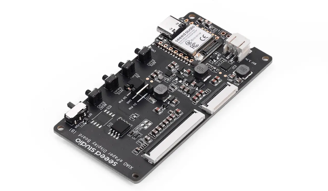

One of the most interesting driver boards I’ve tested—thanks to its rich set of features—is the EE04 from Seeed Studio, and that’s the one we’ll use in the example projects. So, the next step in our journey will be to take a closer look at its features and capabilities.
The EE04 Board
The EE04 is one of the EPD controller boards offered by Seeed Studio. In addition to supporting a wide variety of displays, the EE04 features excellent wireless connectivity, multifunction buttons, and all the circuitry needed to create battery-powered applications.
The brain of the EE04 is a XIAO ESP32-S3 Plus module, which has enough power to develop everything from the simplest to the most complex applications. Like all XIAO modules, the ESP32-S3 Plus can be programmed in different languages, such as Arduino or MicroPython.

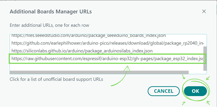

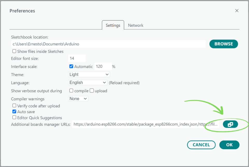

With the IDE installed, you have to add support for the XIAO S3 Plus through the Board Manager. This is a straightforward process. First, open the IDE preferences by selecting File and then Preferences from the menu (or press Ctrl + ,), and click the icon shown in the image:
In the Additional Boards Manager URLs window that opens next, add the following address and click OK:
https://raw.githubusercontent.com/espressif/arduino-esp32/gh-pages/package_esp32_index.json
Click OK again in the Preferences window.

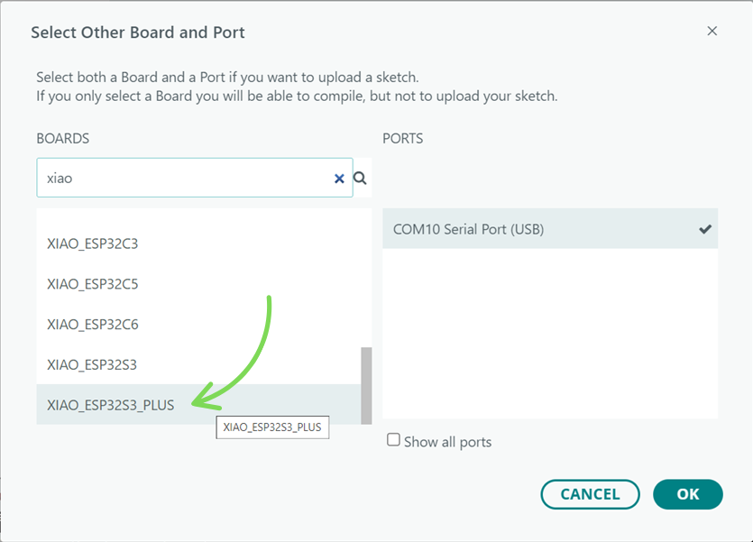

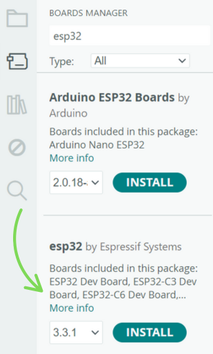

Now, in the toolbar on the left side of the IDE, select the Board Manager. In the search box, type “ESP32.” You’ll see the installer for the package that supports various ESP32-based boards. Click INSTALL.
After a few minutes of downloading and installation, the IDE will be ready to program the board.
Connect it with a USB cable and select the board and the port using the selector at the top left:
Click OK and you’re done! Your Arduino IDE is now ready to program the XIAO ESP32-S3 Plus.

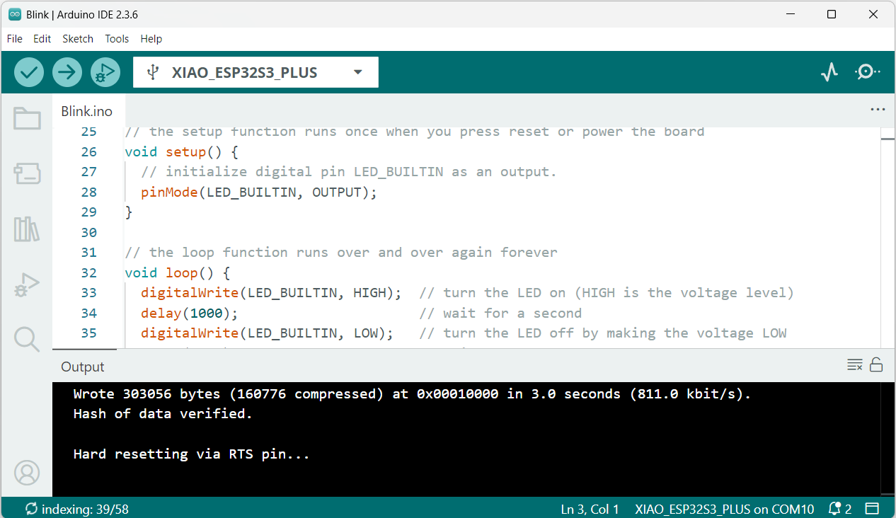

It’s a good idea to check if everything is working correctly by uploading a sample program.
To do this, go to the menu, select File → Examples, and choose Basic → Blink.
A new window will open with the test code that makes the onboard LED blink every second. Click the UPLOAD button, and after a few moments, the LED should start blinking.
Congratulations!
You’ve just taken the first step by getting the IDE ready to start programming the EE04 board.

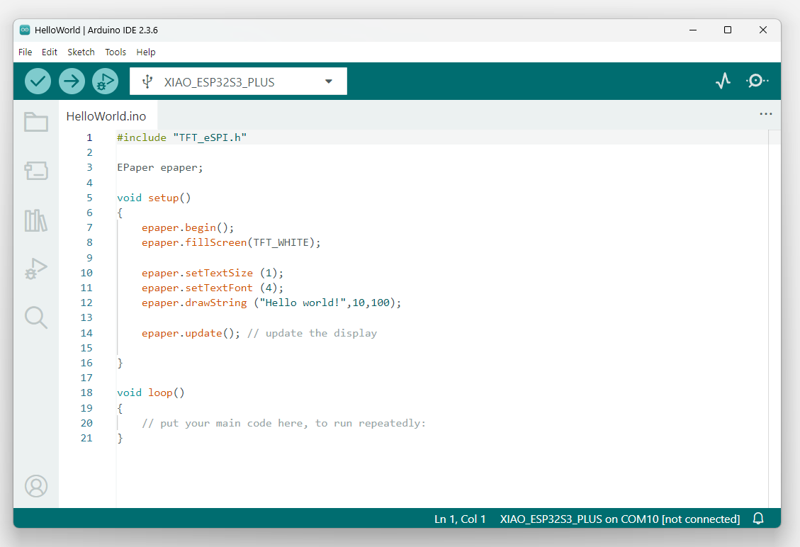

Below is a complete example program that displays “Hello world!” on a 5.83-inch monochrome display using Seeed_GFX:
The advantage of using a library like this is obvious: in less than 10 lines of code, you can initialize and clear the display and show text with a specific font and size. Plus, the code is portable, since with just a few configuration changes, it can be adapted to different displays and controller boards.
The details of how it works will be covered later on in the example projects.

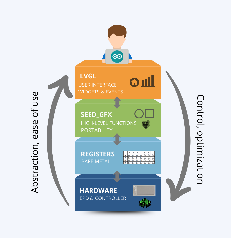

GUI Frameworks
When working with EPD displays, a big part of the job is designing the graphical user interface (GUI). In addition to basic graphics libraries, there are specialized GUI frameworks that make this task much easier. One of the most popular is LVGL, which can run on resource-limited devices like the ESP32. LVGL handles the display of graphical elements (widgets) and manages user interaction through buttons or touchscreens.
LVGL does not control the EPD directly. Instead, it renders all the widgets to a memory buffer, which then needs to be sent to the EPD using another library, such as Seeed_GFX. LVGL acts as a software layer on top of the driver library and relies on its capabilities.
Each additional layer provides more abstraction than those below it, making tasks easier and hiding hardware details. On the other hand, you also lose direct control over the internal operation, which can reduce the level of optimization.

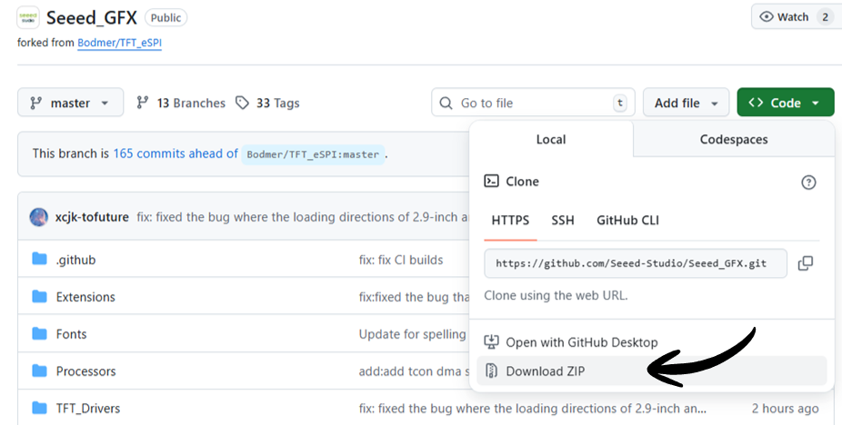

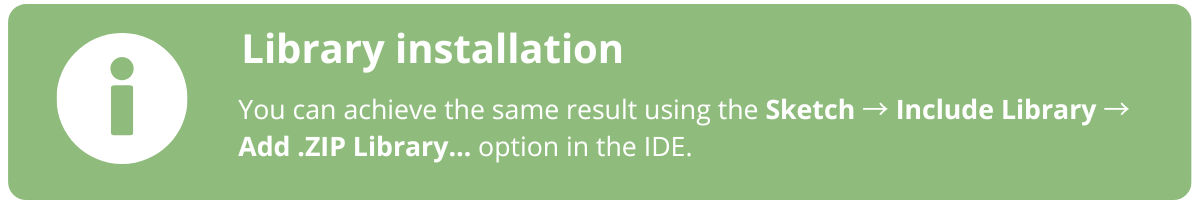

The installation process is super simple: just download the compressed file from the official repository and extract it into the IDE’s libraries folder.
To download it, go to the repo (https://github.com/Seeed-Studio/Seeed_GFX), click the Code button, and then choose Download ZIP.
A compressed file named Seeed_GFX-master.ZIP will be downloaded.

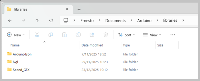

Next, you need to extract this file into your Arduino IDE’s libraries folder.

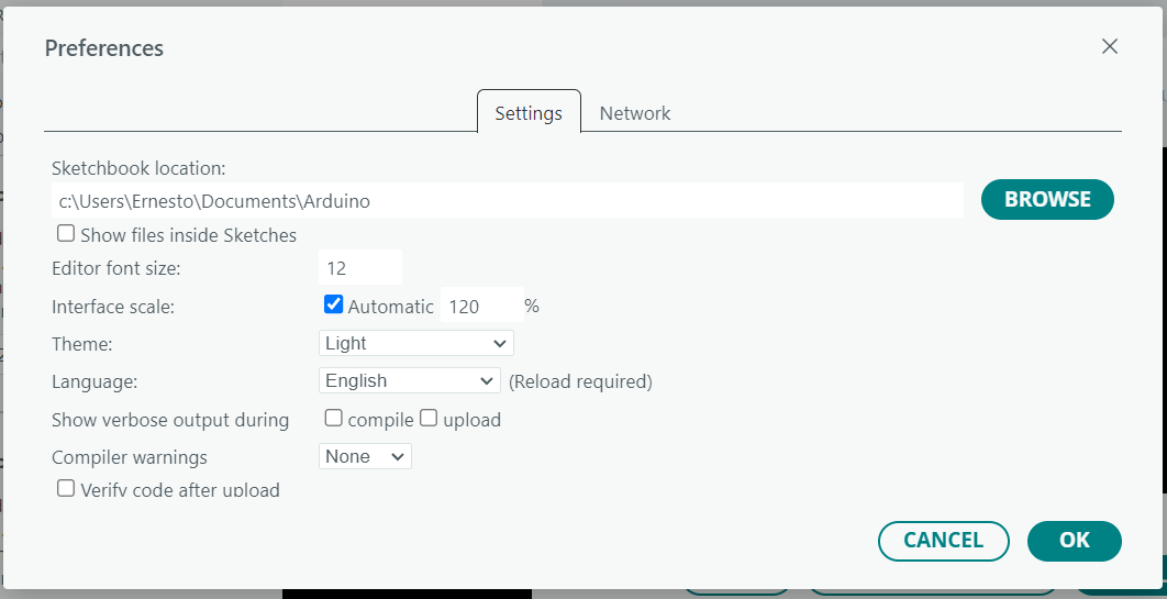

If you’re not sure where that is, open the Arduino IDE, go to File > Preferences, and look for the path shown under “Sketchbook location.”
Extract the library into a folder named Seeed_GFX inside the libraries folder you found in that path.

Take a look at the following code. It’s a simple example that shows the text “Hello” at a specific position on the screen:
#include "TFT_eSPI.h"
EPaper epaper;
void setup()
epaper.begin();
epaper.fillScreen(TFT_WHITE);
epaper.drawString ("Hello",10,10);
epaper.update(); // update the display
void loop()
// put your main code here, to run repeatedly:
The first thing the code does is include the TFT_eSPI library, which is the base for Seeed_GFX.
Then, it creates an object called epaper from the EPaper class. This object will be linked to the display, and it’s the one you’ll use to call all the methods to interact with the EPD.
After that, there are a few instructions inside the setup() function:
- begin: Initializes the display, sets up the connection with the EE04, and prepares all internal structures and buffers.
- fillScreen: Fills the display with white pixels (TFT_WHITE).
- drawString: Writes the text (“Hello”) at a specific coordinate.

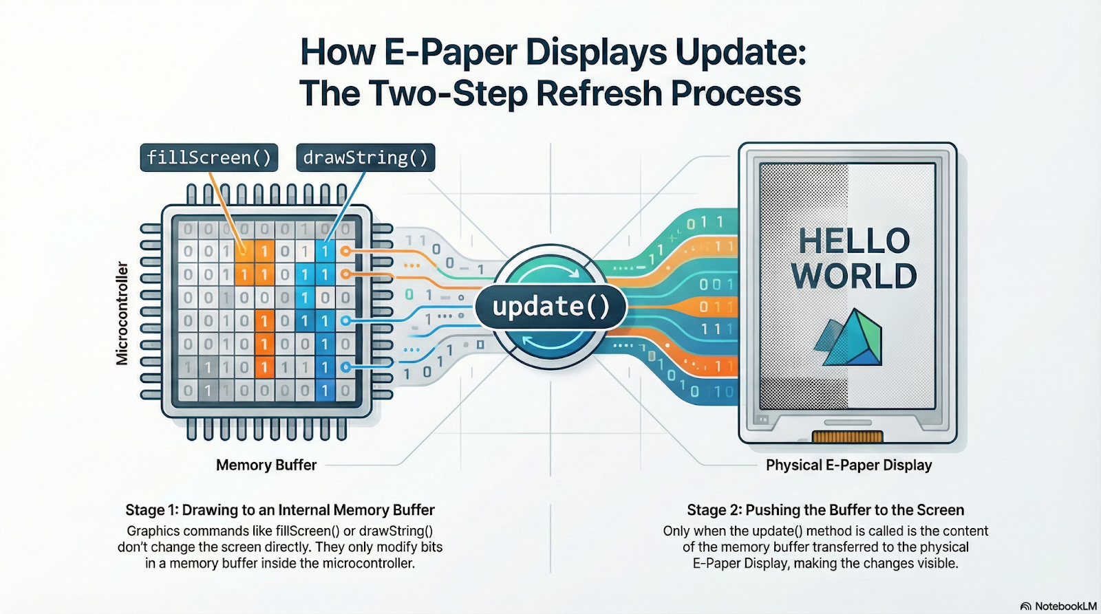

- update: Refreshes the screen to show the result of all the previous methods. This last step is crucial to understand.
Unlike an OLED or LCD display—where each graphics instruction is immediately visible—on EPDs, functions like fillScreen() or drawString() only affect an image buffer stored in RAM (in this case, on the ESP32 of the EE04 board).
These operations change the buffer without affecting what’s actually shown on the screen. Only when you call update(), the buffer’s content gets transferred to the display and the image is physically updated.
The update() function triggers the EPD refresh process, which means that millions of tiny particles physically move inside the panel to form the new image. This movement takes time (sometimes several seconds), and while it’s happening, the display can’t process new instructions.
That’s why EPDs have a special BUSY pin. The library (such as Seeed_GFX) uses this pin to check whether the screen is still updating. Before sending a new command—like updating text or drawing a new image—the library polls or checks the BUSY pin to make sure the display is ready. If it doesn’t wait, commands sent during the refresh process may be ignored or can even cause visual glitches.
