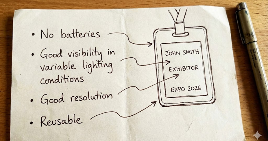

Since you’re known for being a curious maker with some tech skills, they come to you with the challenge and share a list of requirements for the project:
The moment you read the first requirement, your first thought is: "That’s impossible!" Every electronic component needs some form of power—especially displays, whether they’re LCD, OLED, or any other type!

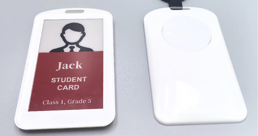

Commercial Epaper Badges
These kinds of devices already exist commercially under different names, like smart badge, work badge, or ePaper badge. If you look them up online, you’ll find plenty of options available.
Compared to traditional cardboard or plastic name tags, ePaper badges have several key advantages: you can easily update the information, reuse the same device as many times as you want, and even display extra details—like the wearer’s photo, a QR code, or any other relevant info.

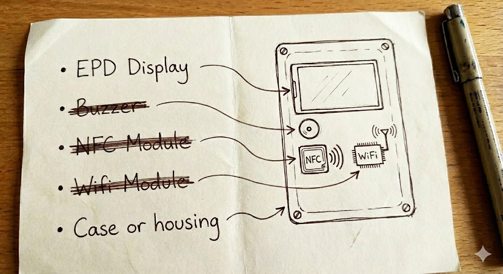

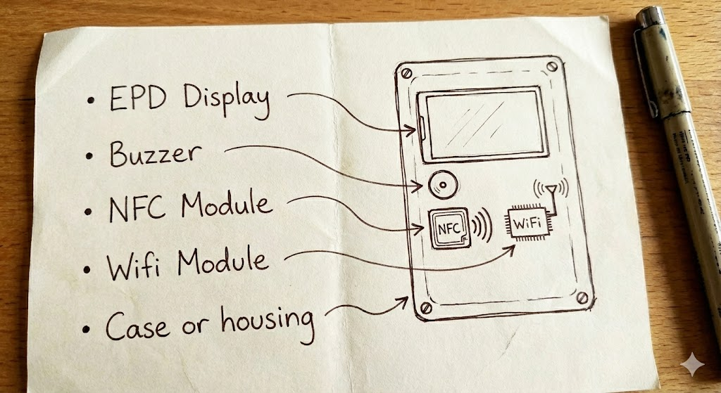

Let’s put together a preliminary list:
But hold on a second—A buzzer might be useful, but there’s no battery to power it.
NFC was rejected because of the cost, and WiFi also needs a battery and a CPU to control it, so that’s out too.
Let’s cross all of those off the list.
So, what are we left with? An EPD inside a case.
