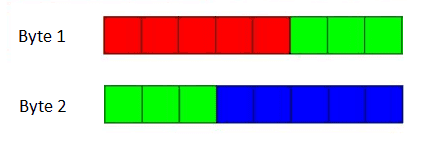

The format works as follows: in each byte, the upper nibble (bits 4..7) holds the color code for the first pixel, and the lower nibble (bits 0..3) holds the color code for the second pixel.
On a 4-color EPD like the one we’re using in this project, these values are used to represent each color:
You might have noticed that, to encode four color levels, only 2 bits per pixel (2 bpp) would be necessary—instead of four. And you’d be right! However, the designers of Seeed_GFX chose to use this format for consistency, even with EPDs that support different color depths, such as six-color panels.

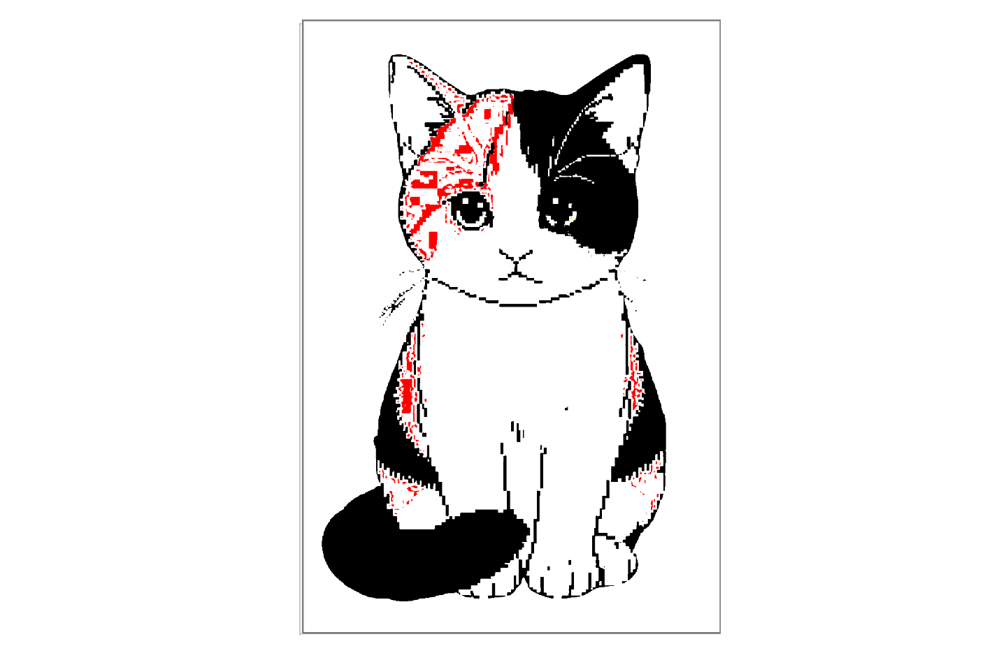

Step 1: Color Reduction (Quantization)
The first processing step is to reduce the number of colors
We need to go from 256 colors down to just 4. This process is called color quantization, and you can do it with any image editor. In this case, I used GIMP and a custom palette that matches the 4 colors available on the EPD.
The result can look a bit disappointing—there’s a clear loss of quality.
The quantization algorithm picks the closest color in the new palette for each original pixel, and sometimes the difference is noticeable.

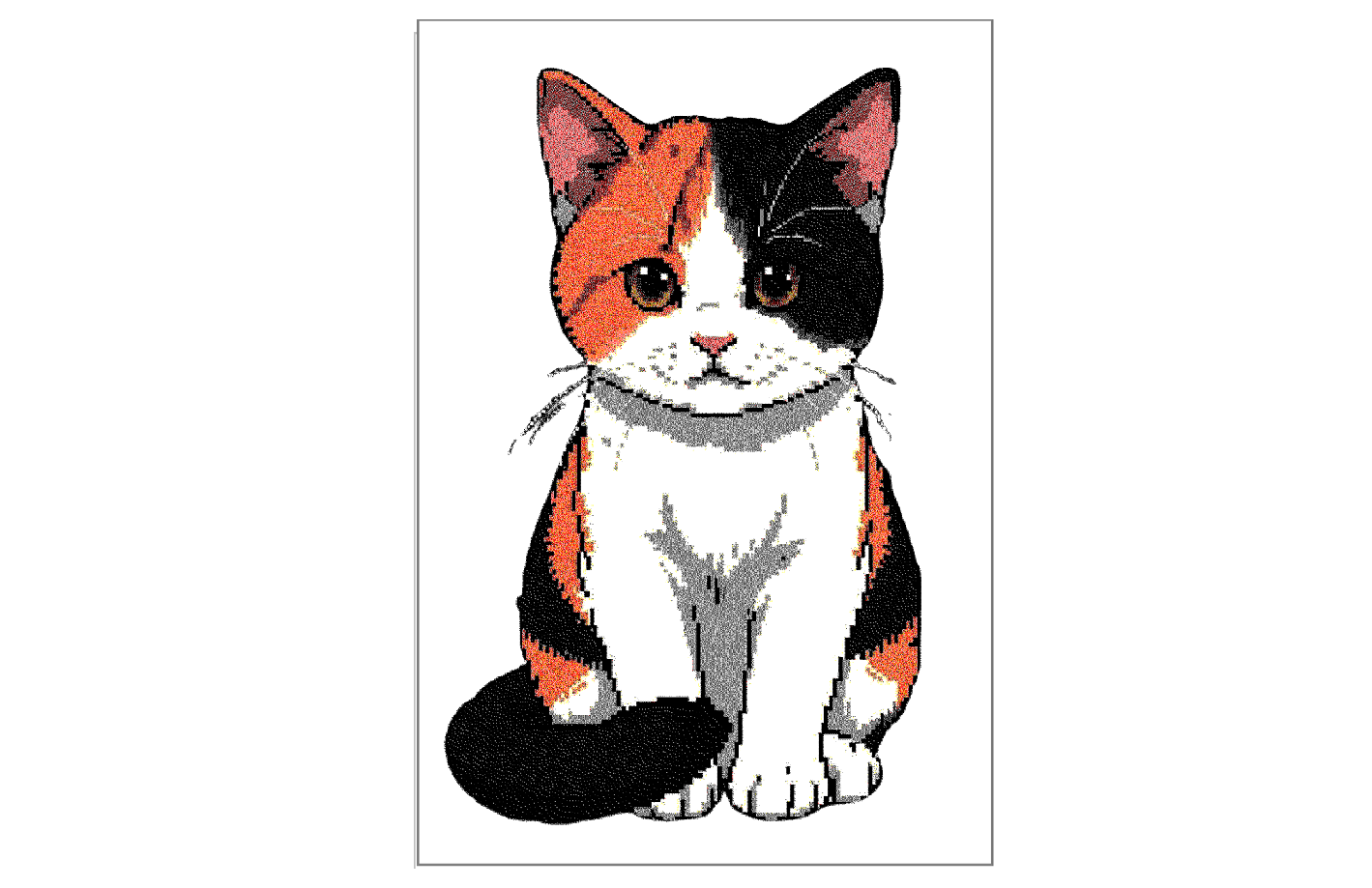

But don’t worry! There’s a trick you can try: dithering. Dithering “simulates” missing colors by mixing pixels of the available palette.
There are many dithering algorithms, and GIMP includes several. Here’s how the image looks using one called Floyd-Steinberg:
Much better, right? If you zoom in, you’ll notice some colors are made up of a combination of dots from the four base colors.

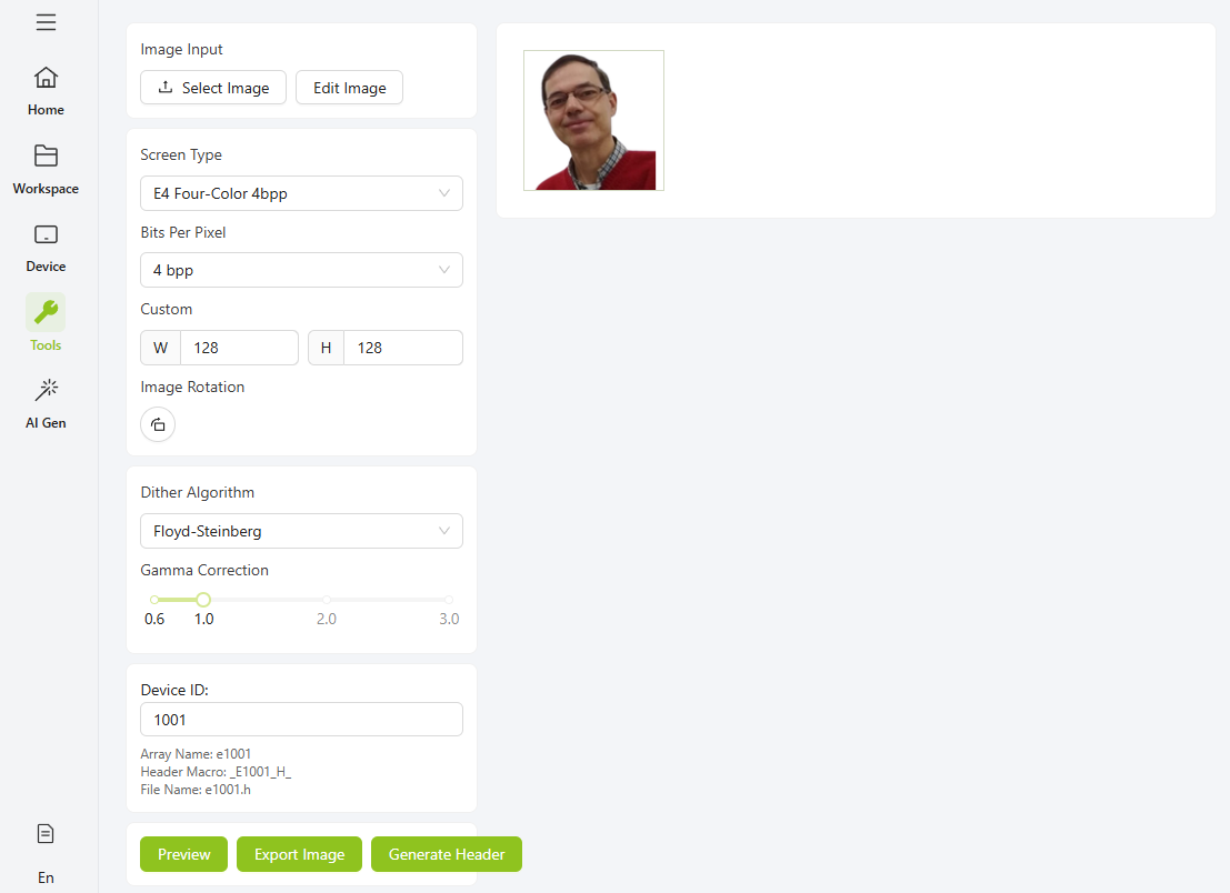

Step 3: Convert to a Byte Array
For this last step, if you enjoy programming and are up for a challenge, you can build your own tool—either by experimenting with AI and a bit of vibe coding, or by writing your own script in Python using the Pillow library, which is great for image processing.

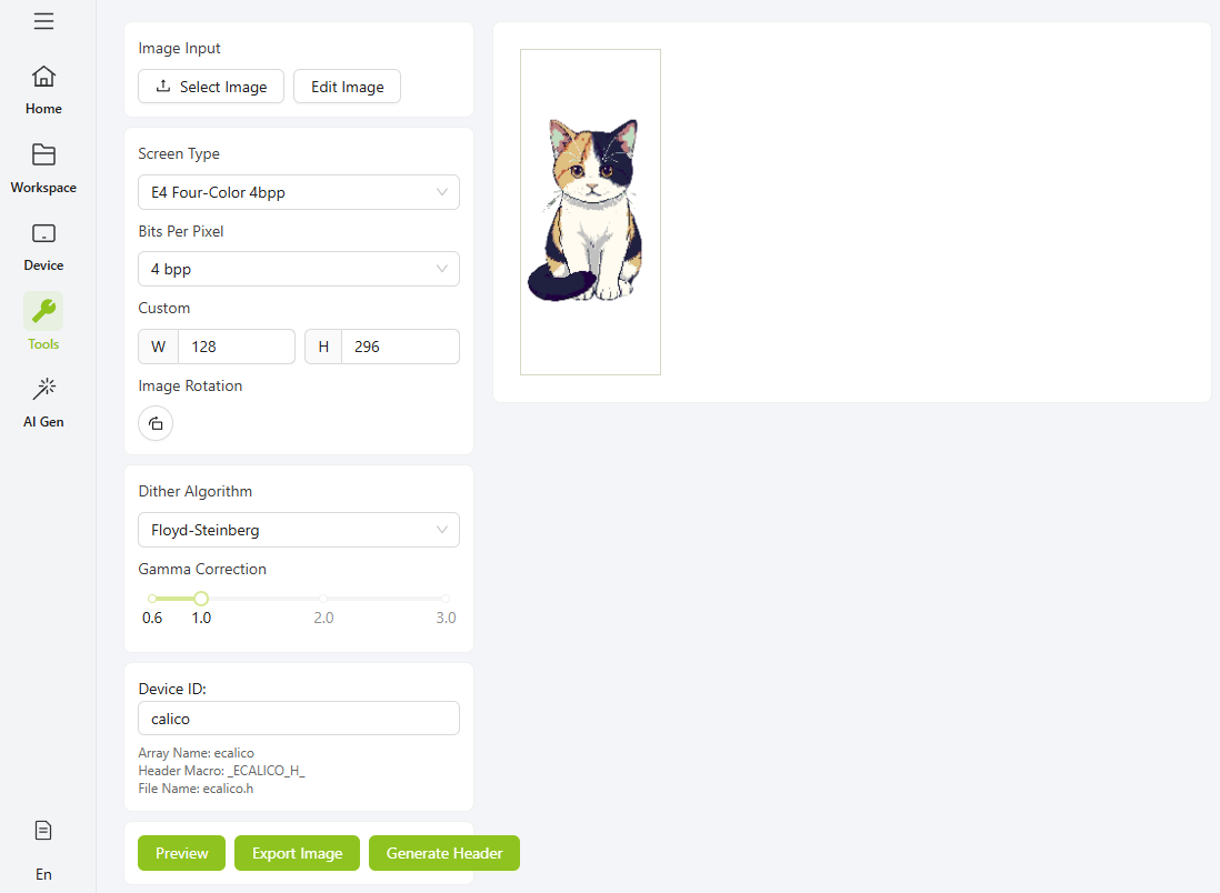

If you prefer something ready-to-use, Seeed Studio provides a fantastic online tool that does all of this in seconds. In fact, it can handle the full process: color quantization with dithering, resizing, and generating the array in the required format.
This tool is part of SenseCraft HMI, a free no-code solution for creating EPD applications: https://sensecraft.seeed.cc/hmi/tools/dither
To continue with this example, I opened SenseCraft HMI, uploaded the original image, and configured the tool with the settings shown in the screenshot below:
The selected display (Screen Type) is a four-color model, with a color depth of 4 bpp, and custom dimensions of 128 pixels wide by 296 pixels high. The chosen dithering method is Floyd-Steinberg, but you can experiment with any of the other available options.
Device ID is the name that will be used for the array containing the pixel data.
When you click the "Generate Header" button, the page creates a “.h” file with the array definition, which you can either copy to the clipboard or download.
Save that file in the same folder as your code and name it "image.h".
All that’s left to do is include that file in your code and call pushImage with the declared name of the array (the tool adds the letter “e” before the specified Device ID).

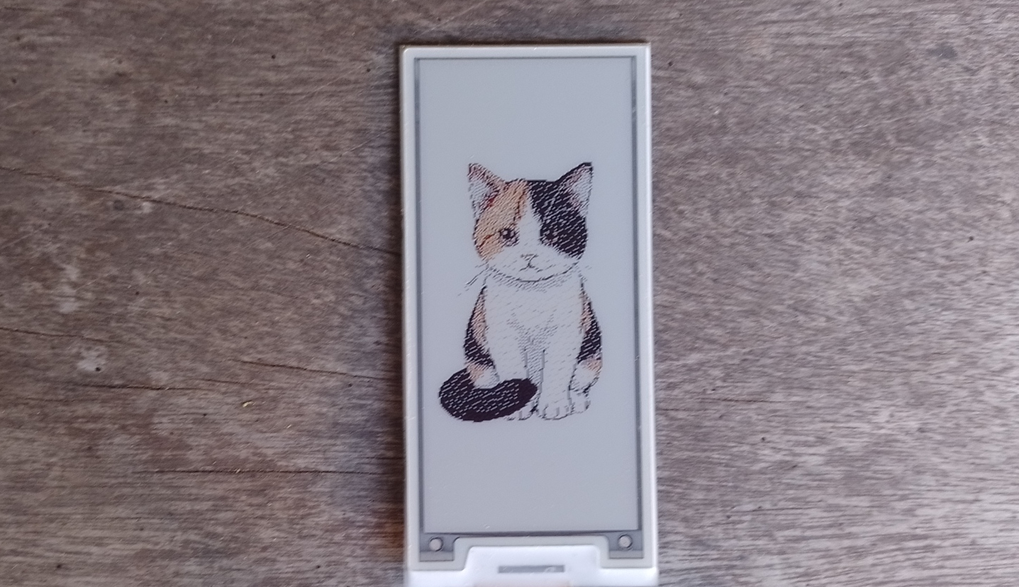

And here is the final result:
As you’ve seen, the original image went through several transformations that changed its appearance and quality quite a bit.

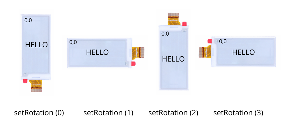

Screen Rotation
When displaying images—and especially text—it’s important to make sure the content appears in the desired orientation. For this, Seeed_GFX includes a function that allows you to rotate the EPD screen.
Rotating the display involves several internal adjustments: it changes the origin of the coordinate system, swaps or recalculates the width and height values, and redefines how pixels are mapped in memory. The ePaper panel’s controller chip is capable of making these changes at the hardware level, which simplifies orientation management in your code.
The function used to perform rotation is setRotation, and the following image shows the results obtained when it is called with different values:
If you’re displaying images, be careful with the width and height dimensions.
In portrait mode (modes 0 and 2), the full screen dimensions are 128 × 296 pixels, while in landscape mode (modes 1 and 3), the image is interpreted as 296 × 128 pixels.

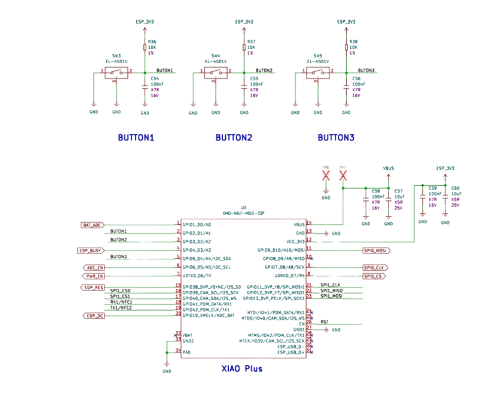

In the following image, you can see a fragment of the EE04 schematic. As shown, the buttons are connected to GPIO2, GPIO3, and GPIO5 of the XIAO module.
These inputs have pull-up resistors, and pressing a button drives the signal to a LOW level.
So all we need to do is configure those ESP32 GPIO pins as inputs and then monitor their state. When a pin reads LOW, it means the corresponding button has been pressed.

Using setRotate(3), the screen is set to landscape mode.
Then, the photo is loaded on the right side, and the conference title and speaker’s name are displayed. Of course, you can replace the photo and these texts with your own choices.
 // Display image
  epaper.pushImage(170, 0, 128, 128, (uint16_t *) e1001);

The final result can be seen in the image below. The photo quality is quite acceptable, especially considering the display only supports only four colors.
