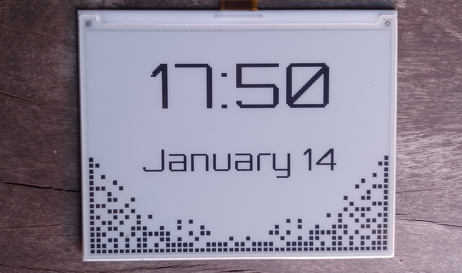

Putting It All Together
Now, let’s bring together all the parts we’ve covered so far: the NTP server, the RTC, and the bitmap.
Here’s what the first version of the Internet clock code looks like:

Let’s break down how it works:
At the top, you’ll see the required libraries: TFT_eSPI for controlling the EPD, WiFi for network access, time for RTC handling, and "bitmap.h" for your background image array.

During the EPD initialization, you’ll notice the screen is cleared and a large custom font is selected—the font definition can be found in the library’s Fonts\Custom folder.
The display is also rotated 180 degrees, and the text datum is set for proper text alignment.
The “datum” deserves a bit more explanation: it’s the reference point used to position text on the screen. There are actually twelve possible values you can use, as shown in the following image:
In our code, it’s set to MC_DATUM, which is especially useful for centering text on the screen.
The setup ends with the drawBitmap instruction, which loads the bitmap image (it won’t actually appear on the display until you call update).
 // Display background bitmap
 epaper.drawBitmap(0, 270, bottom, 648, 211, TFT_BLACK);
In the loop, the current time is read from the ESP32’s RTC using getLocalTime, and the current minute value is compared with the lastMinute variable. This check runs continuously to detect when the minute changes, so the display can be updated at the right interval.
When a new minute is detected, the current date and time are printed to the serial port for debugging, and the variables hour, minutes, dayMonth, and month are loaded from the RTC.
Then, lastMinute is updated and the new values are displayed on the EPD.

Before drawing the time—and again before drawing the date—a white rectangle is drawn in that area of the screen. This clears any previous text, so if the new text is shorter than before, you won’t see any leftover pixels on the sides.
Next, the text size is set with setTextSize(4), making the time appear in big, easy-to-read characters.
A string is then created using sprintf to format the time as "HH:MM", and it’s displayed horizontally centered on the EPD. The same process is repeated for the date: a slightly smaller text size is chosen, the old date is erased, and a string with the month name and day is shown.
Finally, update is called to send everything to the display. Here’s what the final result looks like:
